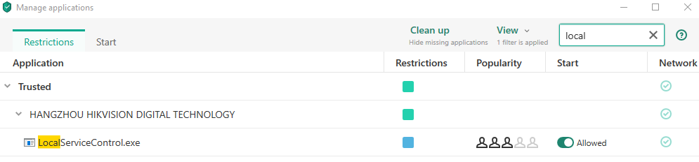

I see this when I search in Kaspersky.
Perhaps your using a different NVR or something?

Thank you for your kind answer. I am using Hikvision DS-7208HGHI-SH / A and using Internet Explorer, because on Chrome and Edge it is not possible, or just with modifications. If you mean WebComponents.exe as the small program, yes version 3.0.6.8. is installed. In Kaspersky search for local nothing found, for this reason I can not modify exclusions in order to playback.
Upvote 0
Have you searched on Webcomponents?
Or you could try searching HIK and see if a group comes up. If I search HIK, the group "HANGZHOU HIKVISION DIGITAL TECHNOLOGY" appears but I cannot expand what is under it. Clearing the search and then looking for the group in the list then shows me what is under it. You might find something for webcomponents.
If not, then afraid I cannot help you anymore as I don't use your model of NVR, Internet Explorer or WebComponents.exe. By the fact you are having the same issue means there must be something under those Kasperskey settings that can be amended.
