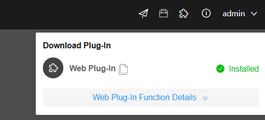

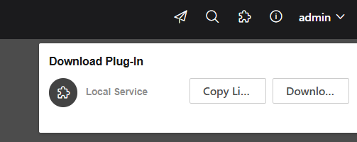

I don't think it had any significance, but I did delete "Cached images and files" in Edge before I tried reloading "Local Service Control" and "Web Plugin Components".
Intrigued that you are still loading Local Service Control. I thought it had been replaced by Web Plugin Components and haven't installed it since that was introduced a while ago.
You are probably correct... I'm not sure! My cameras seem to download "Local Service Control"... in the browser GUI...
My NVR downloads "Web Plugin Components":

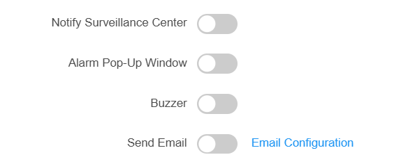

Does camera detection go full screen for a certain amount of seconds as per GUIv4. Perfect use case for a camera at a front door, someone knocks at the door, camera detects, and the monitor goes full screen so you can see exactly who is there,
Still not, but there is the alarm pop up window... not as good functionality as V4 "full screen":

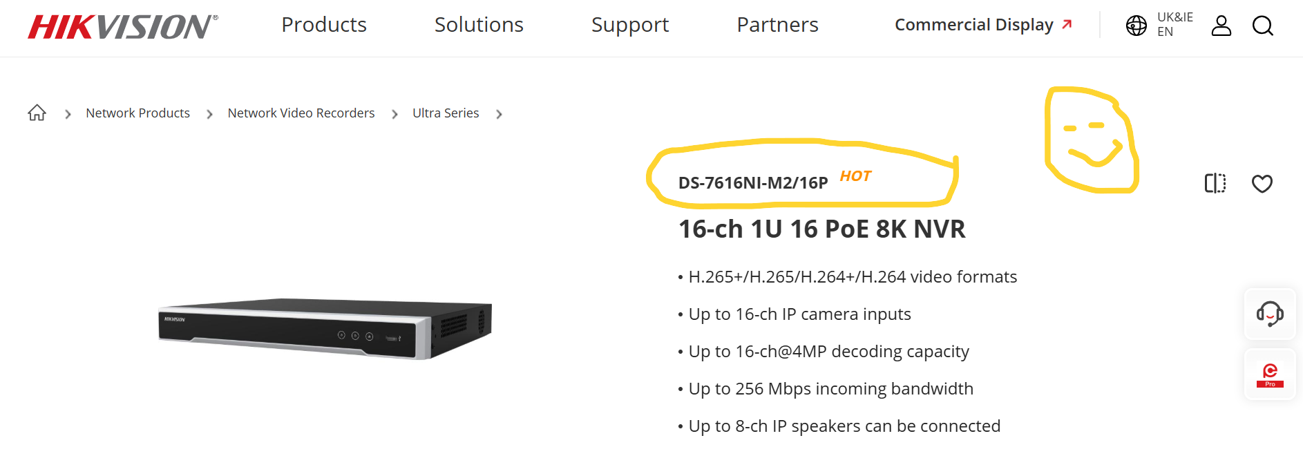

The DS-76xxNI-M2 series NVR product pages no longer show the latest firmware... I suspect we have seen the last firmware updates for these :(
So much for "HOT" :)
Maybe, maybe not. Who knows with Hikvision. I did notice a couple of weeks ago that all links for the DS-76xxNI-M2 were gone from the UK, EU, and Global firmware search pages which is strange. However I've noticed that happen with some camera models previously too, only to re appear.
Mine got eBayed and I replaced with the I2-VPro. I've had that model several months now and have never yet seen firmware in either the firmware search area or the product pages - I have to regularly do a serial number search on HPP to find new versions.

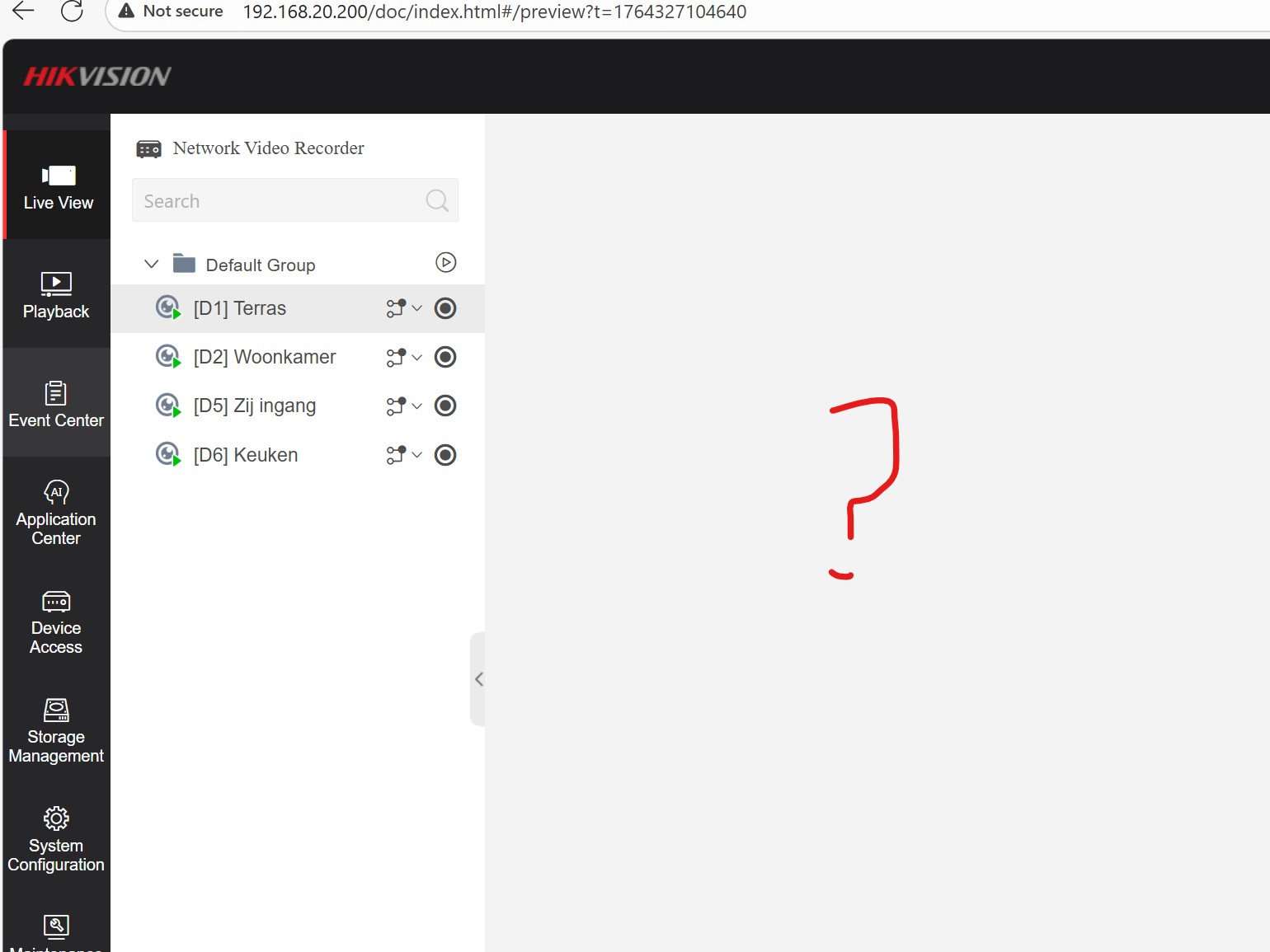

Did anyone resolved the issue with Edge where the live view page shows blank unless double clicked on it?
I have been playing with this recently - if I uninstall any hikvision browser plugins and then change the streams to "sub streams". Then I select grid view and finally click the play / triangle button at the bottom of the screen. Then all my cameras play live feed in edge OK fine.
Might be that you need to update your LocalService Components / Webplugin depending in what you use. But they are not compatible with each other. More than likely Local Service Components is what you need. Latest version can be found on Hikvision site - HiTools
Uninstall any previous version prior to installing new version.
