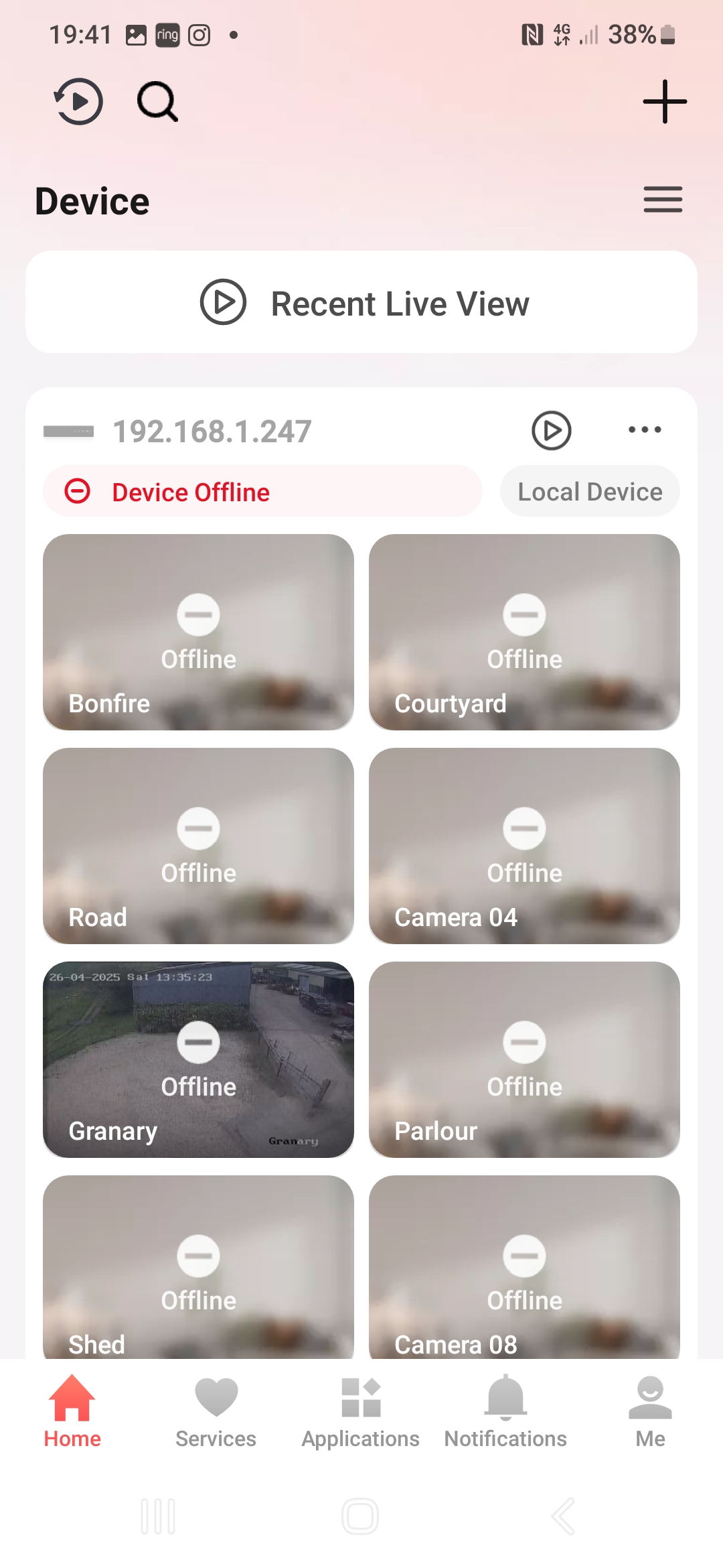

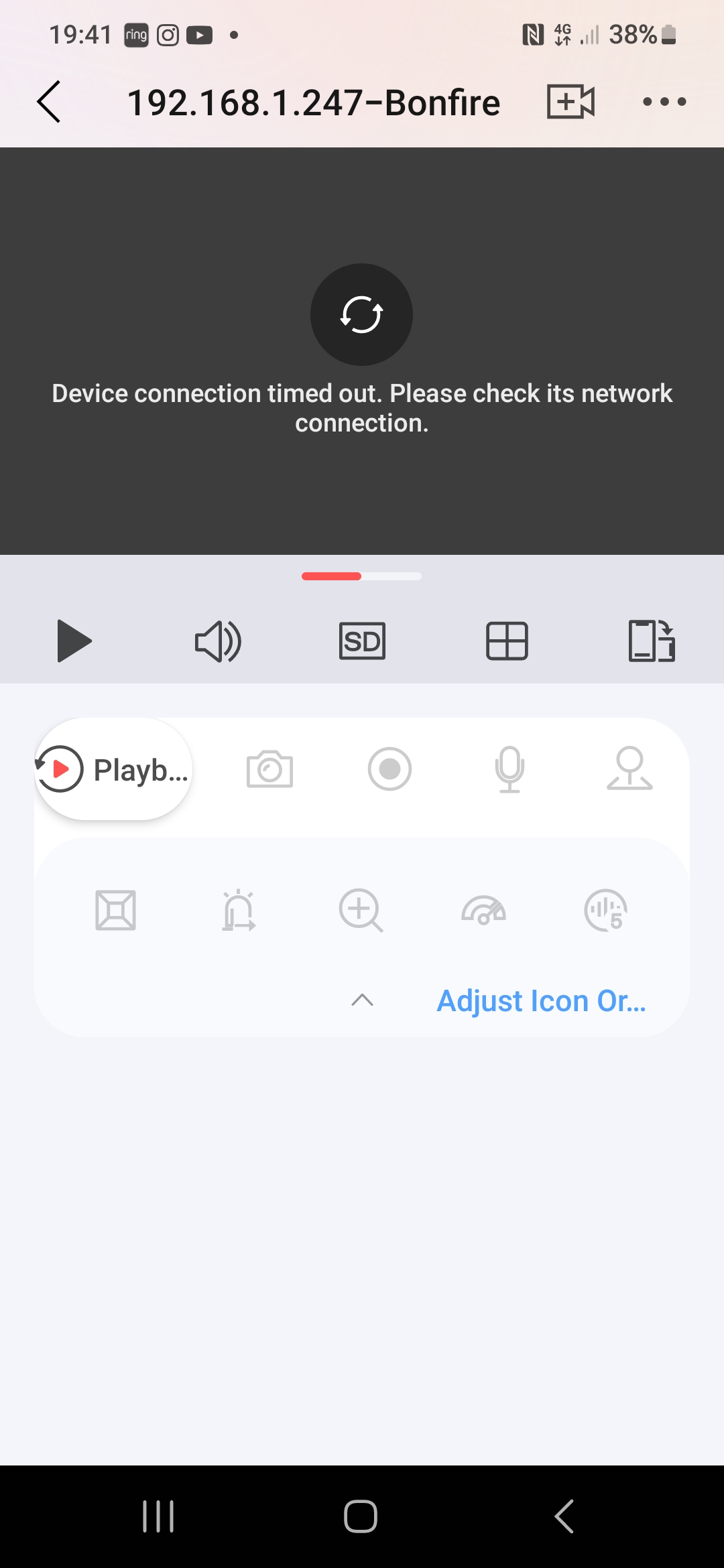

I changed that on the DVR, but sadly no joy on the phone - see pics

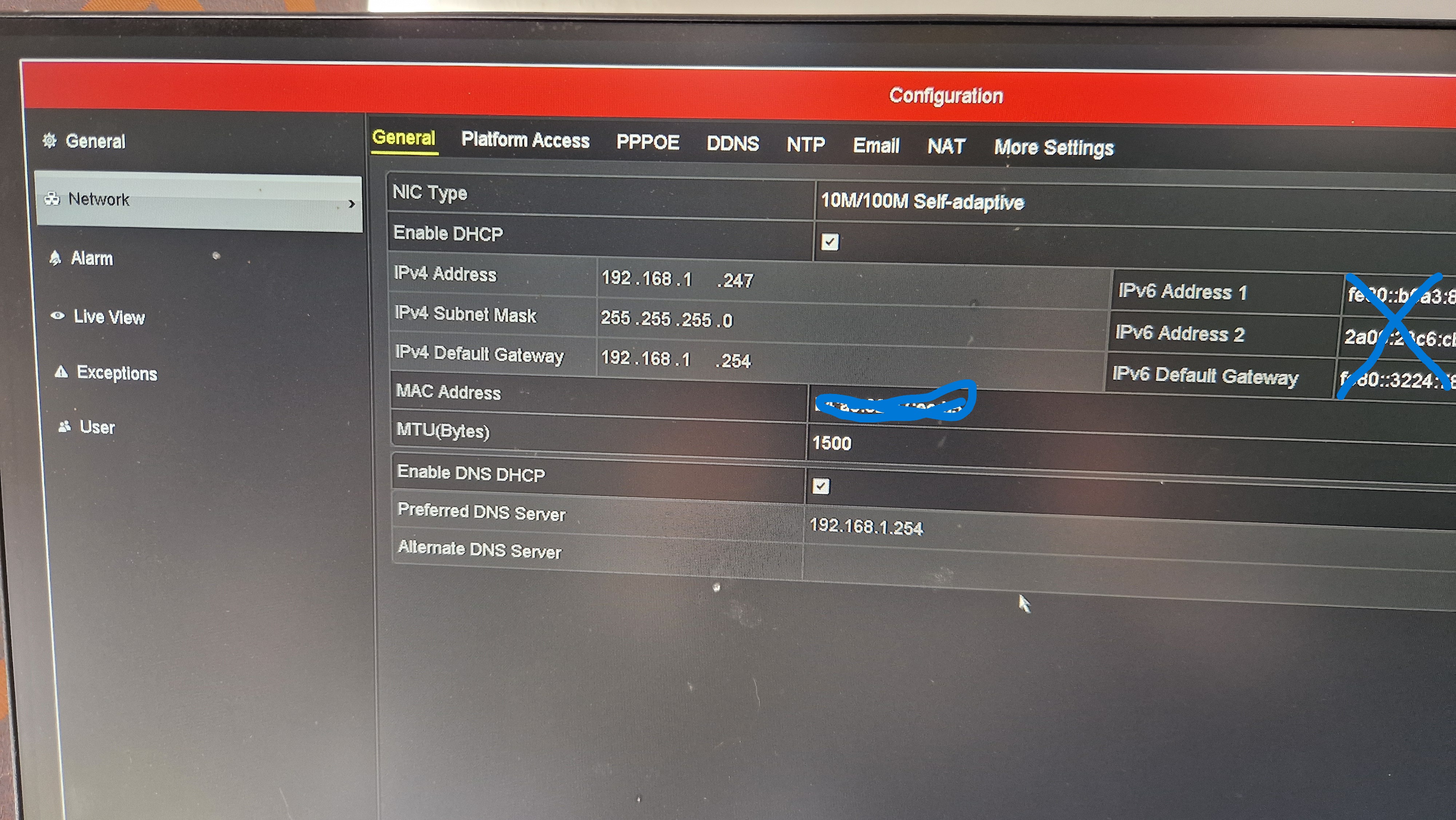

Where do I go to change the primary and secondary DNS ?

This should be OK with your Gateway 192.168.1.254 as Preferred but you can also try Google's 8.8.8.8 and as Alternate the 8.8.4.4
I suppose that Enable DNS DHCP means Auto DNS which uses automaticaly your Gateway IP, so you have to disable, apply and then add 8.8.8.8 and 8.8.4.4

From what I can see you have your DVR added as a local device via IP address (local device). You won't be able to connect outside your home using that setup regardless of whether the DVR is connected to Hik-Connect or not. You need to log in to your Hik-Connect account on the app and add the DVR to your Hik-Connect account if you haven't already. Then it will be available regardless of where you are. The existing 'local' connection that works on WiFi can just be renamed to 'Backup' as it'll only ever work when you're on your local network.

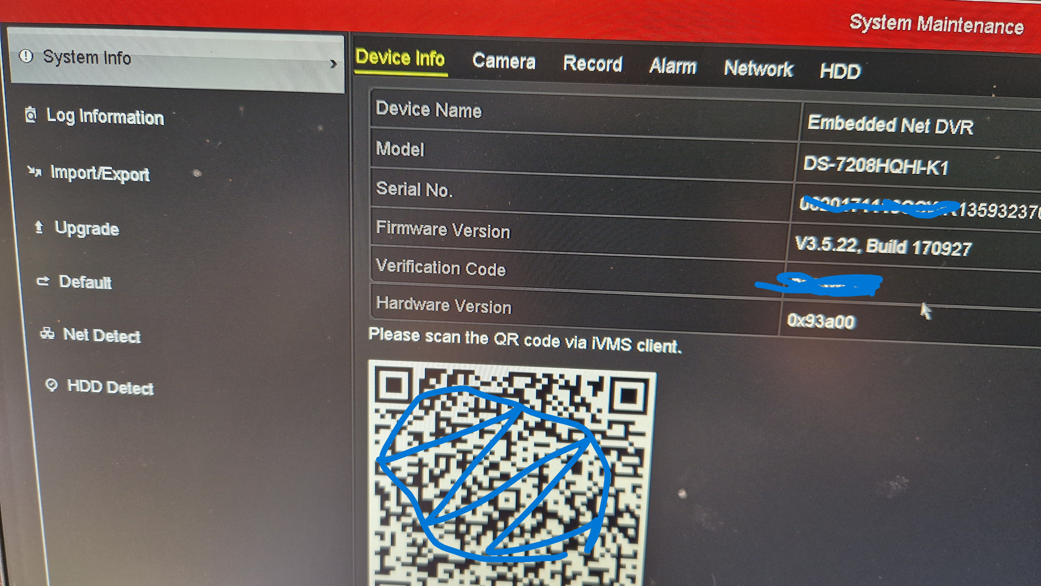

On first picture posted, this seems Online, but possibly happens what you say with the app.
Yes it will always show online in the DVR UI so long as there's a valid internet connection, the server address is valid, and the enable box is checked. As it's V3 UI though, there's no indication that the device is bound to a Hik-Connect account (unlike in V4 and V5 where it shows both the online and bind status). Where he's shown the screen grab of the phone app it shows 'local device' and is shown with the LAN address so either the app is not logged in to the users cloud account, or the device is not bound to the cloud account (or both)
