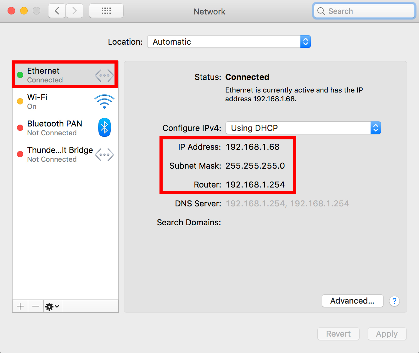

When you connect your Mac to the router that the NVR is connected to and you then go through the steps to identify the router address that Phil linked you to before, can you please email us ([email protected]) a screenshot of the IP address & Gateway address you see in the network settings. (like the below example)

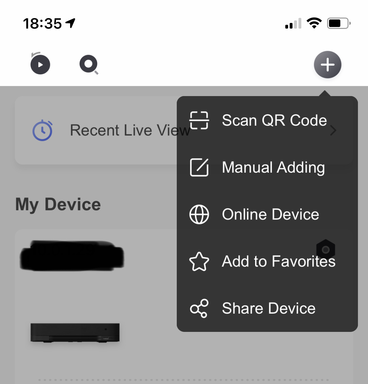

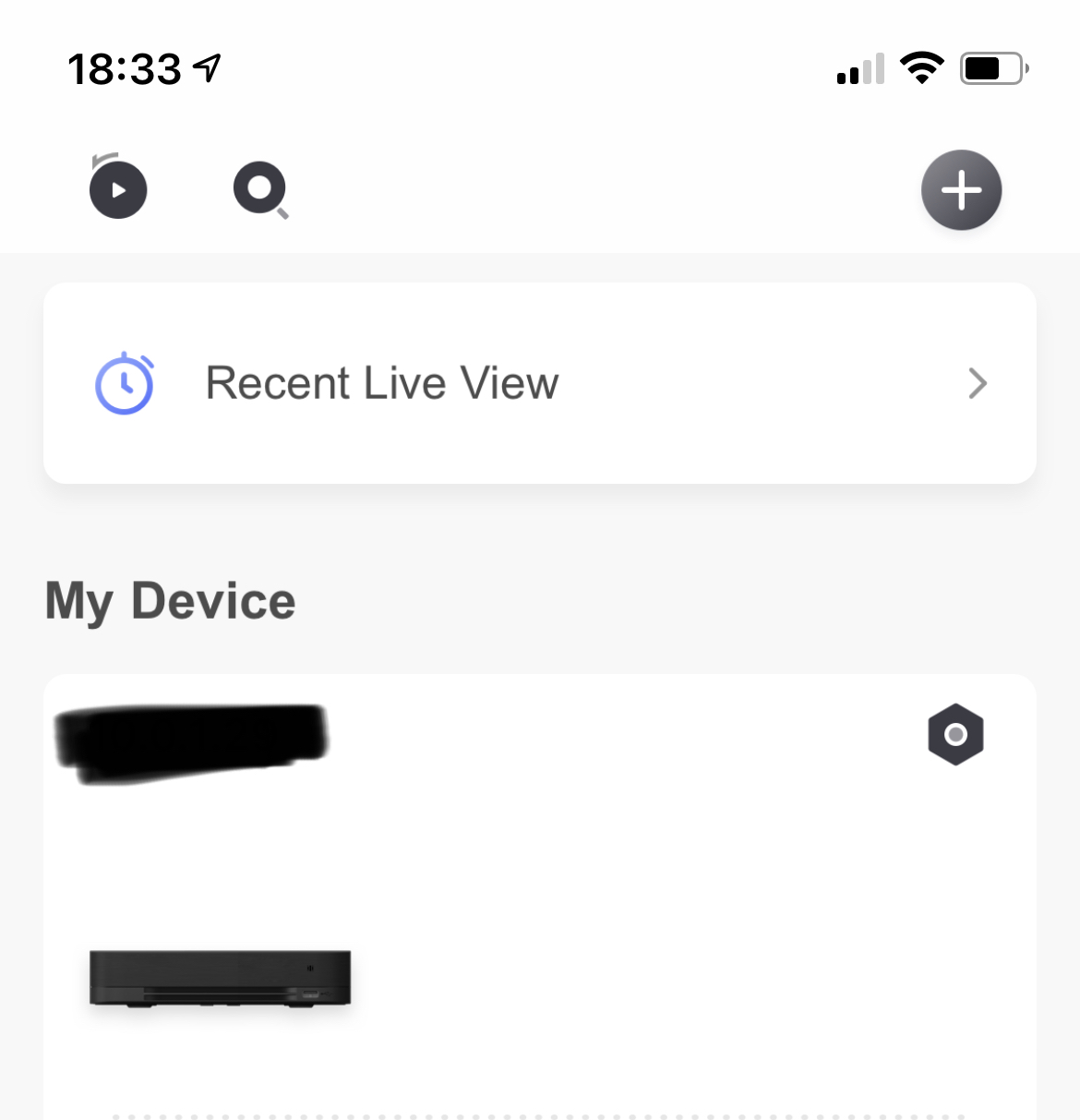

Also, make sure you’re using the latest version of Hik-Connect on your iPhone. The + symbol should be top right of the screen which brings up a menu of different options
Menu as seen in pic once you press the plus/add symbol
