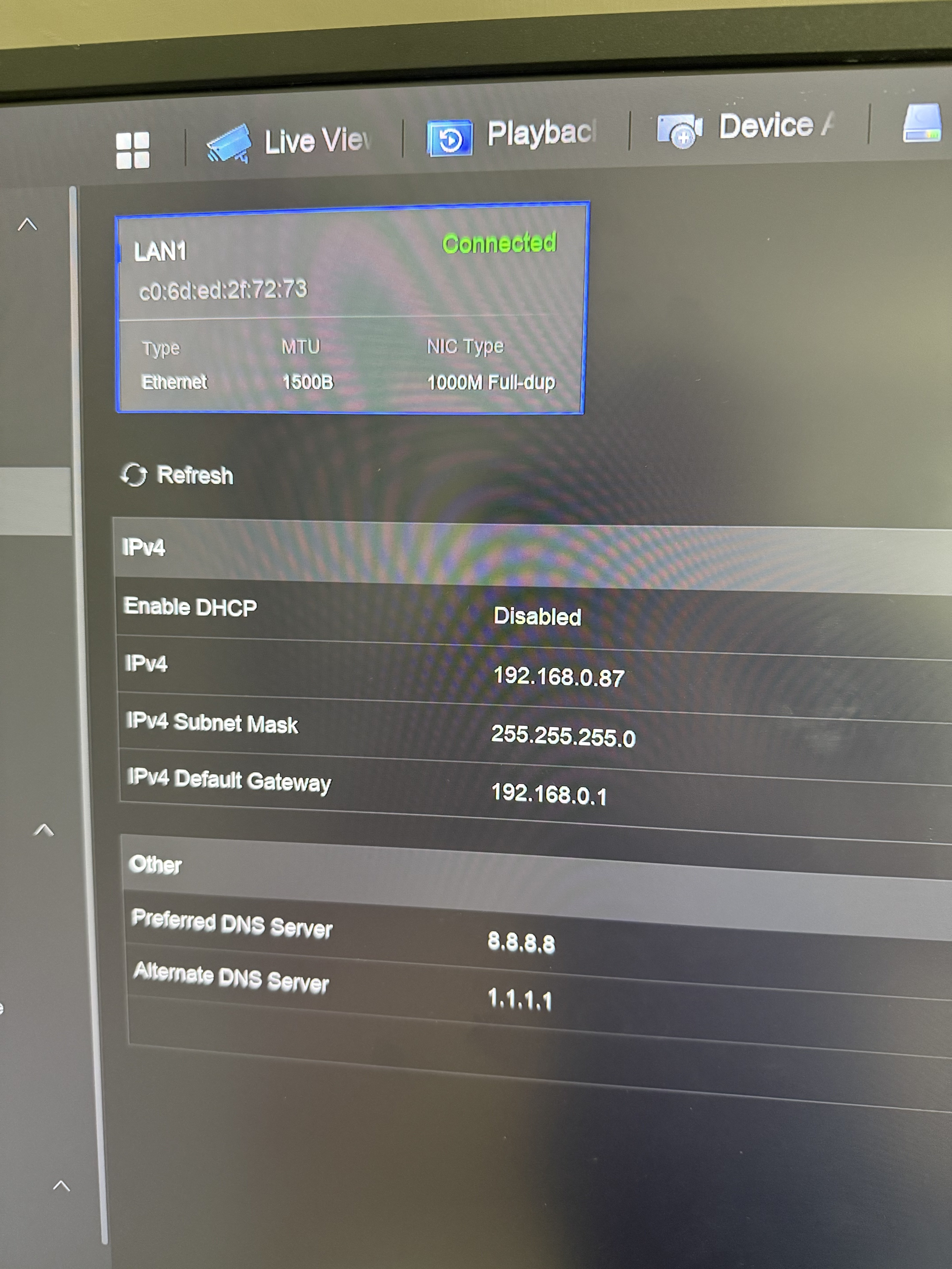

Need help updating cams and nvr

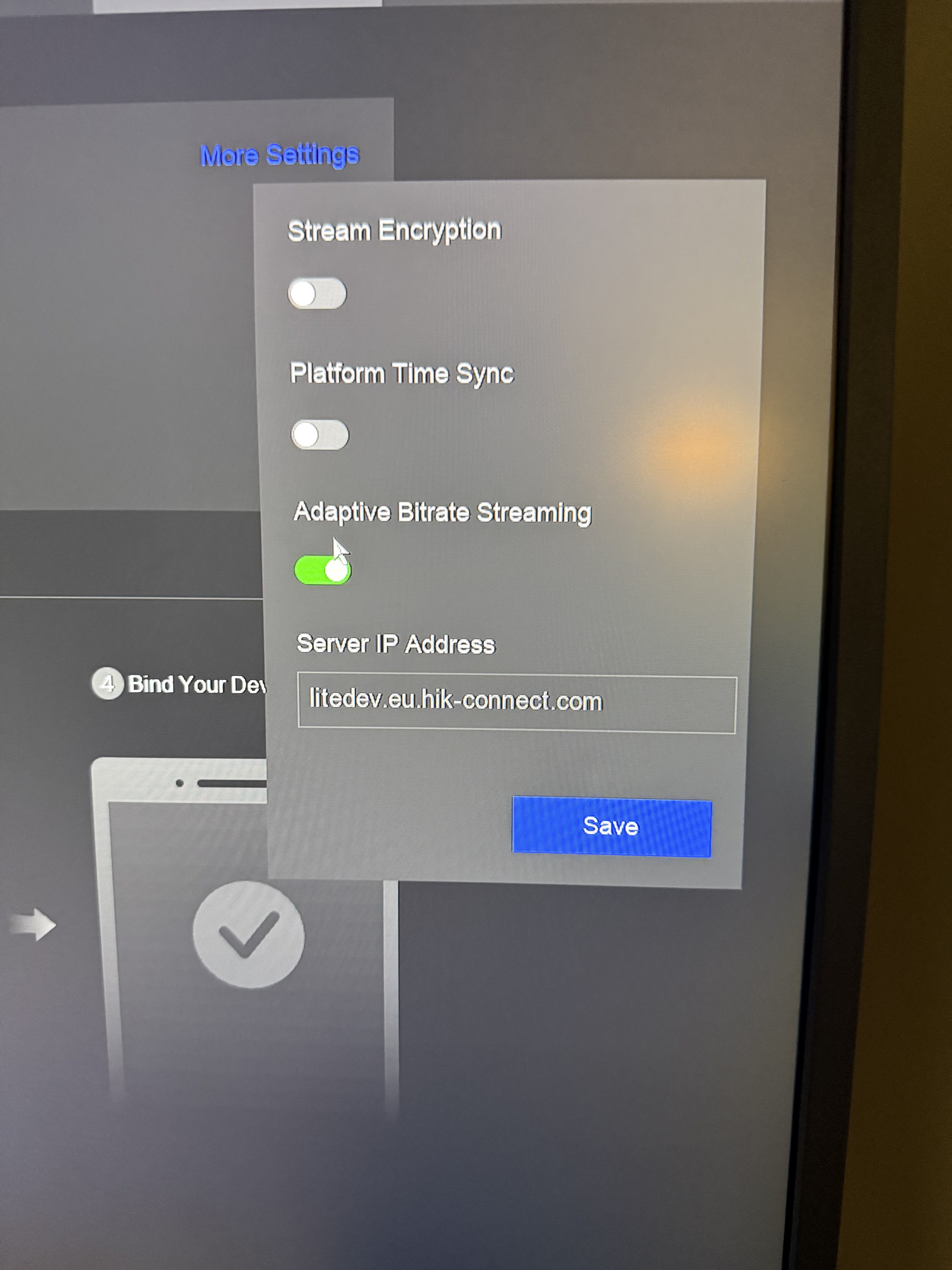

Additionally. In the NVR go to:
System Settings > Network > Hik-Connect > More Settings (top right)
In the pop up ensure Stream Encryption is off and also Adaptive Bitrate Streaming should be off.

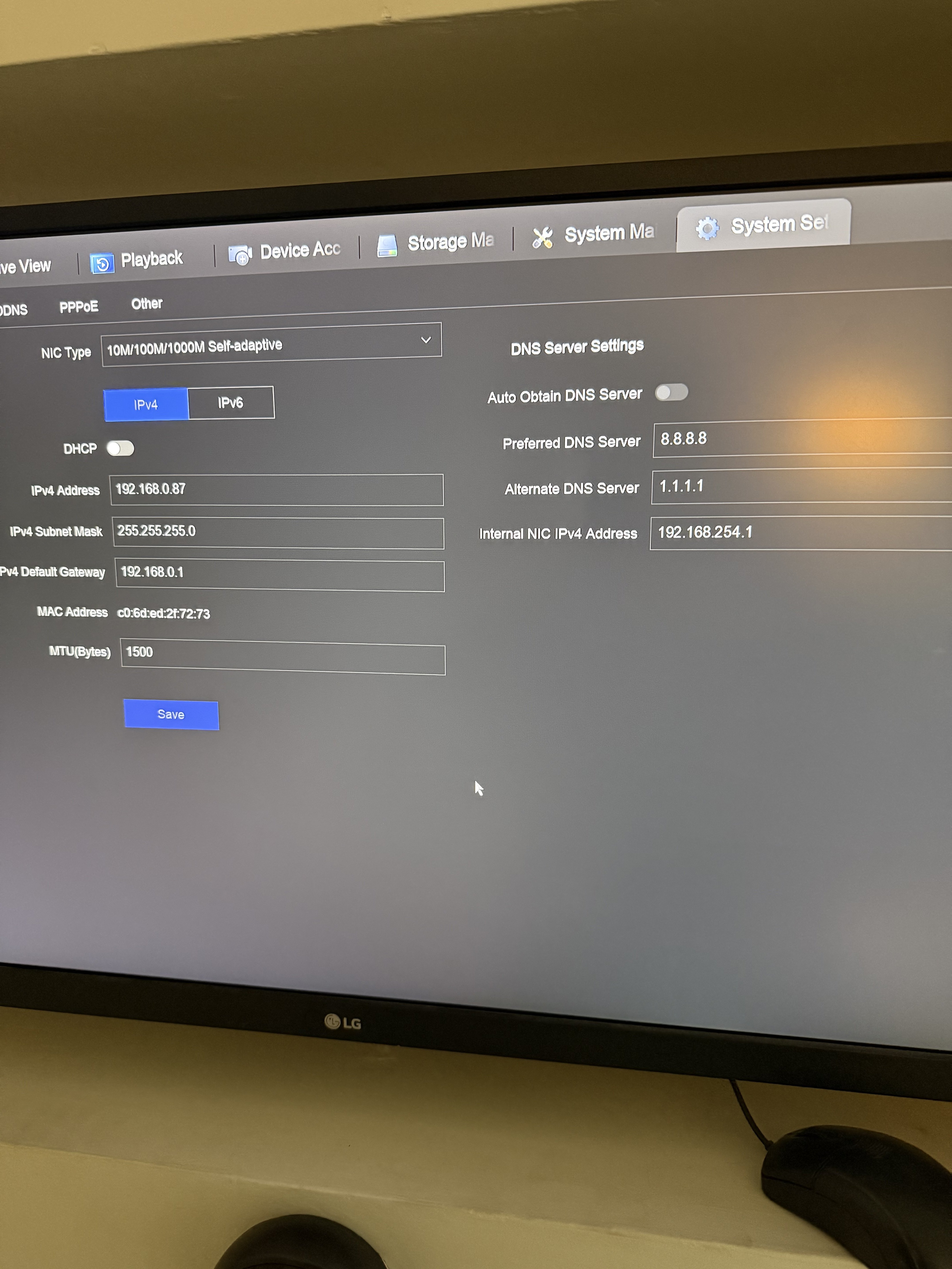

Did everything u said mate that 1 adaptive was on so turned it off. Reset everything even deleted app again still not sorted. Strange init, if helps what we notice if we watch live view on phone we can see postman at the door on live view but on the monitor he is out gate getting in his van lol.

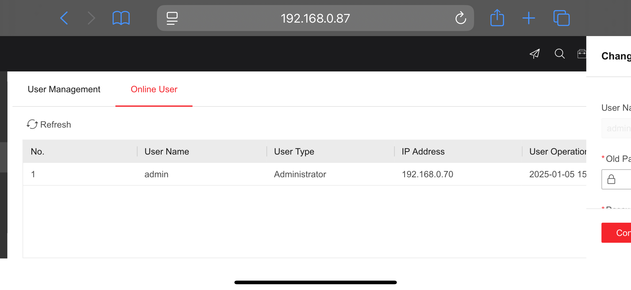

Just noticed on the web portal it shows a different ip address for online
The Ip address shown is simply a device you are or have recently been logged in from using a web browser (rather than the NVR IP address) so forget about that.
In your first photo...go back to that screen and turn ON 'platform time sync'. That will ensure that your NVR time is synchronised with Hik-Connect. Your phone and Hik-Connect app need to be at the same time as the NVR and cameras.
Ye just done that now mate, still same but I think it’s summit to do with WiFi online thing that can make summit slow is poor WiFi. But done WiFi test and it’s good as always head is burnt

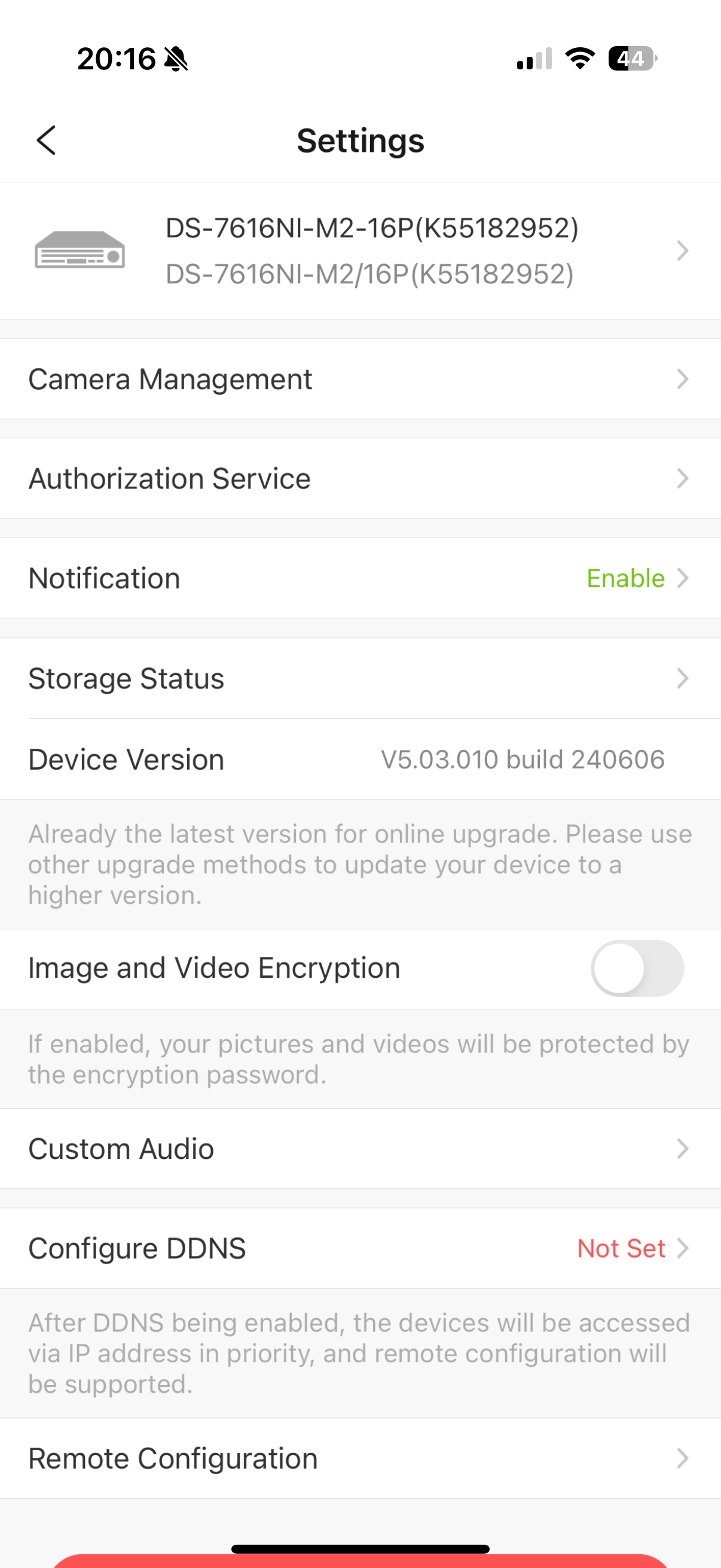

Only just noticed on the hik app iam not getting any motion notifications. Last notification was 3ish today just after I changed the settings up there…. It’s still recording and can see motion in green on playback but not getting nothing on the notification
Noticed app ddns isn’t on?
Same mate when on 4 or 5g still just loads.
Ye local switch is on.
Just sorted that it was the adaptive streaming switch I had to switch that back on to get the event notifications back on mate

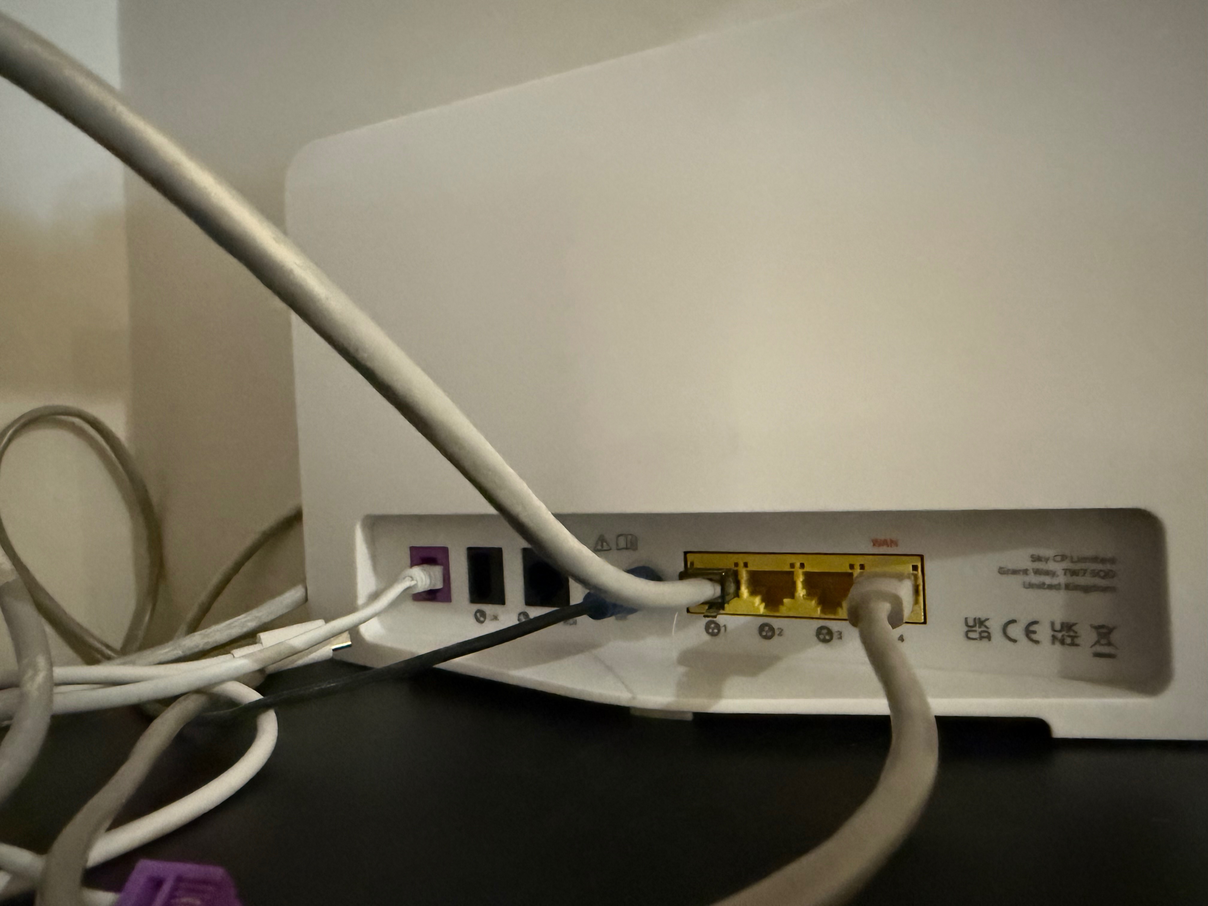

Sorry just 1 last thing. I have a feeling it’s something to do with the hub. As the only 2 things that’s connected via lan is the nvr and my sons ps5. And he said his running slow for ages now! Just looked at the back of the sky hub max and here is no data lights flashing at all. Iam sure there was always lights flashing. it shows is connected and signal and it does work but no data lights

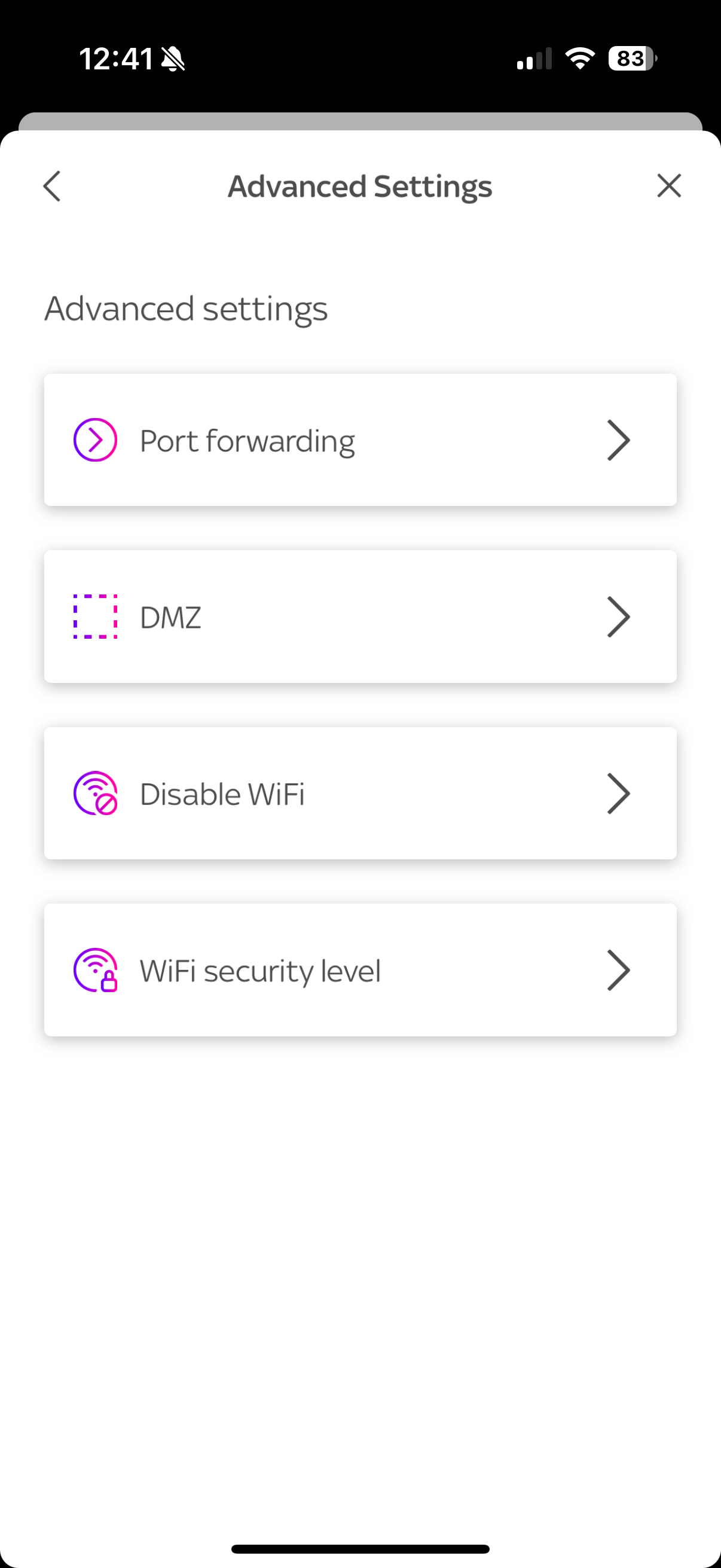

Have you checked the Firewall settings on your router?
Is this the Default or something like Medium or High?
Are there any Parental Control Rules?
Just checked then mate, no firewall settings no parent control settings either: haven’t set anything up yet on this router. But it’s always worked before… is it normal for them data lights not to flash u no? I may contact sky and ask them but they will see everting is connected and working from there side

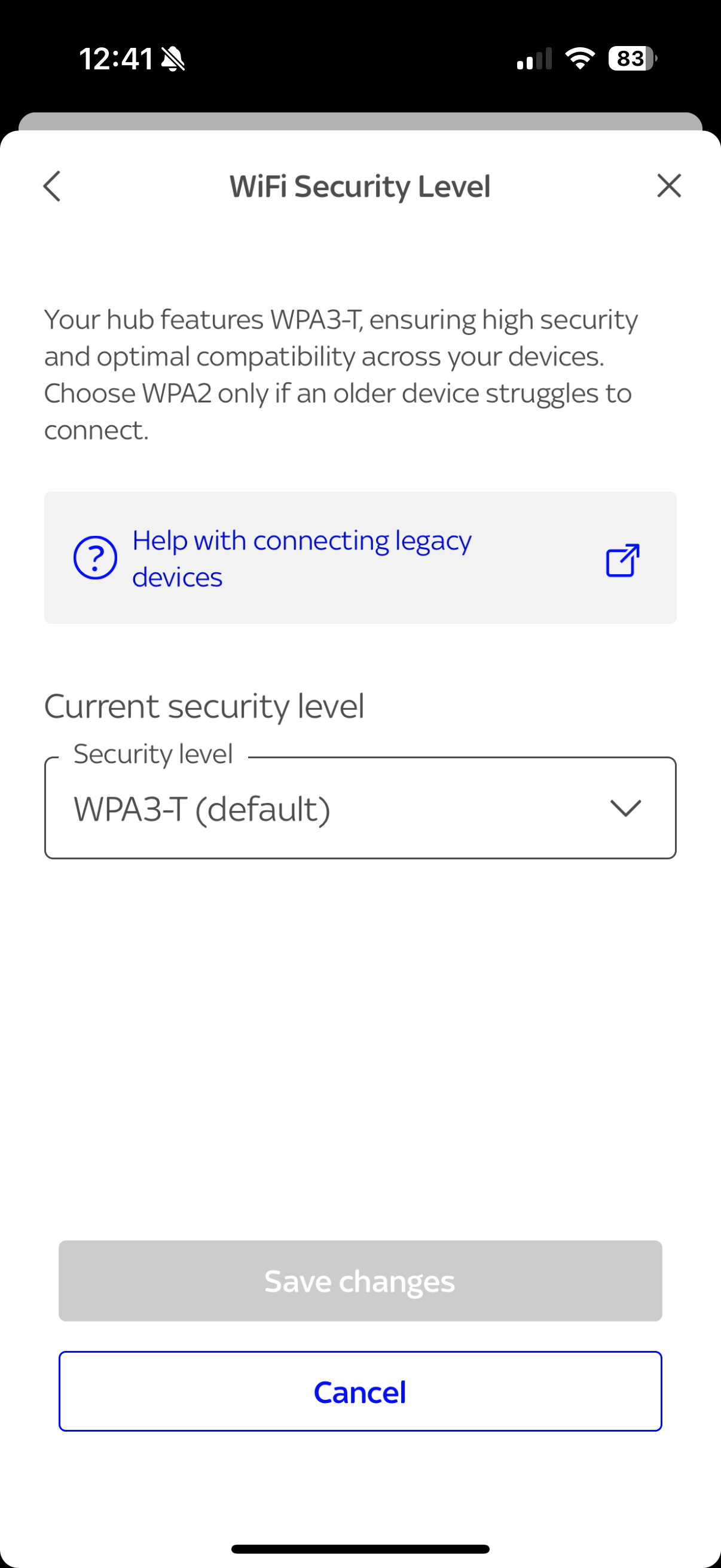

Only setting there is
Cannot understand why WPA3 is the default

Just been on phone ti sky. Did all checks everything is fine: did a speed test with the ps5 connected directly into the hub and it’s perfect. I mentioned the data lights they said ignore it as it shows it’s connected and working very well arrrrr man think will just let it be
I mentioned my problem with the hik and he mentioned ip address like that’s where the problem might be or it’s the app itself.
