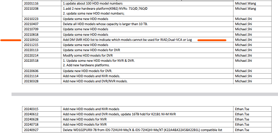

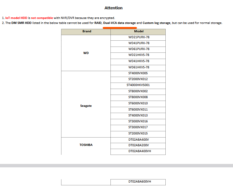

I hope this does not affect our disks too on newer G5 firmwares:
I also found this:

I also found this:

Where did that info come from - camera or NVR release notes? It's not very clear. Point 2 refers to the table and listed models so that's fine. Point 1 "IoT model HDD not compatible" - how are we defining an"IoT model" without model codes. In my own NVR I have two Seagate Surveillance/Skyhawk drives. One is a standard ST4000VX007 (not the 013 in the table); the other is a ST10000VE0008 model which is one of the AI versions. Search "IoT HDD" on Google and all I found was a Hikvision document for their own drives.
The hard drive compatibility is so specific. I've bought a stack of Seagate Surveillance drives over the years and as an example the 4TB version will always have a part code starting ST4000VX--- but there's a good chance that they will be different. I have the 007 in my system, the 005 and 013 (which will be visually identical) are in the non compatible list.
I am on SSDs and starting to be suspicious... :-) :-) :-)
I can see that I've installed at least one drive on an installation thats in the incompatible list...and that is a 4TB Seagate Surveillance model which would be expected to be compatible and recommended. The issue is that the compatible list is always out of date.
To put this all into context:
1 - If you have one of the disks in the table at the start of the document (that you posted) it will not work correctly with Dual VCA in ANY model.
2 - If the disk you have in your NVR/DVR is listed in the relevant section for your NVR/DVR model it is compatible and has been tested by Hikvision.
3 - If the disk you have in your NVR/DVR is NOT listed in the relevant section for your NVR/DVR model, it doesn't necessarily mean that it's incompatible. Neither of my disks are listed for my model and I've had no issues whatsoever.

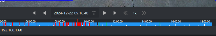

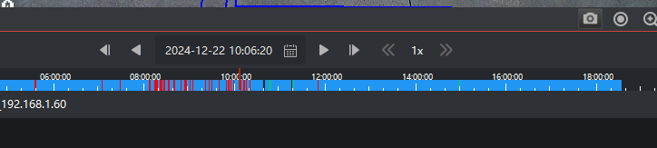

Prior to update, Human and Vehicle were enabled, after update H and V were disabled so that to have all events "Other" than Human.
  • This is Motion VCA search(by Rule) before(v5.7.15) and after(v5.7.19) update. There are no Motion after 10:35am. Not even the Human at 11:48am

Is this playback on the camera or the nvr?
@alfaclvi has done most testing with these issues. It affects the searching on an NVR for VCA - searching by rule/Smart search, or enabling dual VCA search. It has no effect on events configured in the camera, it's when you're searching for something retrospectively by drawing a line or grid on screen (which should include all motion regardless of whether the Human/Vehicle filters are set in the camera event setup). The issue seems to be that the camera either no longer sends the event metadata or it's not compliant in some way with the searching - no results are found.
