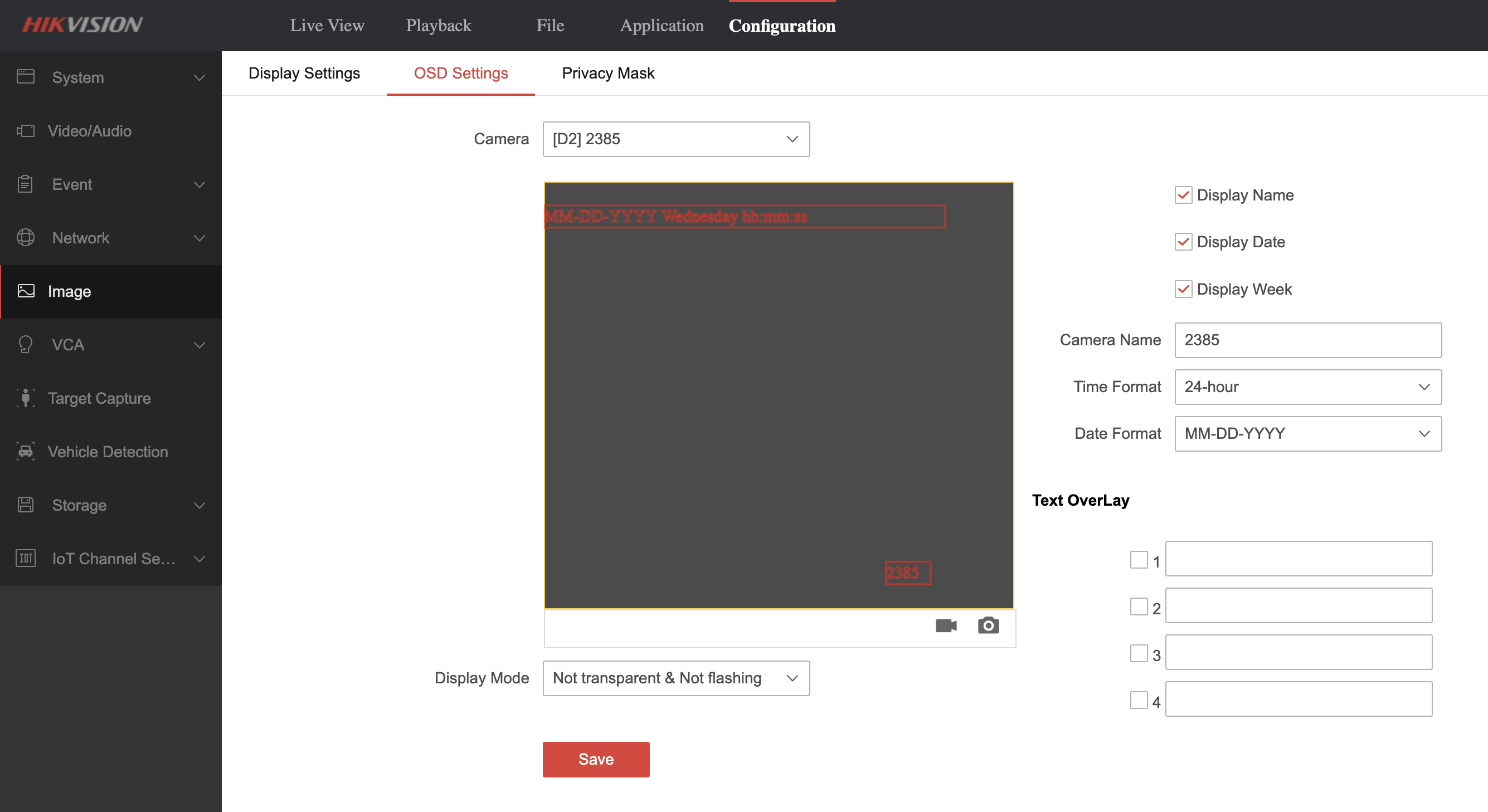

Hi @Mark Simpson
If you login to the NVR and go to Configuration > Image > OSD Settings you should have the option to change the 'Camera Name', see below:
But this will probably only change the name displayed in the device list, on the live streams, and on recorded footage from the point you save the changes.
I don't believe it will change the camera names in already recorded footage.

Thanks Dan
Yeah.. the current camera names are correct.. it's just when you go back before the rebuild that none of the names tally.
I've just been through them all on old footage and made a note of the real camera names for staff that need to view that footage.
