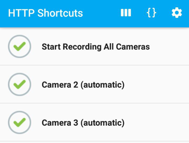

If you haven’t already, setup the shortcuts for the other cameras.

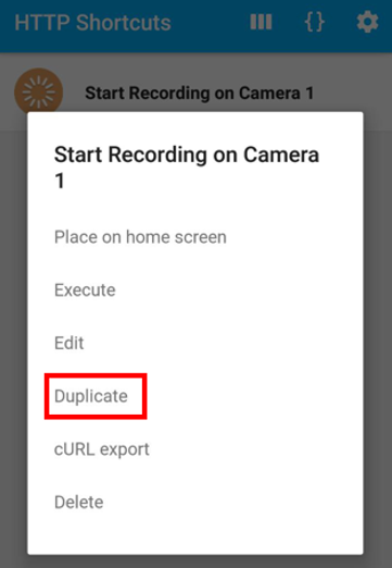

Duplicate the Start Recording on Camera 1 shortcut by pressing and holding it the until a menu appears:
Select Duplicate.
2404
A duplicate shortcut will appear marked as (copy).

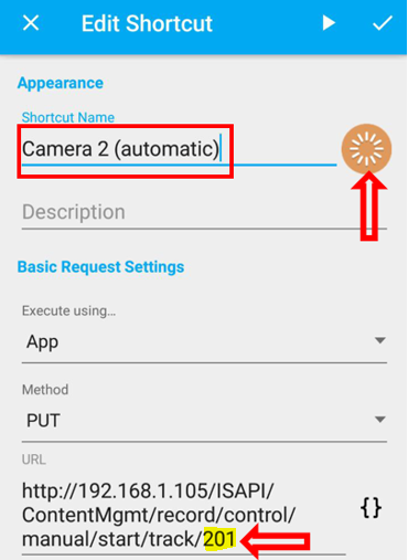

Press and hold the new shortcut until the menu appears and select Edit.

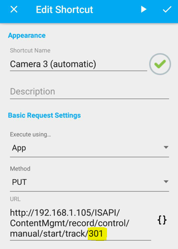

Amend the shortcut name to Camera 2 (automatic) or similar to let the user know they don't need to run it.
You must amend the URL to 201 (or the channel the camera is on).
All the other settings remain the same.

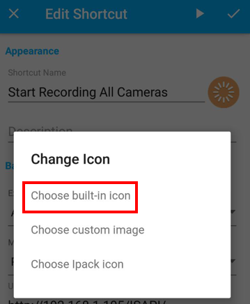

You can change the look of the icon to something more suitable, a green tick for example.
Press the icon at the end of the name field to edit it. Press Choose built-in icon.
2406
2407
Click the tick icon to save.
Then duplicate the Camera 2 (automatic) shortcut. Edit the new shortcut and repeat the steps for the third camera. Remember to amend the URL to 301.

After saving the new shortcut your main menu should look similar to this (less the Stop Recording shortcuts):

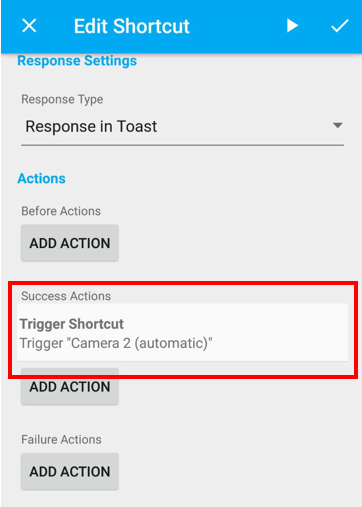

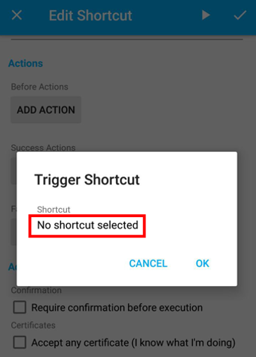

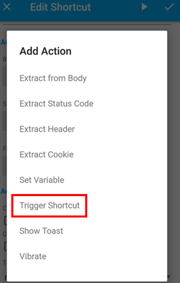

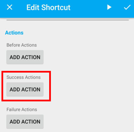

To enable the start record/stop recording automation with a single press, you need to create an action on the successful completion of the requests.
Press and hold the Start Recording All Cameras shortcut and select edit from the menu.
Scroll down to Success Actions and press ADD ACTION
2421
Select Trigger Shortcut
2422

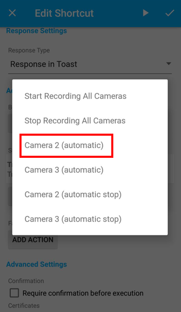

Press the 'No shortcut selected' text for at least 3 seconds to open the next menu.
2424
Select Camera 2 (automatic)
2425
The action should now appear as seen below:
2426
Save the edit.
From the main menu edit the Camera 2 (automatic) shortcut with the same steps above, BUT for the Success Action, the Trigger Shortcut must point to Camera 3 (automatic). Essentially you are setting up a cascade. If camera one successfully starts recording then initialize camera 2. If camera 2 successfully starts recording then initialize camera 3.

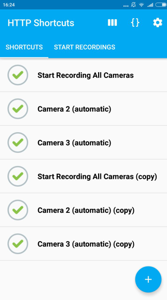

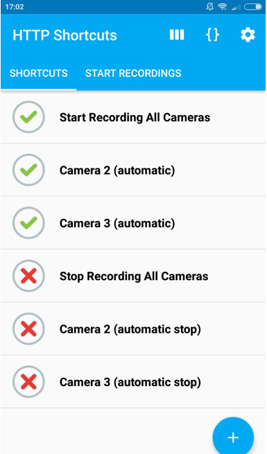

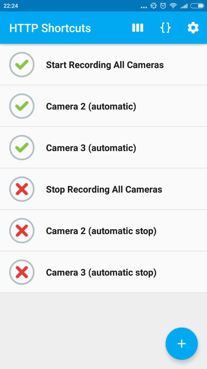

I believe the easiest way is to duplicate the existing shortcuts. Press and hold each shortcut and select duplicate from the menu. Using the same process, use the Move option to arrange them in the right order. Similar to this:

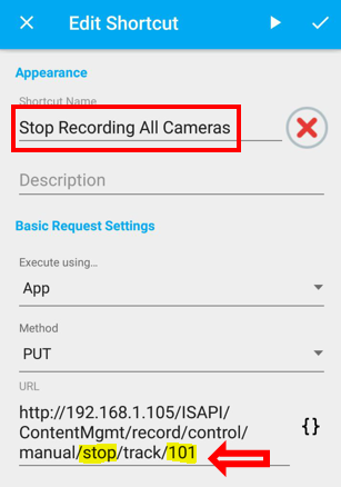

Next, press and hold Start Recording All Cameras (copy) and choose edit from the menu.
Rename the shortcut to: Stop Recording All Cameras.
Chose a different icon by pressing the icon image at the top.
Repeat his process for the other duplicated shortcuts saving the changes as you go.
Your shortcut menu should look something like (ignore the Start Recordings tab I have at the top):

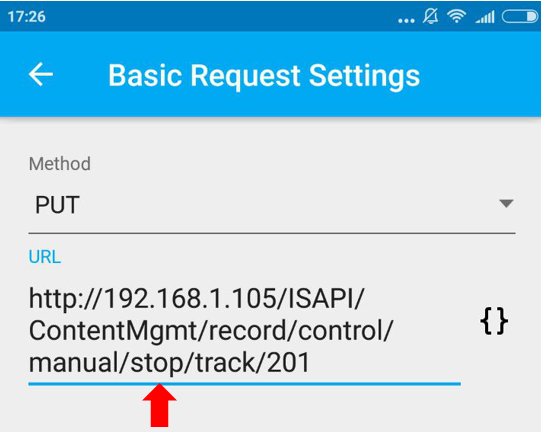

Next edit the Stop Recordings All Cameras shortcut again.

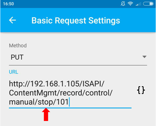

Click on Basic Request Settings and edit the URL. Replace 'start' with 'stop'

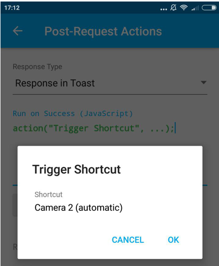

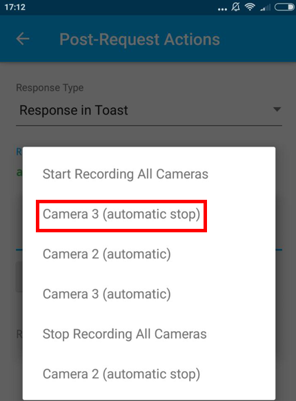

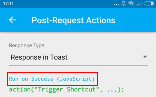

Then look further down for Post-Request Actions (might just be called Actions depending on your application version) and press Run on Success (JavaScript)

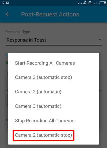

Press and hold Camera 2 (automatic) for at least three seconds to update the trigger shortcut.
Select Camera 2 (automatic stop) and save your changes.

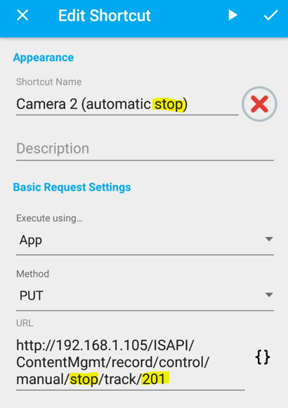

Back at the main menu, edit the Camera 2 (automatic stop) shortcut changing the Basic Request Settings as follows:
Next repeat the Post Request Action steps you did earlier, but this time point the trigger action to Camera 3 (automatic stop)
Save the changes.
Finally, from the main menu edit the Camera 3 (automatic stop) shortcut in the same way as before by changing the 'start' to 'stop' in the Basic Request Settings. Save the changes and test. Hope this helps, keep me posted.
