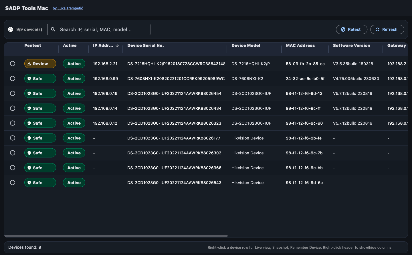

I downloaded this software (v. 1.0.1 (2)).
I put it on my v15.7.7 macOS machine (IP: 192.168.2.42) and it worked first time. *crowd noises*
I inherited two HIK Vision systems when I bought a house, and I do not have passwords for either of them :(
The two systems are now running on different subnets.
192.168.0.99 (My newer system)
192.168.2.21 (My old system)
192.168.2.21 is visible, as 192.168.2.x is my mesh subnet, the other on the 192.168.0.x net isn't.
sadptoolsmac has observed both my DVR systems, and the 7 cameras attached to 192.168.0.99 which is a good start.
My plan:
My intention is to get a password XML, provide it to HIK Vision for an update XML, apply it with sadptoolsmac and to move the 192.168.0.99 DVR over to the 192.168.2.xx network.
My assumption is that on re-boot, all the cameras will attach to the new sub-net of the DVR and become visible on my mesh subnet again.
a) Is the XML file a 24hr and session dependent file, requiring a new password XML file from the same physical session like SADP?
b) Is there anything on the HIK Vision software via login to the physical machine that I will need for this or is sadptoolsmac sufficient?
Thank you for your attention.
DrDweeb

Well you can send the xml to me in DM, i will generate a reset one.
Reset code
be8e2460
You can manually input code or put inside notepad and save as anything.xml
