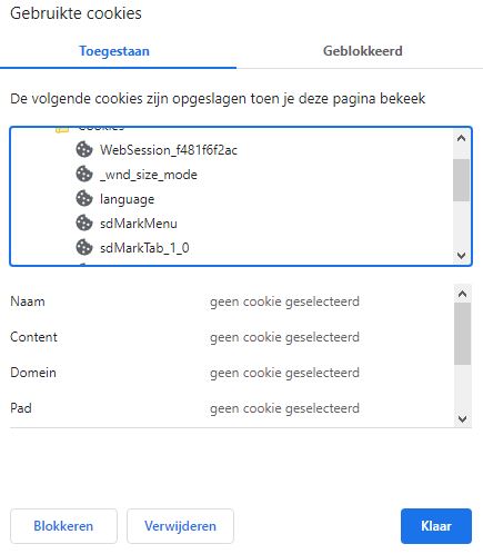

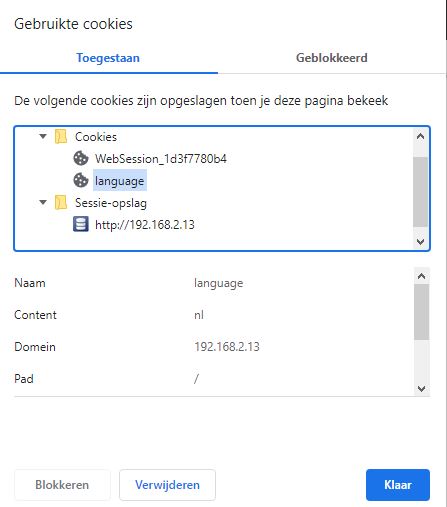

I just did a check on the cookie difference between the page viewing the camera and the page trying to view the NVR. I attached the different copies. The first one is the NVR the second the camera.
Maybe it is of any use.

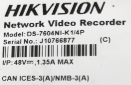

is the nvr ds7604ni-1k-4p (c)? According the firmware version it should the C version.

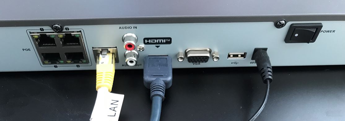

can you make a picture from the backend of the nvr?

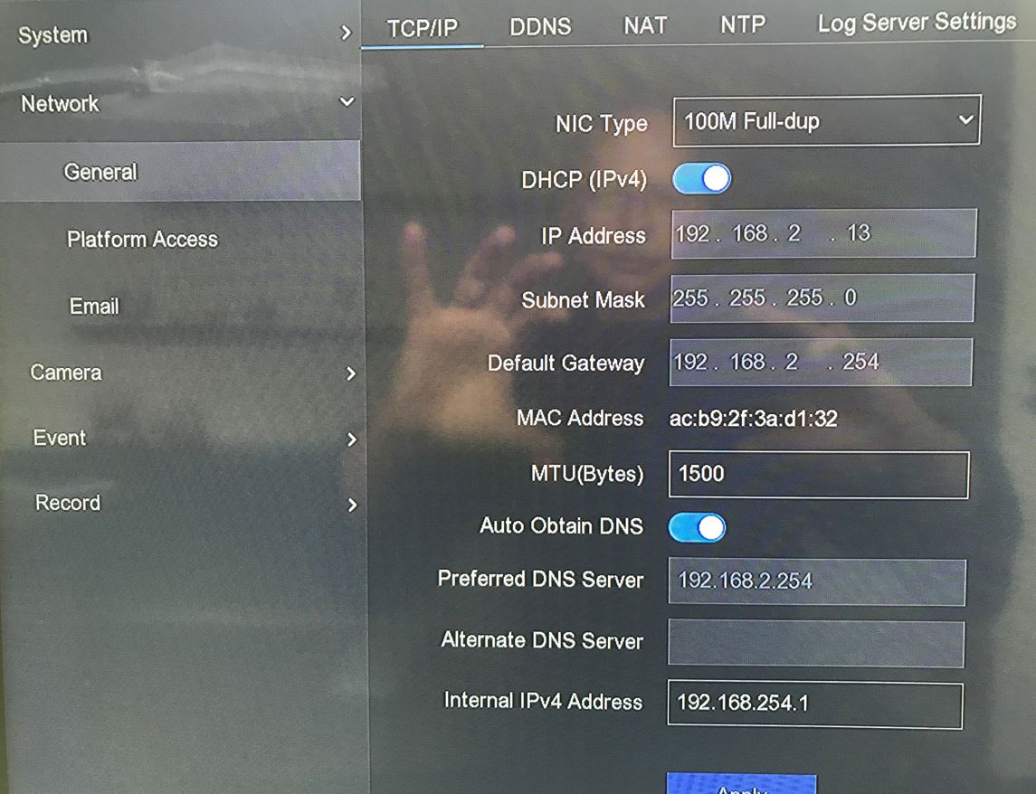

can you share a picture of the network setting in the nvr?

It is a DS7604NI-K1/4P the (c) I don't know, there is a (c) in the label. I attached a picture of the label. I recently did an update of the firmware to the latest version "Firmware: Firmware_V4.71.000_220224 Applied to: DS-7604NI-K1/4P(C)"

I attached a picture of the backend.

I attached a picture of the NVR network setting.

I wondered overnight whether you might be using home-made cables.
Home made cables are a notorious problem, especially when things 'almost' work ;)
I can see a moulded plug in the photo of the rear of the NVR, so it's safe to assume that is a factory manufactured cable.
Perhaps test with a different cable for that link to the NVR, in case that cable has a fault?

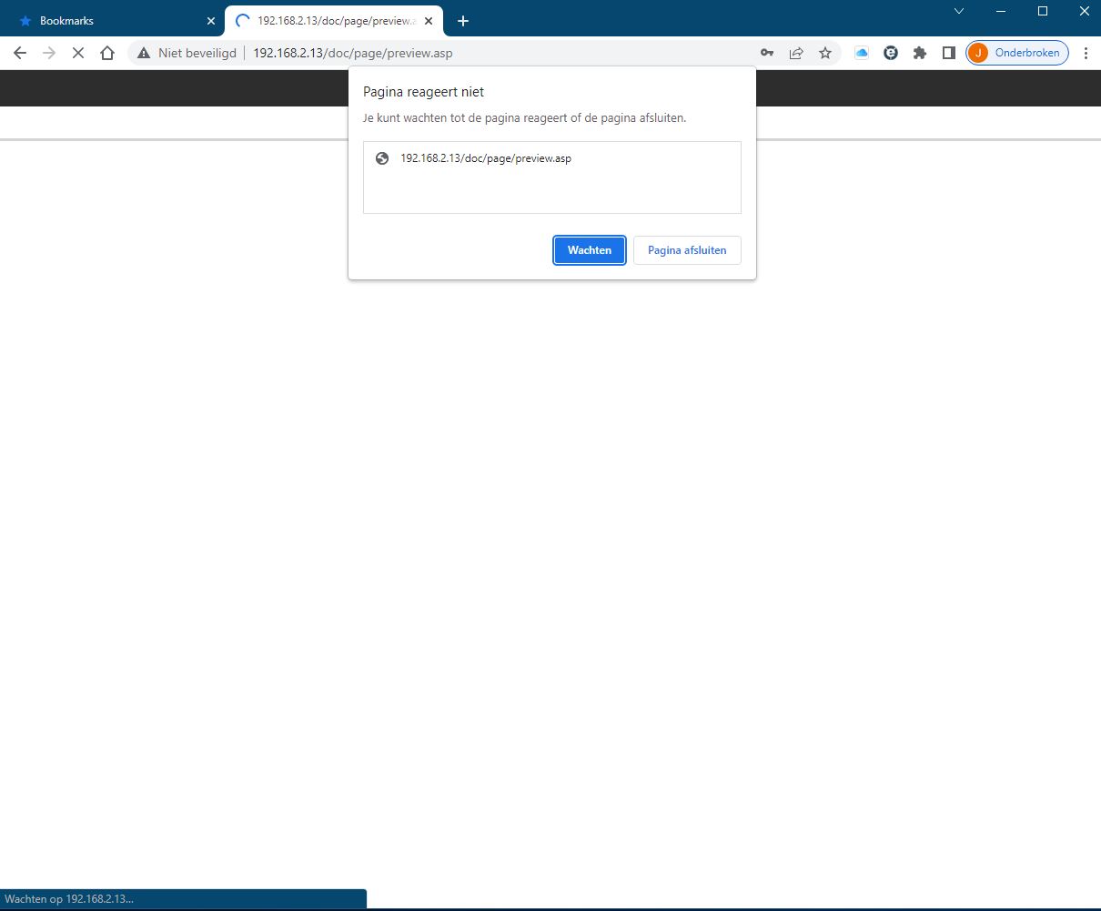

It is indeed only when te the PCs try to access the NVR via the network that there is a problem to view any page after a log in on the NVR and the browser gives a notification that the page doesn't respond. See the attachment.
The PCs can access the cameras directly by browser.
It is a very weird problem to me. It looks like it has something to do with the firmware or other software in the NVR. But who knows.
