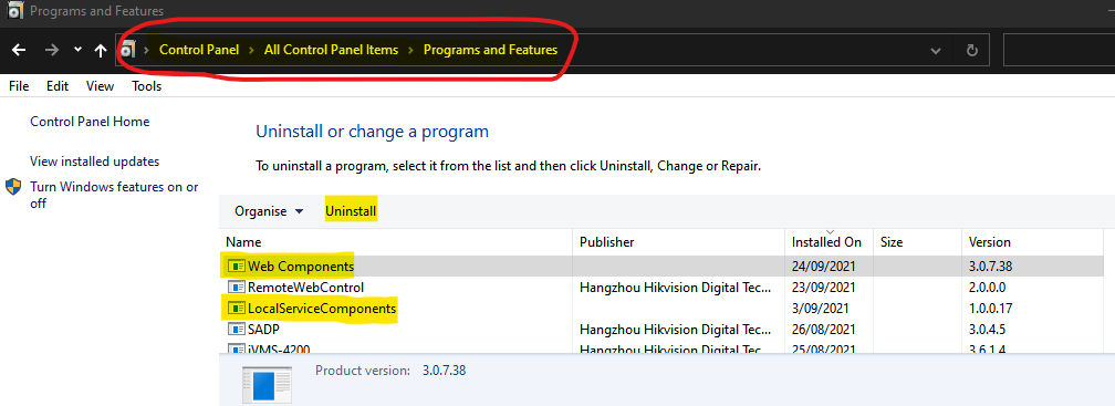

I suggest prior to running the new plug-ins etc to firstly uninstall the previous versions from your PC & Restart your PC

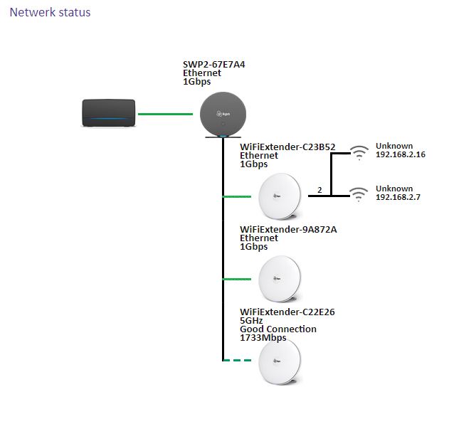

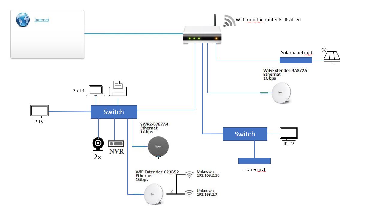

@ Phil, I made 2 drawings of my network. The second is the wifi configuration.

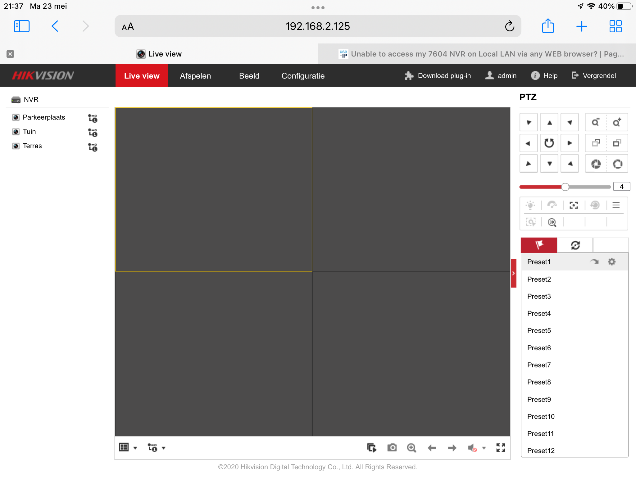

when i go to my nvr which is at 192.168.2.125, it shows the following
i see at your picture something with preview…..

When i log in it shows that preview only within live view.

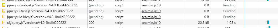

I just did a try with chrome and a log of the network traffic from the browser. I see this. So a script stalls the browser.
