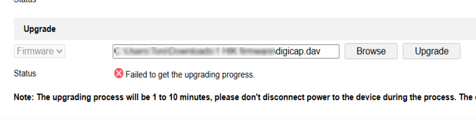

I've been sent a file by Hikvision via Wetransfer. I get the same error message, although this time it ran through to100%, but the NVR did not reboot. I'm waiting for them to advise.

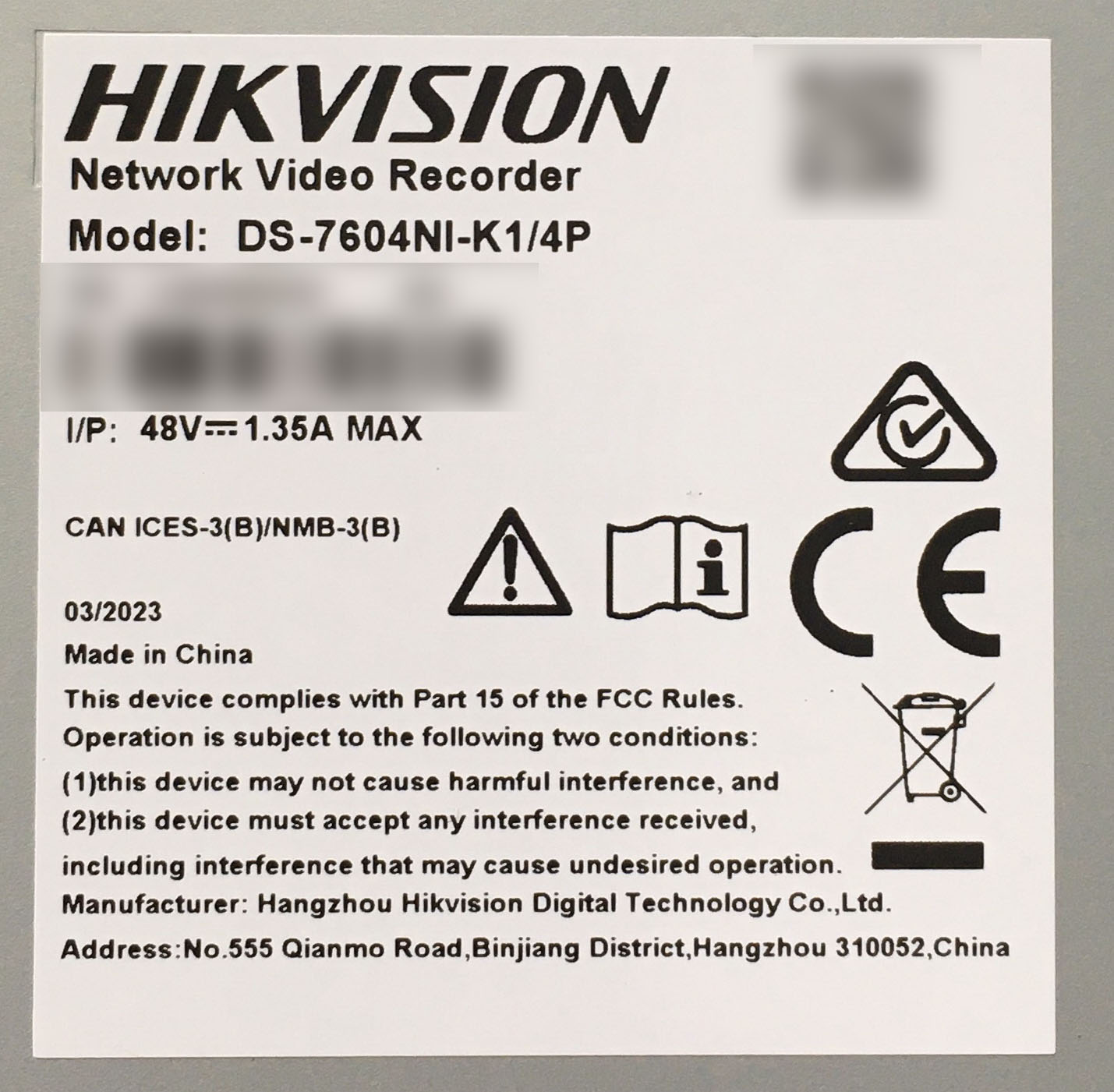

This is the info on the bottom of the NVR by the way...

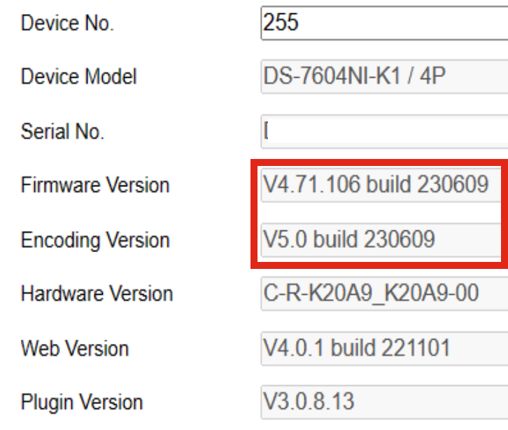

I decided to try running the upgrade from ivms-4200 on a whim...and it worked! No idea why. Perhaps this will help someone else in future.
I now have additional menus on the NVR interface, but I still don't see anything in the target detection playback, there's no red indicating motion events - same story as before.

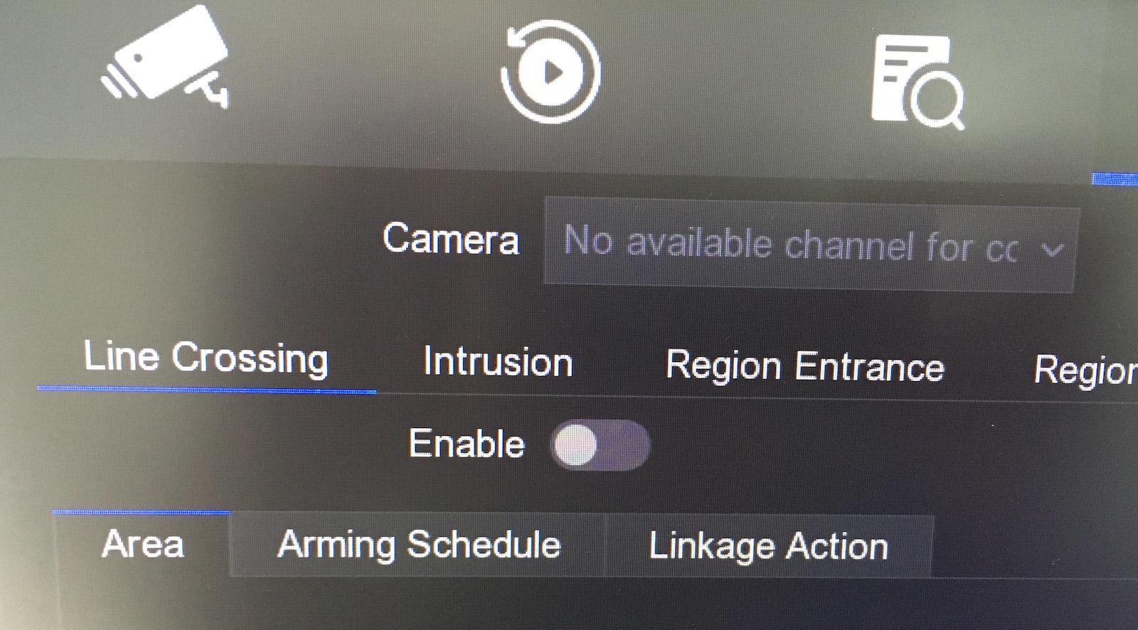

There is now an option to set perimeter protection, but it can't be enabled. Camera dropdown is greyed out (no available channel for...). Perhaps cameras are not supported?
I was hoping to set up line crossing, because as Dan said, motion detection is a blunt tool.
Did you tell Hikvision what your current firmware is?
I am wondering if a full factory reset of the NVR would help, the current config could be corrupted. The key to this is where your existing firmware came from, you need someone who has access to Hikvision technical resources.
I suspect the web GUI firmware upgrade path was the problem, I think ivms4200 uses a different method.

I did tell them the firmware I had.
They confirmed that the hardware is EU/UK compatible.
They also seemed to think that the hardware might be obsolete (that's why they don't list it) - I bought it in April! Grrr.

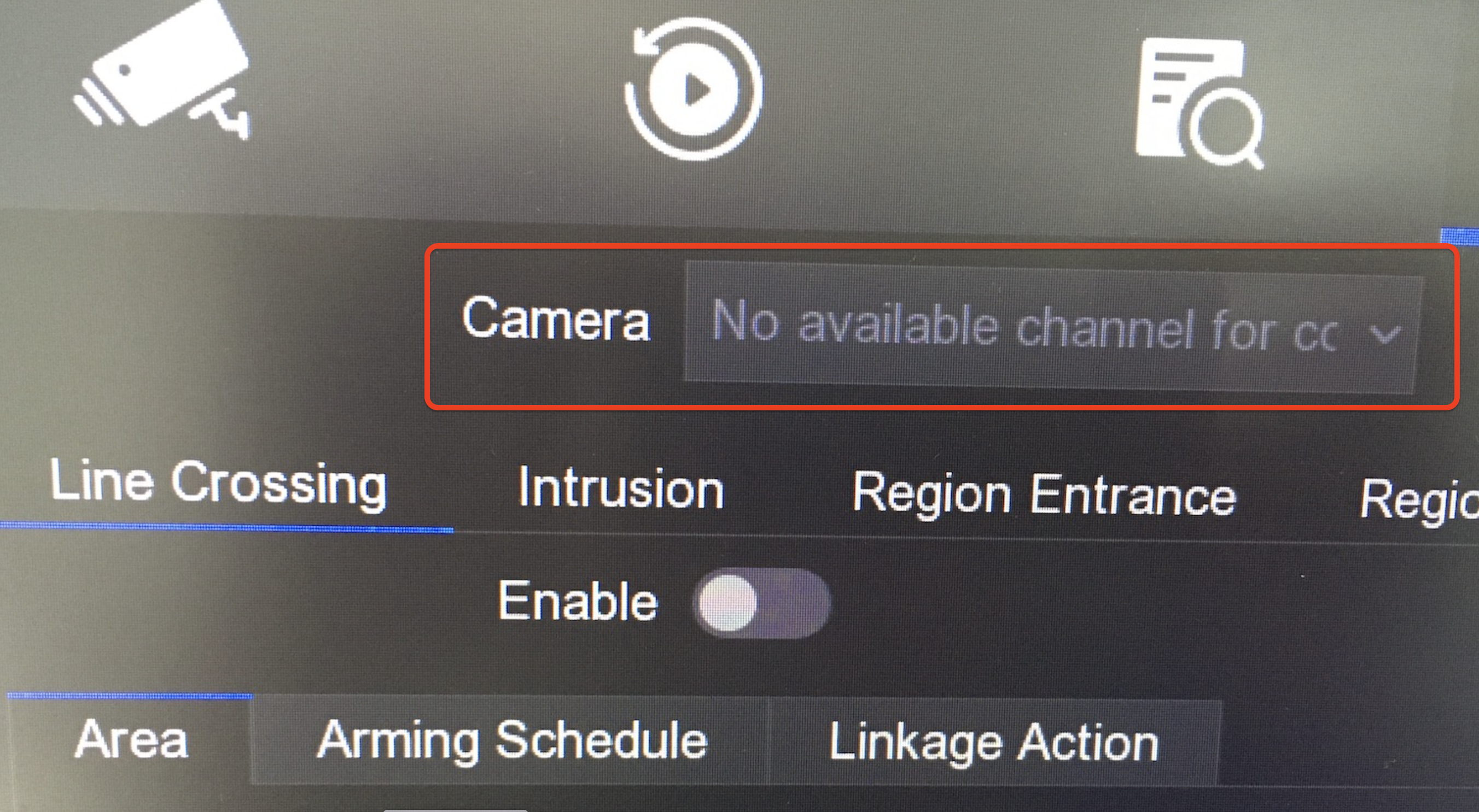

Perimeter protection is unavailable as before (from both interfaces) - not able to toggle "Enable", thus no Line crossing, intrusion etc. are configurable.

Yes, but the dropdown is greyed out, and it's impossible to toggle the "Enable" button.
Normal events and Face Recognition can be enabled, and the camera dropdown is active.
Perimeter Protection and Other Events both don't have the option to choose a camera, and the Enable button can't be toggled.

I have been working on the NVR. Absolutely no way to choose a camera or enable anything under perimeter protection.

Here is the response from Hikvision:
Good day, thank you for contacting Hikvision. This model NVR does not support Smart events, if you have cameras that support the smart events you will need to enable the events directly on the cameras.
