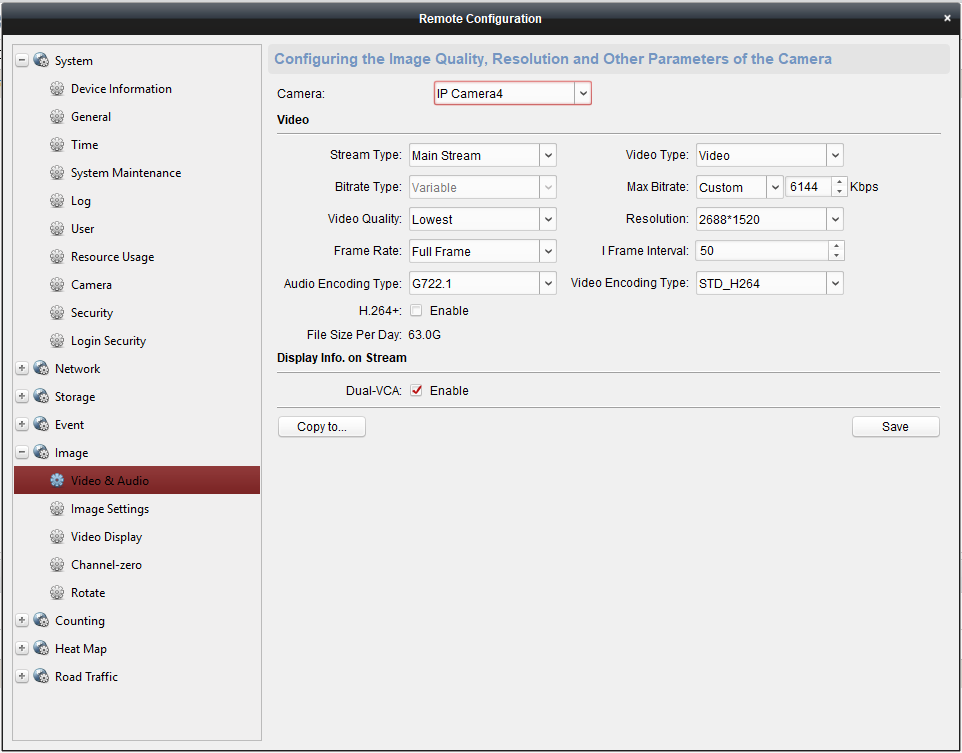

I had same issue - remote playback was possible only for records taken during night hours, about 4.00pm - 7.00am(November 2018, CET)
First of all try below steps and write if this helped - it works for me!
Go to iVMS-4200 -> Device Management -> Remote Configuration -> Image -> Video & Audio -> set 'Video Quality' to 'lowest'. Default value is normal, set it to lowest, apply and try if this helps.

I figured out that cameras have 2 streams: main-stream(for day recording), and sub-stream(much lower quality) for night recording.
So remote playback works for me when playing back the sub stream, when it turns to main-stream, there is some problem with HIK-Connect Service.
I don't think this is the upload limit(3MBit) of my internet connection, because live view(in high quality) is always smooth. (@Callum84 has 20MB up and same problem)
What I did was to decrease the quality of main-stream image and it helped! It didn't decrease file size dramatically, but it works!
You can try changing resolution e.q. to 1080P - this also works.

Has anyone found a solution other than changing the video quality to “low” ? Would prefer to keep my recording in high quality if possible!
Tested mine today, i’ve set my video quality to medium this seems to work for me. Hopefully a long term fix will present itself soon.
