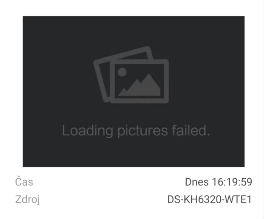

I am getting snapshots in indoor station and can see them there but not in Hikconnect Android app. So everything works except I am not able to see the snapshot inside app:
