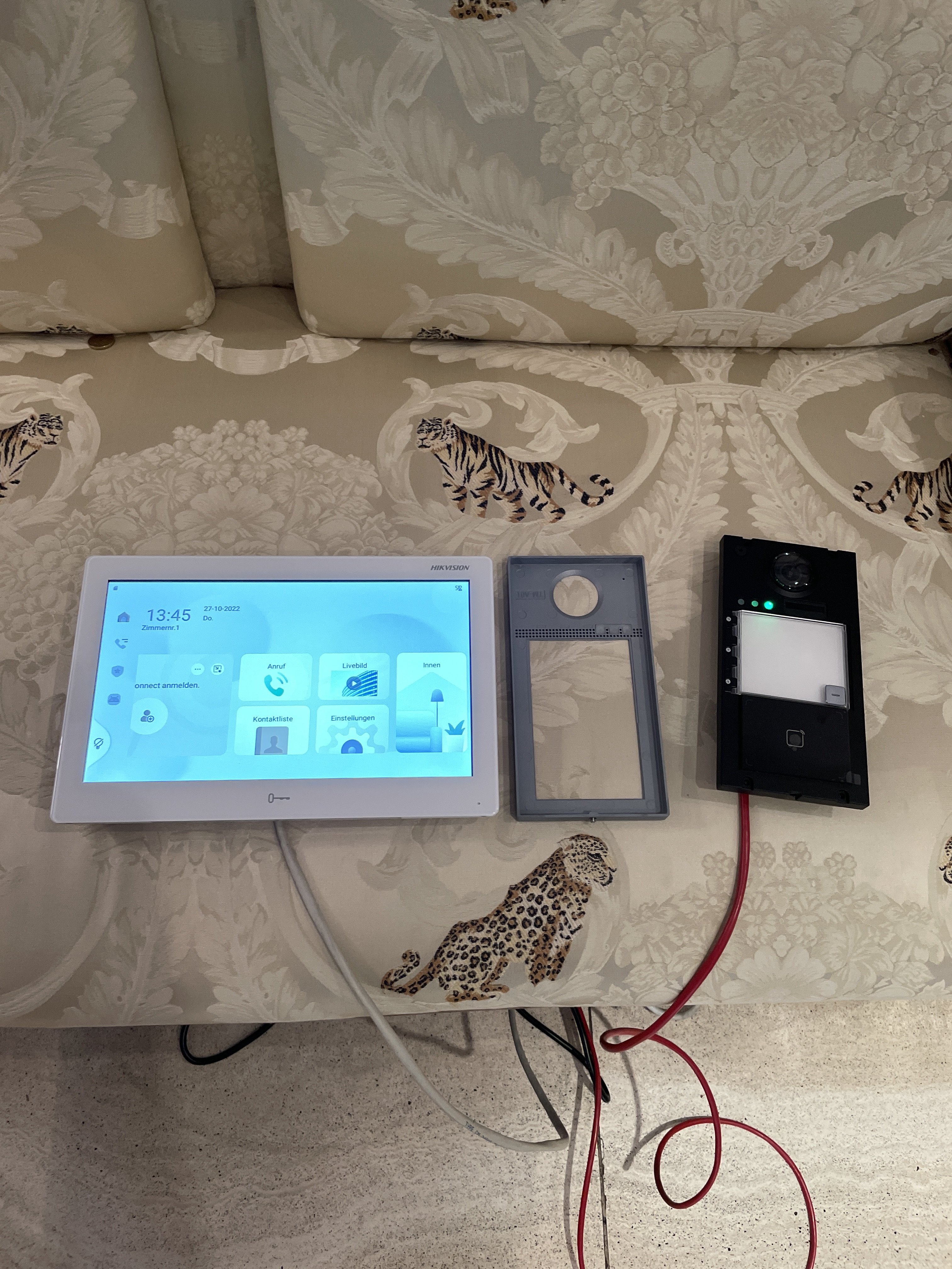

I have this setup ..
the white display is the indoor station no?
i tried to follow the steps you mentioned..
or it might be not possible with my indoor station?
Upvote 0
This is indoor Android station, i believe KH9510.

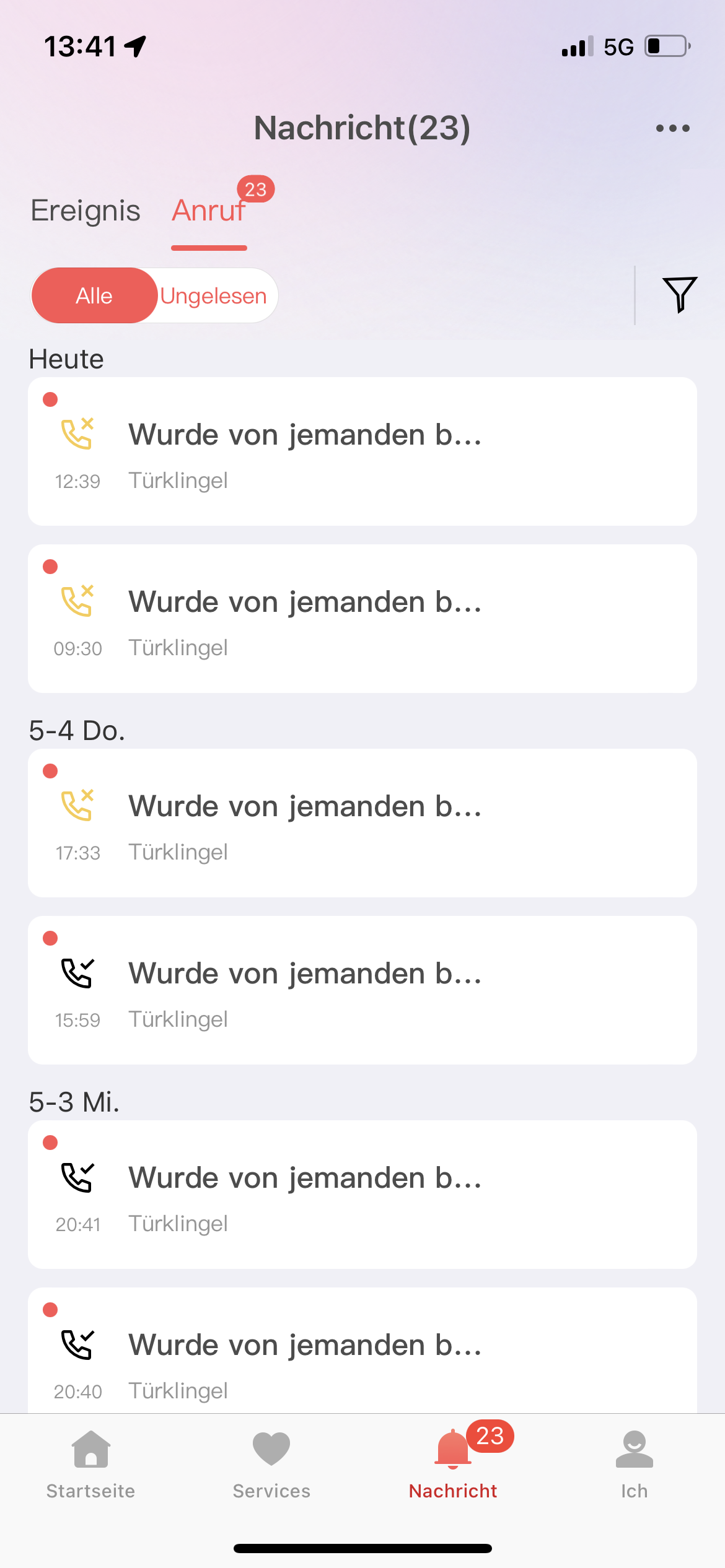

just found it under the tab „preferences“ and enabled it, unfortunately still no picture in my app
