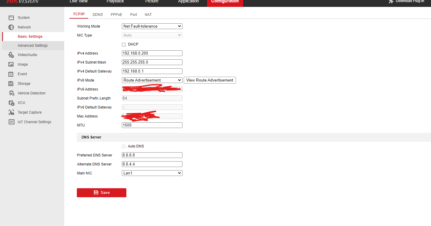

The Hikvision advice has always been to use Googles DNS address of 8.8.8.8/8.8.4.4. In the past I've had incidences where certain ISP's routers didn't play nicely with those addresses when the ISP's "Web safe" content filtering was in use, as using a DNS address other than the providers was seen as a way of trying to get around the filter. A few years ago I had a couple of sites on BT broadband where setting DNS to 8.8.8.8 blocked access to the network and just resulted in a BT webpage being displayed - using the router address and letting it forward the DNS requests solved it.

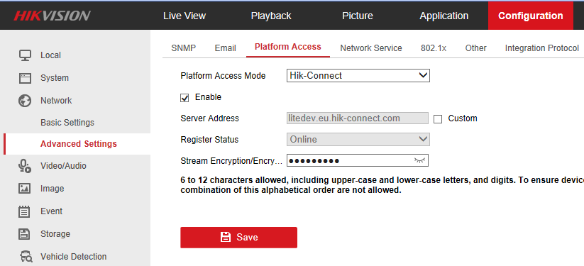

  • Added a stream encryption key (as I was not using one before) and saved (worth adding & deleting & adding again). When I hit save this time it connected OK (seems this was upsetting it all).
  • I then added my NVR back to my iPhone app using the scan option / QR code displayed in the NVR (connected via Hik-Connect service).
  • As if by magic all was fixed again (seems faster than ever before)

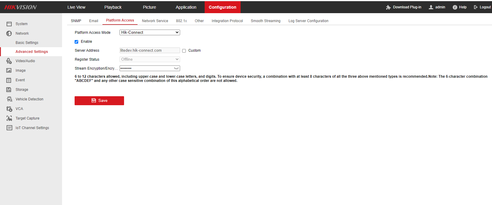

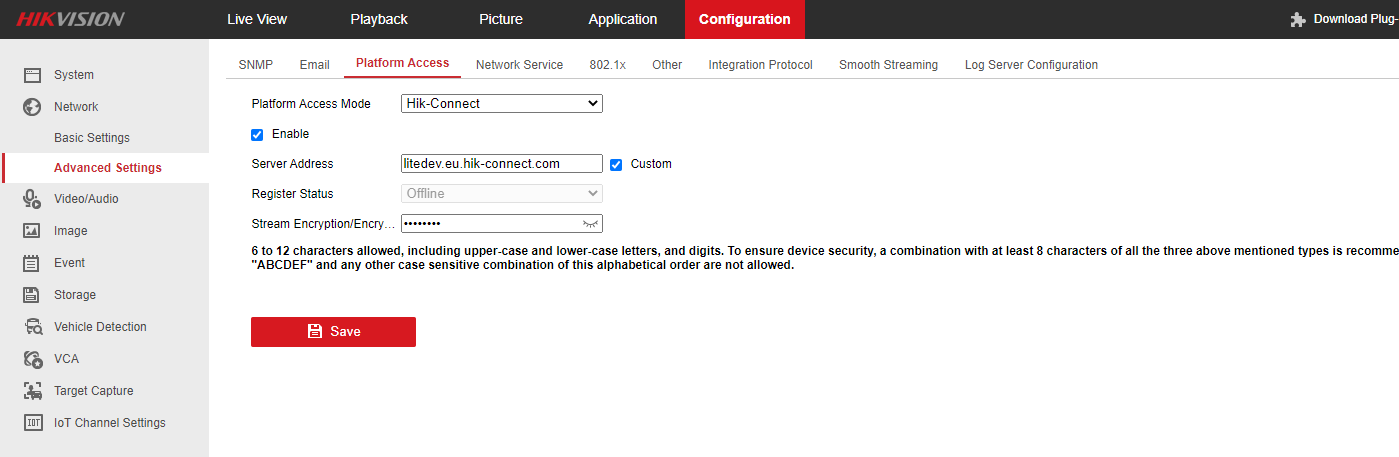

Could I ask is litedev.eu.hik-connect.com still the correct address with 8.8.8.8 and 8.8.4.4

How interesting, i have tried mine having the router issue the IP setting but this didn't resolve it, one thing i note is when i untick the "custom" box which i know has caused people issues before it defaults to non EU one as the pictures where yours does not.

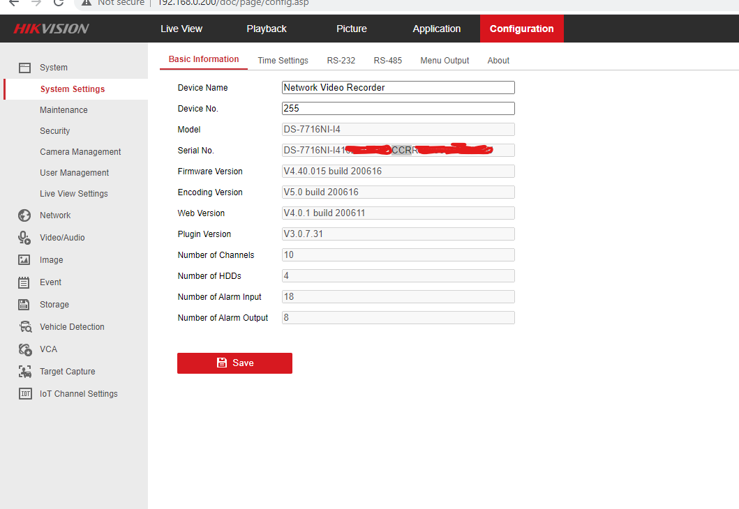

attached a couple of screen shots for those also having the same issues.
