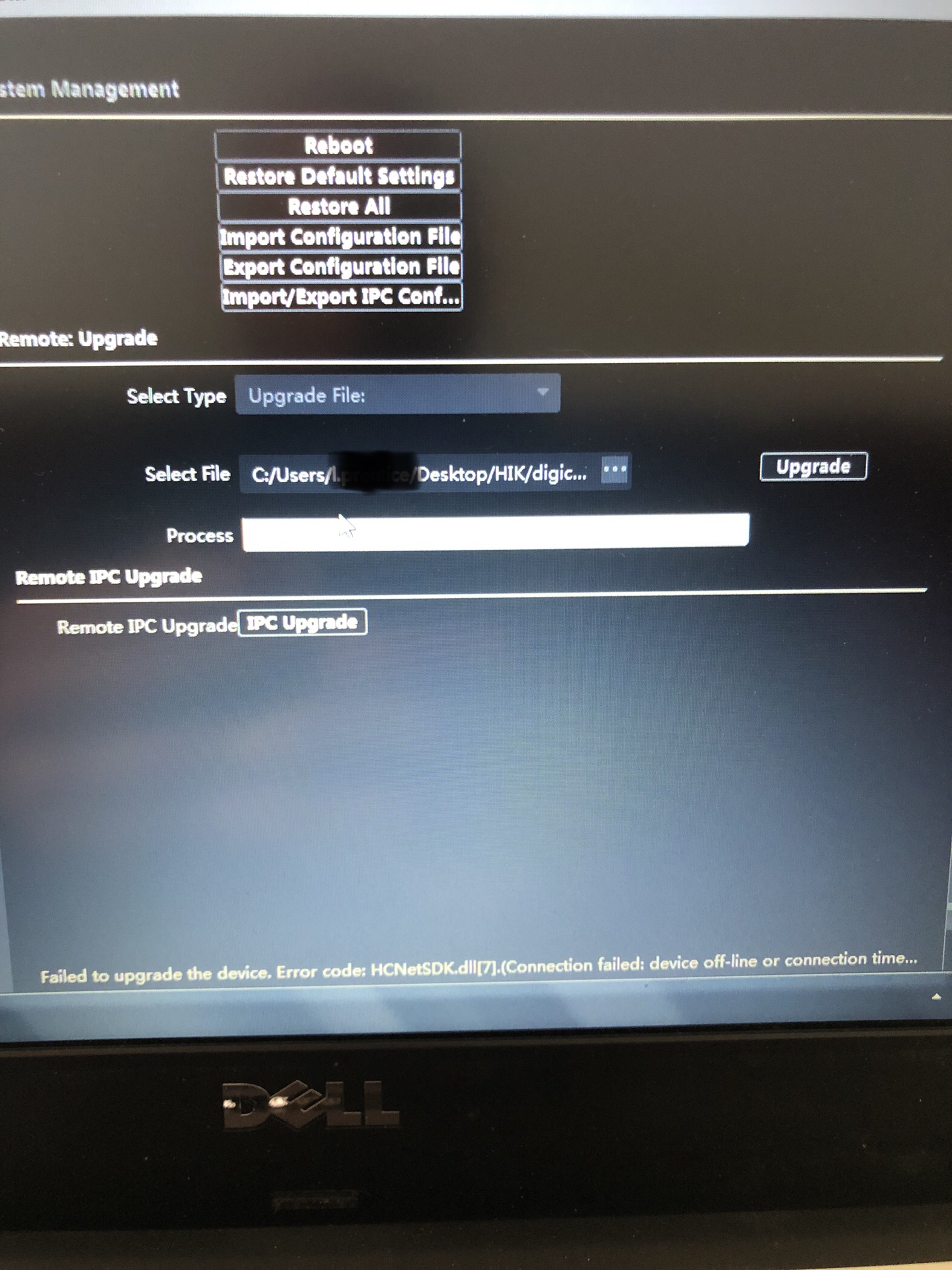

So…. I’ve managed to do all that. Go into the software and my NVR is displayed and showing as online under resource usage status.
Go to system maintenance, remote upgrade. Select the file (the first of many updates, doing them in the order you suggested) and when I click on “upgrade” I get an error message straight away saying “Failed to upgrade the device. Connection failed. Device offline or connection timed out”
Any suggestions? Thanks again

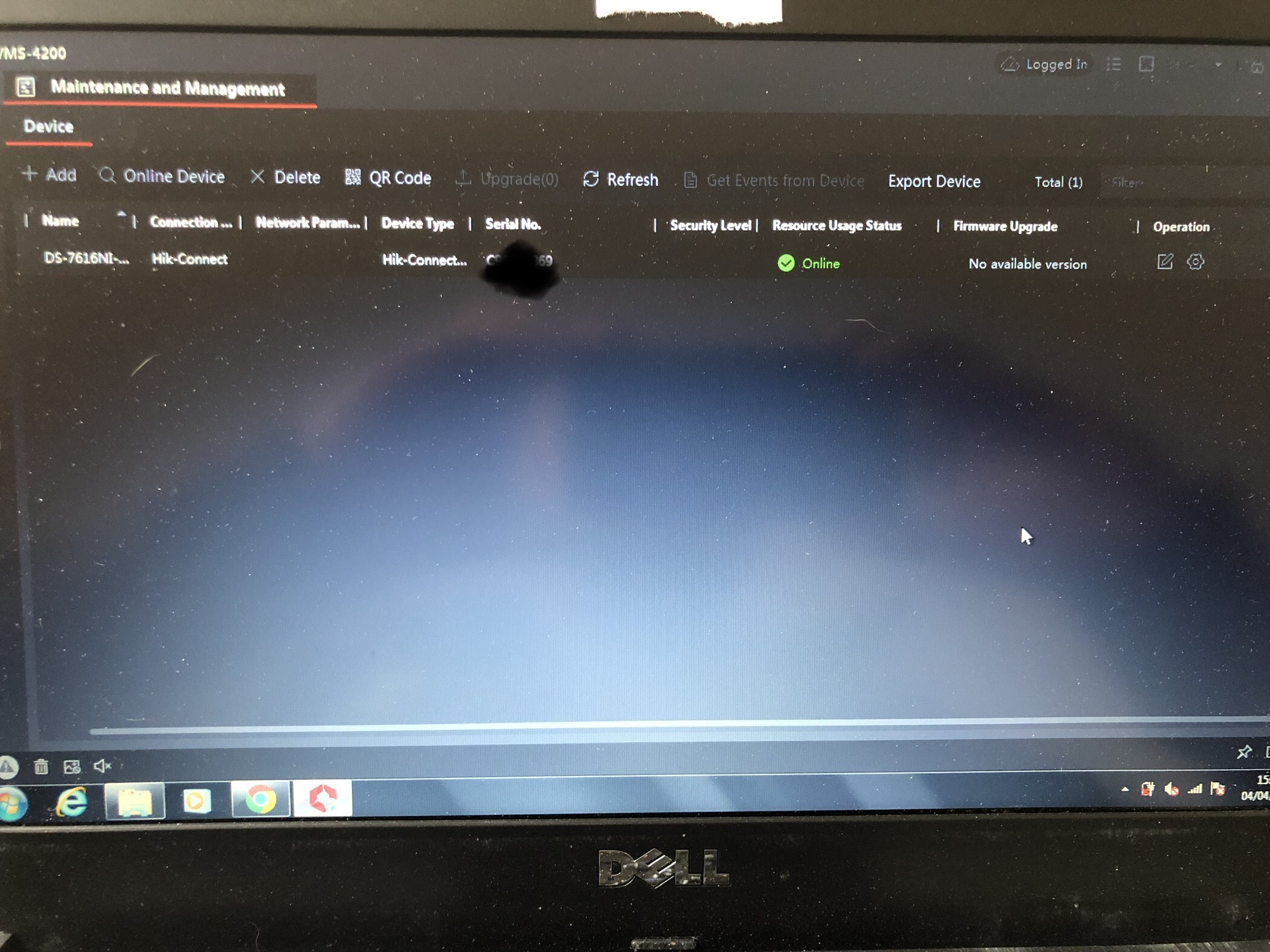

Can you share a screenshot of the device management menu from iVMS-4200?
Upvote 0
Of course, 2 photos attached (1 showing the error message at the bottom)
I really do appreciate your time & tenacity!

Okay, I can see you've added it via Hik-Connect.
Can you delete the device and re-add it by clicking the add icon in the top left and add it using the IP address, username, and password.
Once it is added that way it should be online and the firmware update should work.

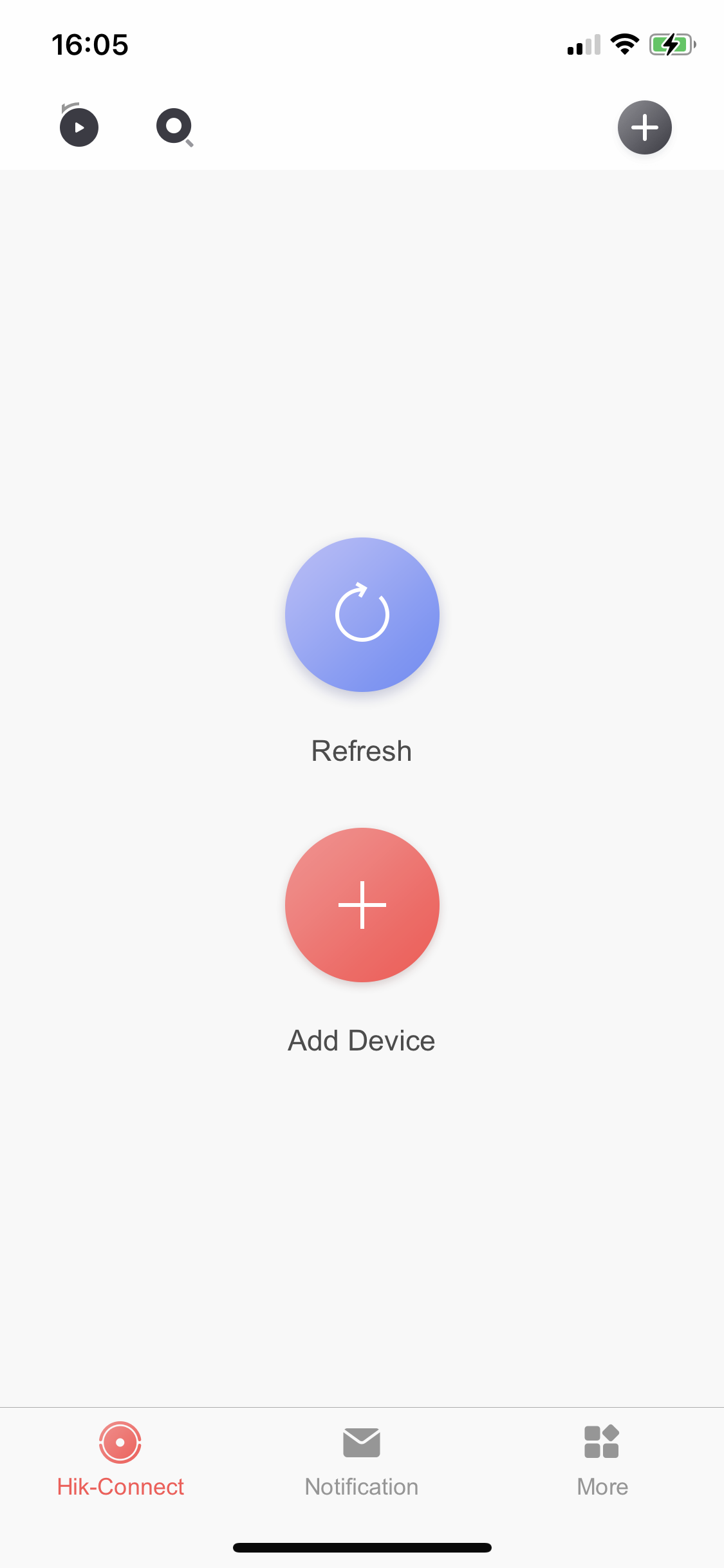

Yes - after deleting the NVR from iVMS my HIK connect app (where all the cameras were) looks like the attached.
Upvote 0
okay, did you log in to your Hik-Connect account in the iVMS-4200 software?
If you did I think you are going to have to re-add the NVR to iVMS using Hik-Connect method to get the NVR back in the app. Then you need to click where it says "Logged In" in the top right of the iVMS window and click exit on the dropdown, this should then log you out of Hik-Connect and you can then manually add the NVR using the IP address under "IP/Domain". (The port number should be auto-filled as 8000, if it isn't then manually enter 8000)

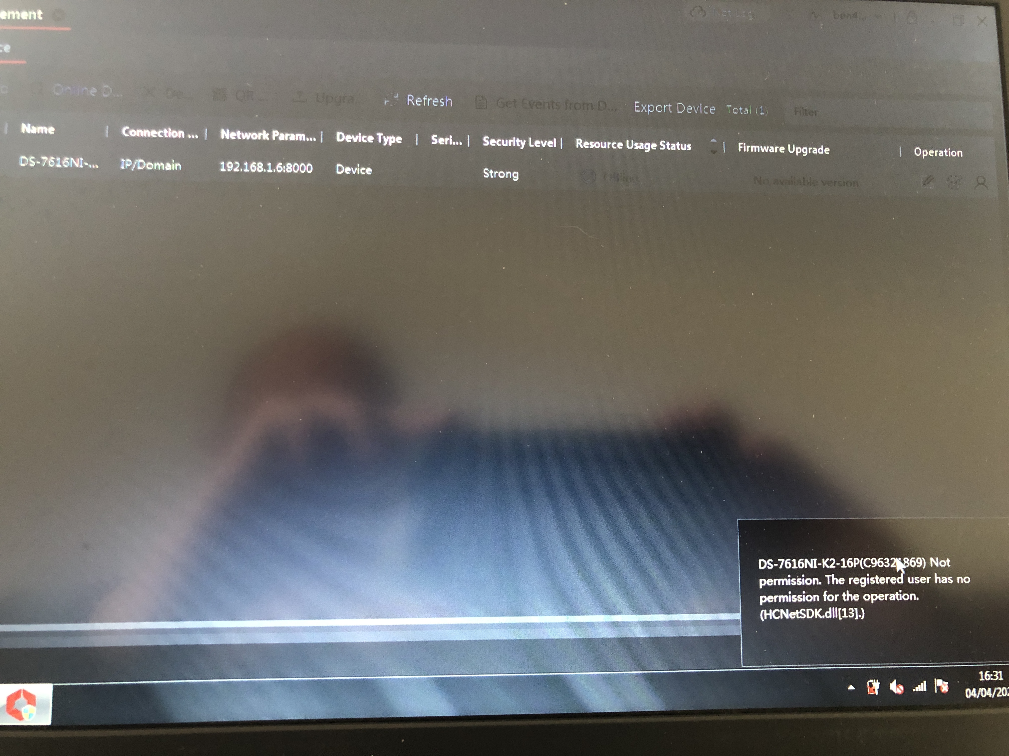

Ok. Have tried that and although it’s added, its status is offline and I get this error message

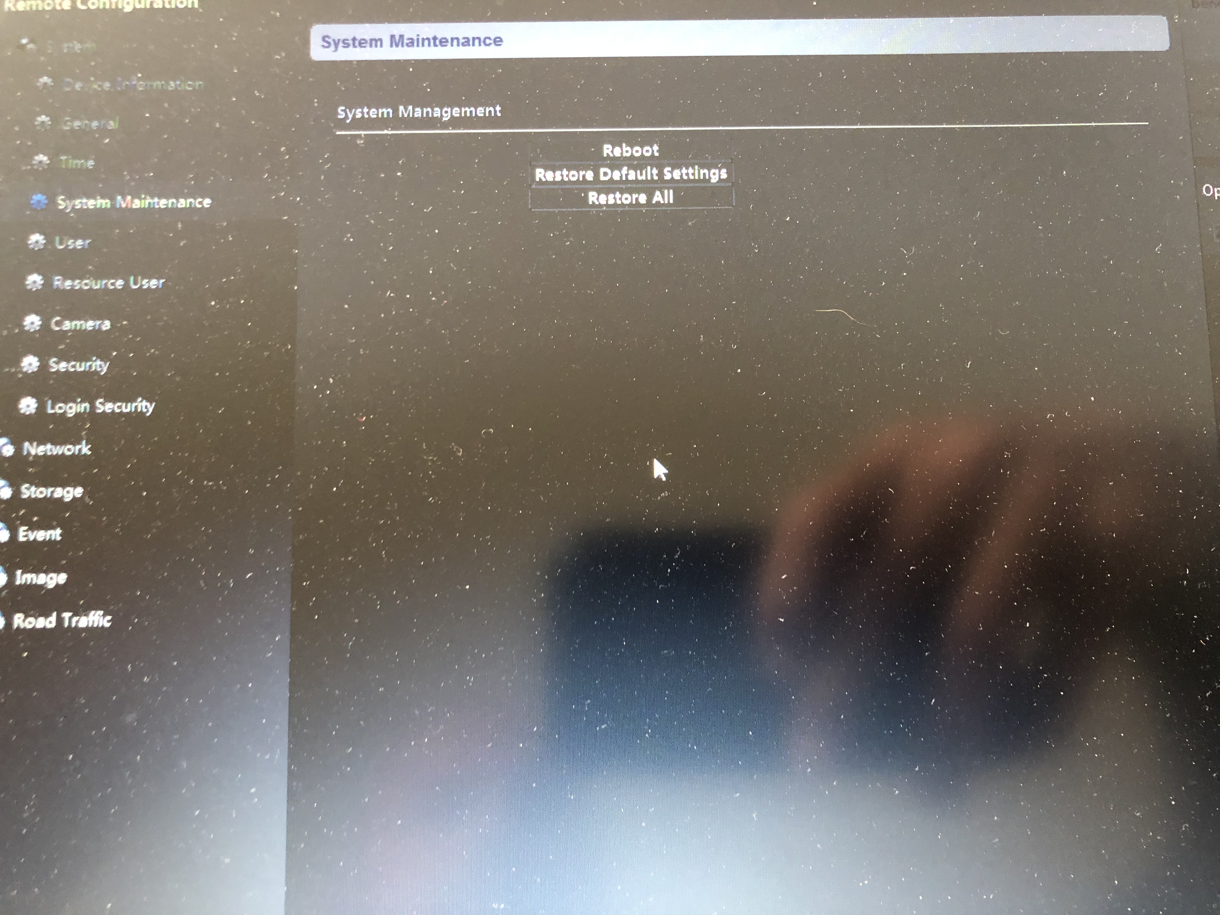

I’ve tried. However….. under system maintenance there is no longer the option browsing for the upgrade file
