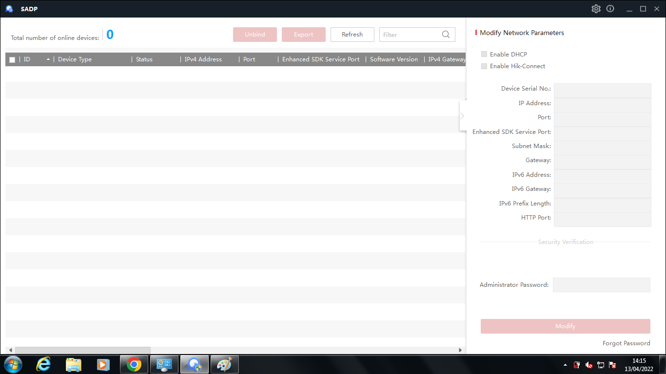

Ok… after a few technical issues, here’s an update
I manage to reset the camera - pressed and held the reset button whilst connecting power etc. The camera clicked and the IR lights flashed (which I believe means it has reset)
However, having downloaded the SADP tool (and being connected to the local network) I cannot see any devices at all (including the working ones)
I have tried multiple different laptops which run different operating software. I have tried turning off the antivirus software and have also uninstalled and reinstalled it several times, but to no avail…. Any suggestions? I suspect I’m doing something wrong (clearly) but can’t figure out what!

Hi @Chip
The PC/Laptop you are running SADP on, is that hard-wired to the local network (e.g. plugged into the router or a switch on the network) or are you connected via WiFi?
Upvote 0
Yes, an Ethernet-connected device is best for scanning with SADP because when connected with WiFi the laptop is not exactly on the same IP range as the hard-wired cameras.
Upvote 0
I've tried connecting to the router / network via ethernet and I'm still getting a blank SADP....

Hi Dan
I come bearing good news!! I’ve spent the last 4 hours trying and retrying to get this sorted. I’m still not entirely sure how I did it (I managed to find the cameras and the inactive one after connecting my laptop directly into a random port on the remote PoE switch, rather than the router) but after a lot of shouting and swearing all cameras are now working.

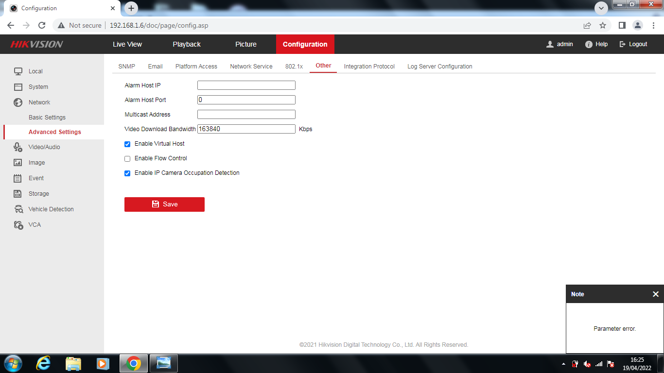

Many thanks, Dan! I've managed to update the PoE cameras but am struggling with the ones directly connected to the NVR. When I try to configure the NVR to enable Virtual Host I get the attached error message (parameter error) when trying to save the changes
Upvote 0
Hi @Chip
Can you try logging into the NVR using Internet Explorer instead of Chrome and then try enabling the Virtual Host setting? The K-series NVRs don't offer full support for modern browser access.
