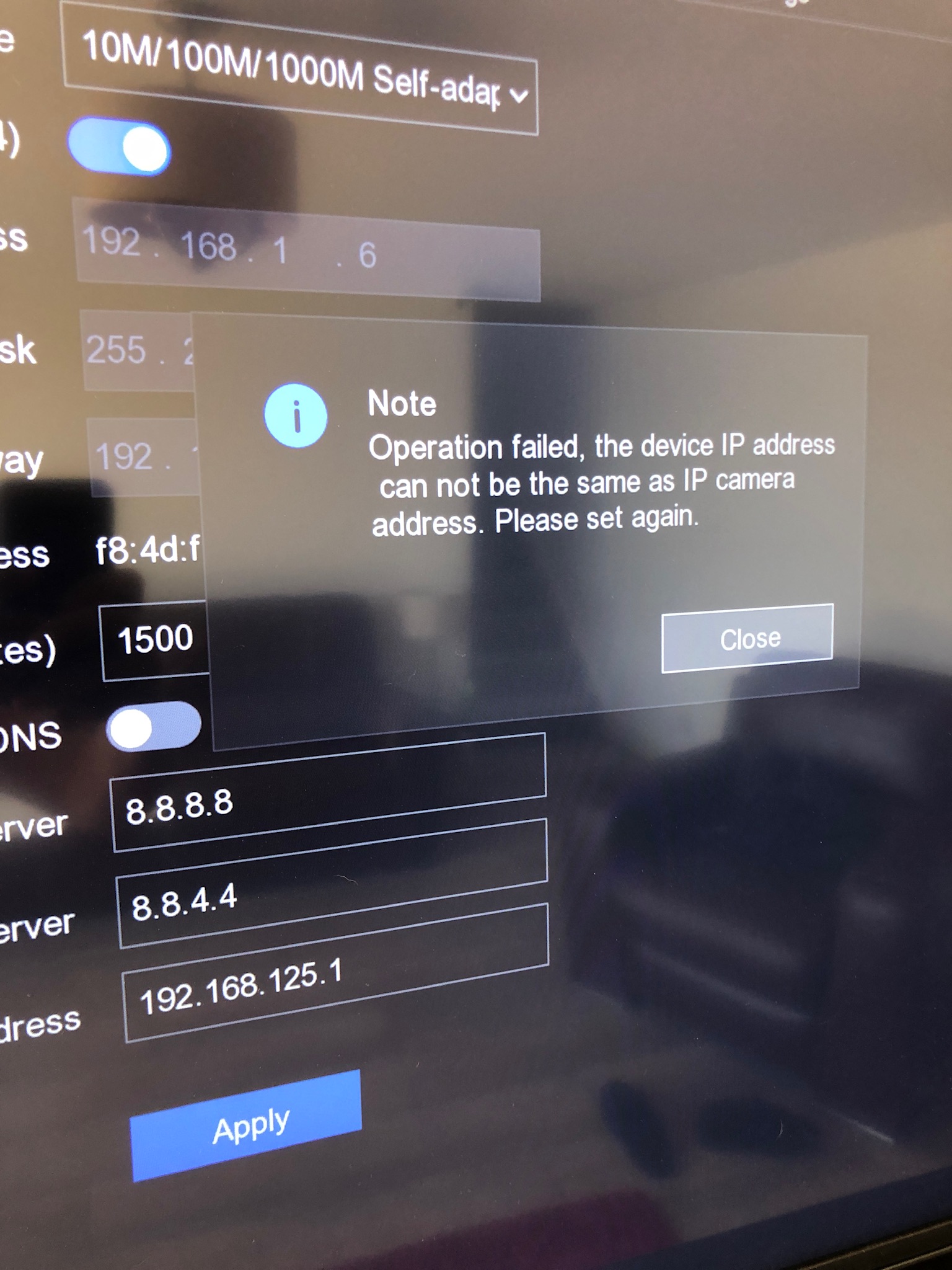

So, I’ve continued to try and get this to work. Wasn’t sure if it was something I could access via a monitor / hdmi from the NVR. But having tried I’ve come across a similar menu for setting the preferred / alternate DNS. When I add 8.8.8.8 and 8.8.4.4 here and try to save it I get the attached error message. Could this be what’s causing the “parameter error” when attempting to do it via the IP address and an IE browser?

Hi @Chip
Yes, that looks like it is the same error message just with more explanation, but I can't understand why it would be saying you have clashing IP addresses when I can't see any repeated IP addresses in any of the screenshots you have sent.
It might be that some other network device you have recently added to your local network has been assigned the same IP as the NVR and this is causing strange network conflicts.
Can you open Command Prompt on a PC on the same network as the NVR and try pinging some of the IP addresses around the one your NVR is currently using (e.g. 192.168.1.7 / 192.168.1.8 / 192.168.1.9 / etc...) and see if any of these addresses are free and unused by any other device. If they are you can disable DHCP in the network settings of the NVR and manually change the NVRs IP address to one of these available addresses before trying the Virtual Host setting again.

It’s been another bizarre sequence of events. I did what you suggested, but whatever free IP address I changed the NVR to, I was unable to log in to it via an IE browser (I was just taken into a landing page for my router / ISP)
So I left the DCHP disabled and just entered the original IP address and it worked - it let me update and save the DNS servers and then log in to the NVR on a browser and tick / save the virtual host option. I have subsequently been able to update the firmware on the remaining cameras. So, strangely, it seems by just disabling the DCHP setting but leaving the original IP address, it all started behaving.
