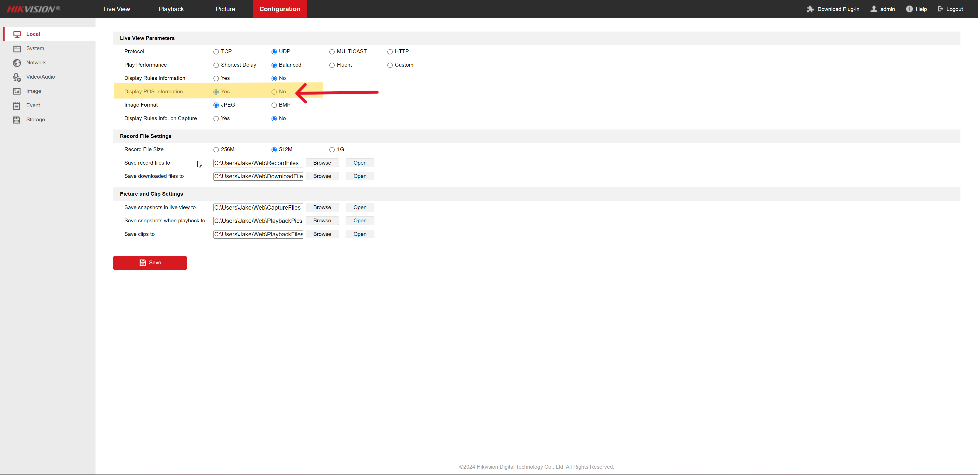

For this issue, could I get you to check whether you have the below setting set to 'disabled' or 'no', if not does the code disappear after disabling this, please?
You can find this setting by selecting the Local Tab when in Configuration in a web browser.

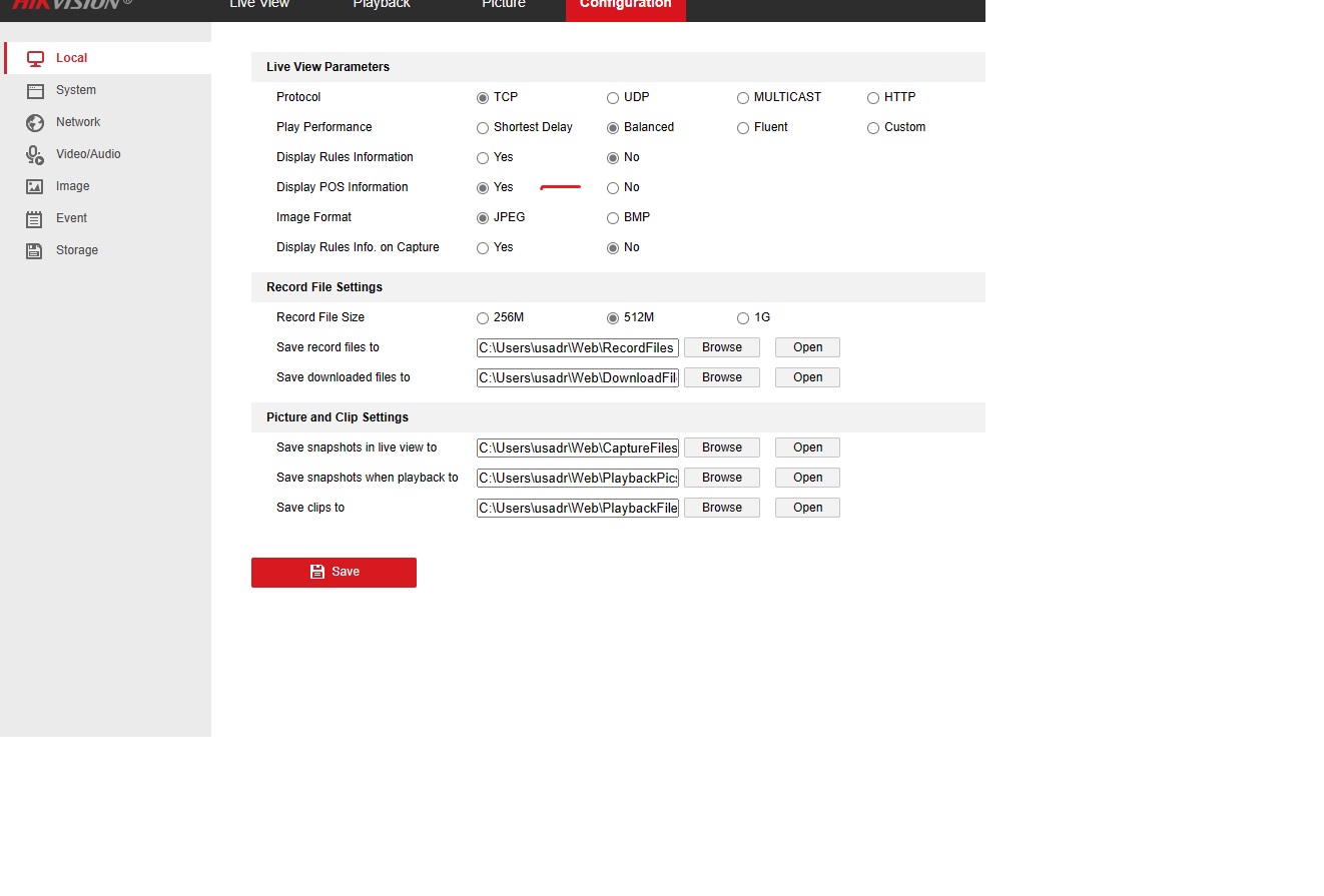

This is how it is set in the previous version V5.7.14 build 231028. Maybe it should have been unchecked after the upgrade?

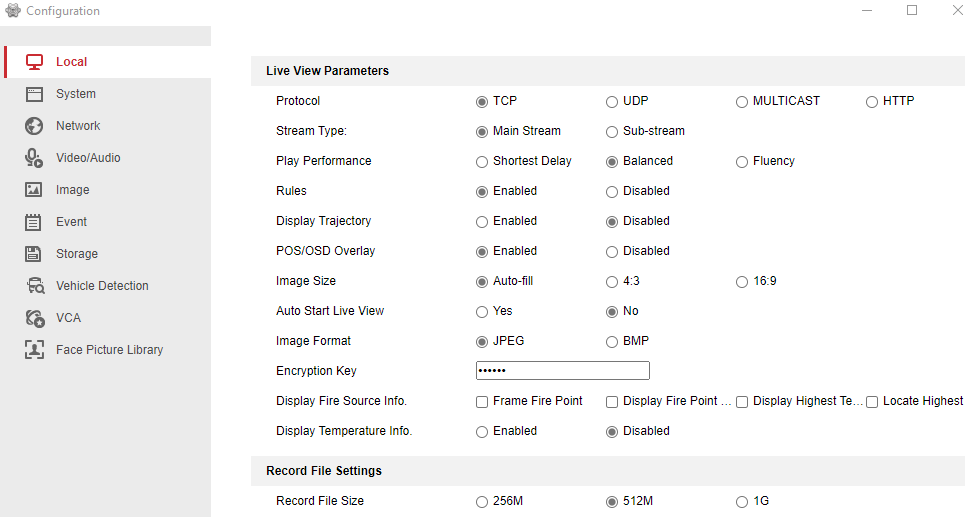

If you are viewing the camera through IVMS, does disabling 'Display Transaction Information' in the Main View's Configuration stop the code from showing up, please?
You can find it by clicking on the cog normally in the bottom right of the main view screen and then going to the 'Image' tab.
If you aren't using IVMS and are still seeing the issue, could you let me know where abouts you are seeing it, please?
Hi @Jake Hulks
Yes this stopped on iVMS by disabling 'Display Transaction Information'.

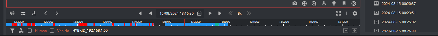

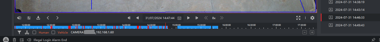

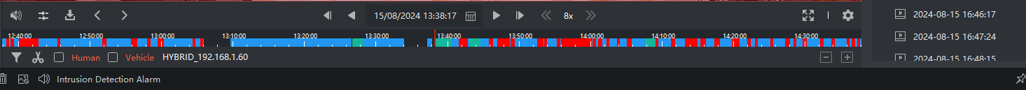

This is my Motion Detection VCA search after installing v5.7.17
Until 14:50 on timeline is v5.7.15 and from 15:00 and afterwards this is v5.7.17. No VCA search events at all.
There is no way for me to fix

No, I went back to 5.7.15 once again. Seems that I am one of the few users of Playback by Rules. I do not use Search tab option and playback without the Rules option gives marks out of time on timeline. So this Rules option was the best at least for me and my NXI-K NVR. As I said before, maybe other NVR do not have this issue. I really want the 5.7.17 but I cannot use this

Tested, by making a mistake on ip, for both ColorVu. The Hybrid one and the non-Hybrid. DS-2CD2047G2H-LIU and DS-2CD2047G2L.
For both of them there are once again no results in By Rules Motion Search on my DS-7608NXI-K2(drawing search grid boxes).
Everything else works fine and also all motion events that are recorded as separate clips, found on search NVR tab, previously set so in Settings by selecting Notify Surveillance Center and upload to SD card.
Intelligent option is enabled for both of them too.
Had an issue that caused an hour of mess, which was an not at all VCA mode enabled(was disabled) and by enabling by mistake the By NVR option then the NVR was stuck. Has never been stuck before. So powered OFF(by switch), reboot, then everything seemed OK but could not access Settings for one of the cameras by iVMS4200 or by Hitoolsdelivery. The only way to access settings was the Batch Configuration tool so with that I went back to 5.7.15, where everything is fine again.
Possibly, the reason for By Rules Motion search VCA issue, is the Intelligent Search enabling. This does not want VCA by NVR enabled and possibly this does not want Motion VCA search by Rules.

Yes, but the issue that arose after v5.7.17 seems to be related with the Dual VCA and/or Save Camera VCA Data, which has to do with the NVR ability to record/mark the VCA Events on timeline by drawing a box or grid(by rules).
