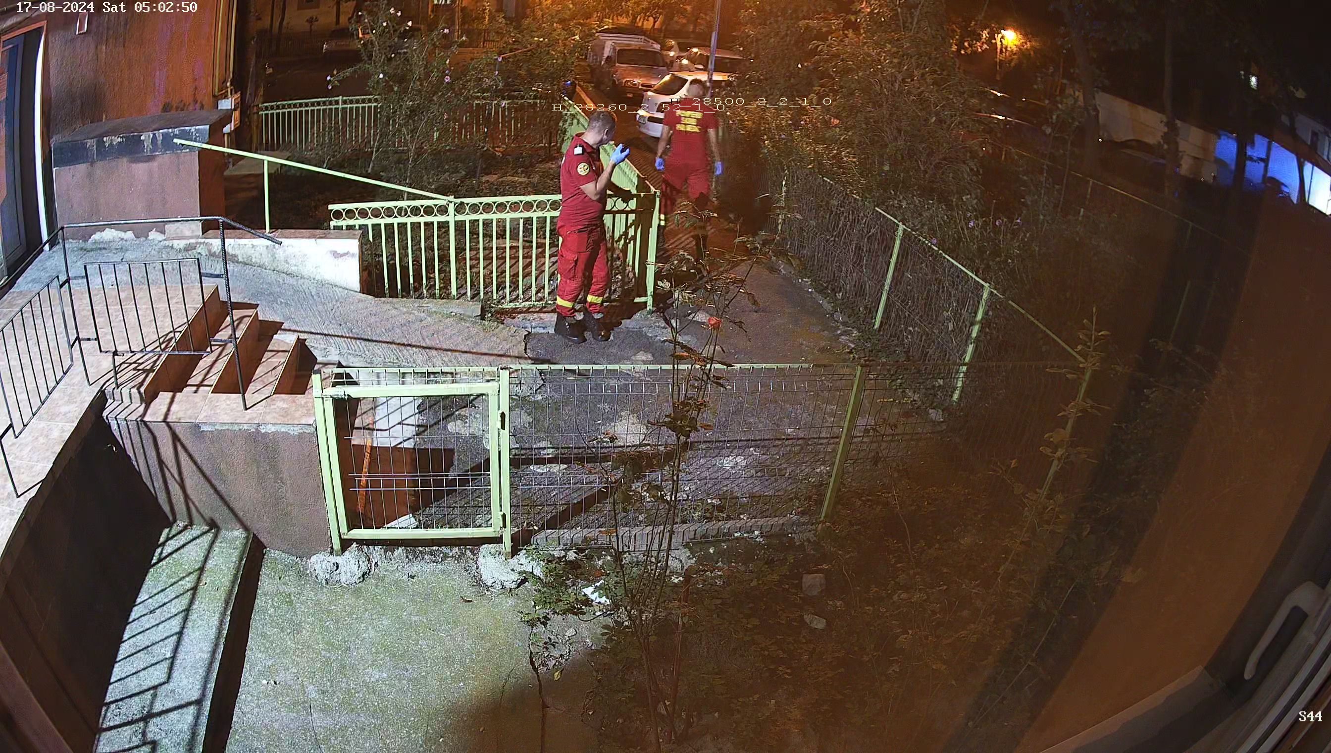

And in version V5.7.17_240731, strange codes appear when someone enters the camera's range. What are these strange codes, does anyone know? They started appearing in version V5.7.17.
They've been there for a while so it depends which version you updated from. If you turn off the Display VCA Info/Rules they'll disappear. It's something to do with AcuSense metadata though not sure why they chose to leave it visible or whether it is unintended.
