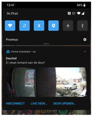

i already do that know, with ISAPI i check the callstatus => when someone presses the doorbell , i send an Push notification
in that push notifictaion , i have captured a image from RTSP
and defined 3 actions
Hikconnect => opens Hikconnect if needed
Live View => opens the RTSP stream
Deur openen => opens the doir with ISAPI
my plan is to change the Hikconnect action , and change the code to start two way audio with ISAPI
