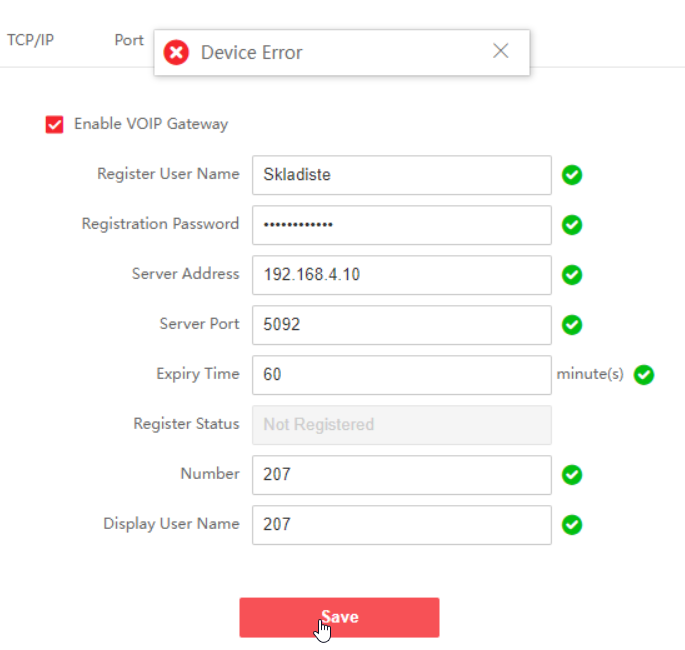

having problems with KD8003-IME1 fw v2.2.52.
I enter all right config into VOIP gateway but always get "Device error".
Same config worked in fw 2.0.8.
I'm using FreePBX.
Any advise. I did factory default few times, can't downgrade to older version.
latest version from beginning, 3.7.0.5.

have try sadp tool? my guess its just an "saving" bug , i think its coming from a combination between ivms and device
Didn't try it, how could i enter SIP parameters trought SADP?
