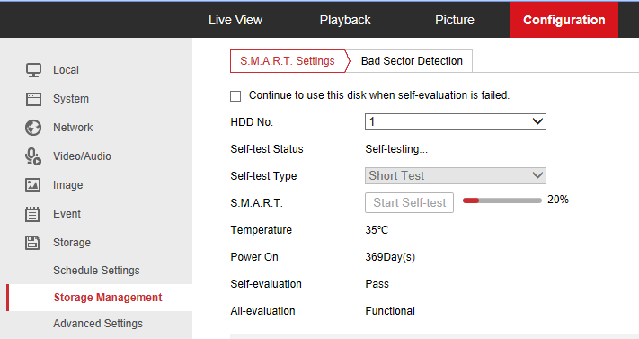

That's probably not a good sign, it should progress through the test like this:
When you say "it's been unplugged" - just unplugging the DVR from the mains should not cause an HDD failure.
It is worth trying the classic 'switch it off, wait a minute, then switch it on again'.
If it still fails to see / test your HDD then you probably need to replace the HDD - and/or speak to your supplier/installer if it is still in warranty (normally that's 3 years for HDDs).
