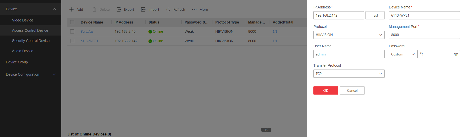

It worked only after changing Transfer protocol to TCP

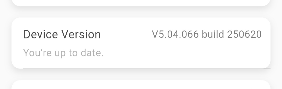

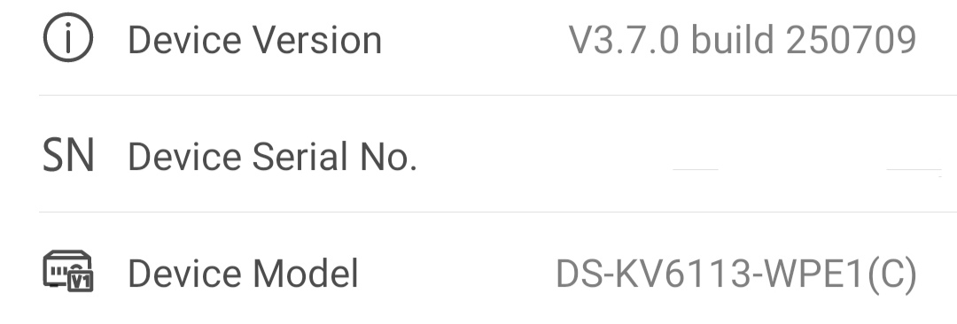

Try it, it should work, we are both on same firmwares now
View attachment 13053View attachment 13054

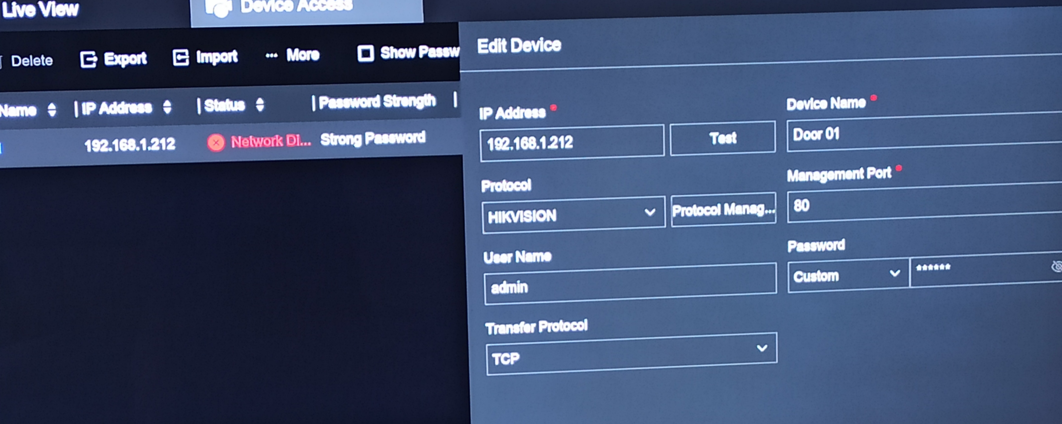

Mine is already set to TCP.
But I tried flipping to UDP and back to TCP (with port 80 and 8000). Still no joy. Ofcourse tried reboot of the NVR too.
Don't mind blurry photo but you can see same settings as you trempa. I'm stumped.
