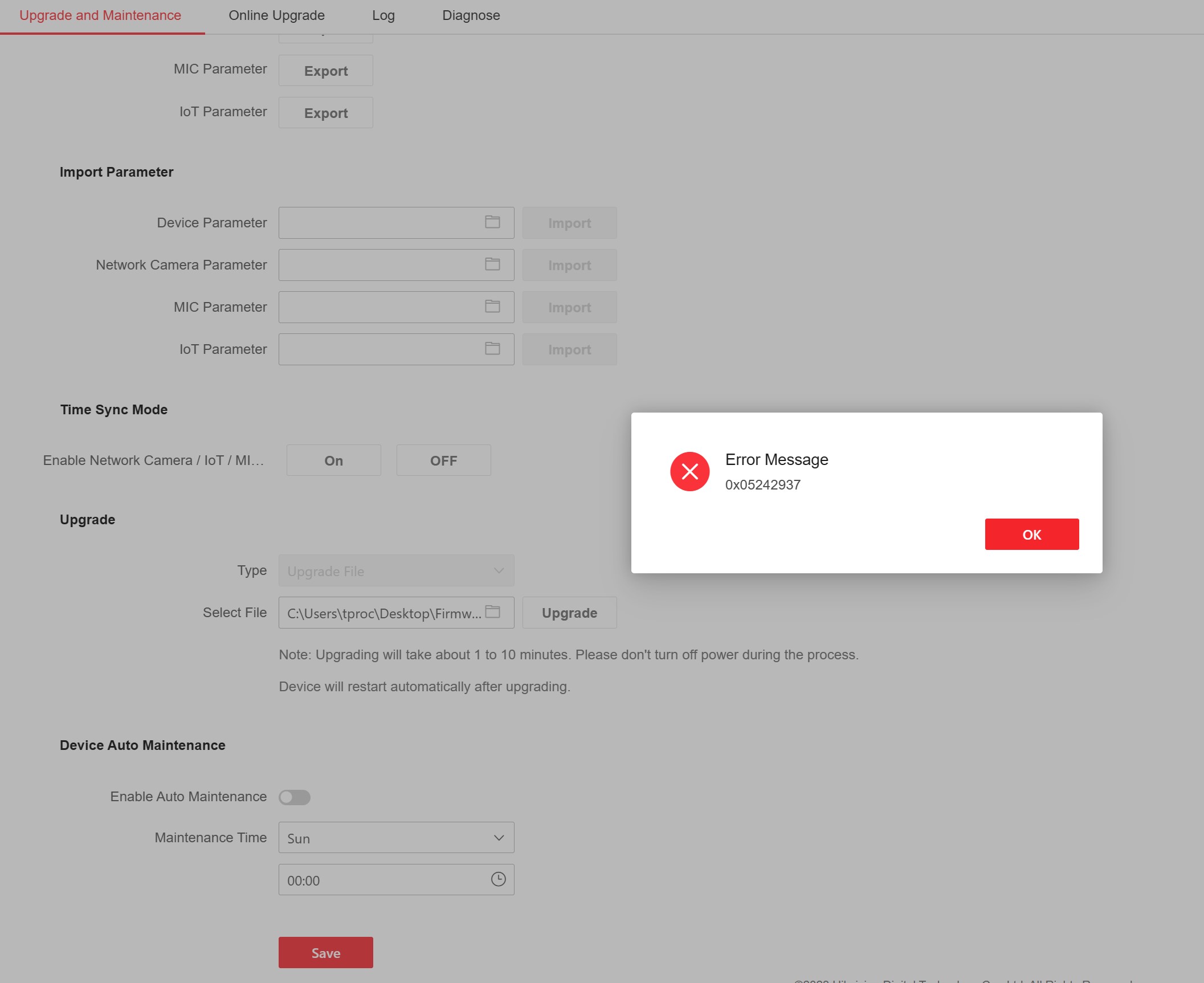

Hope you have better luck than me trying to instal it. :(
Ahh yeah, just noticed the build numbers slightly different
