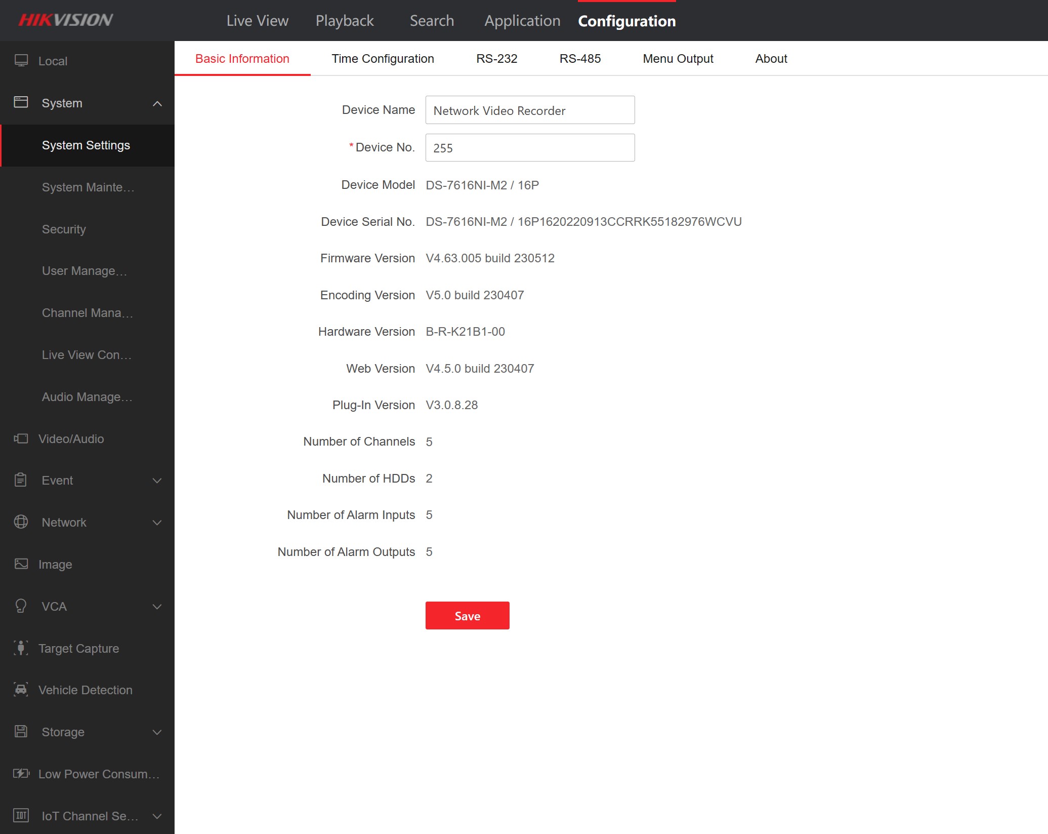

I've just loaded 4.63.005 now. Unlike the patch version I was sent I've got pictures as opposed to black screens, so that's a start!

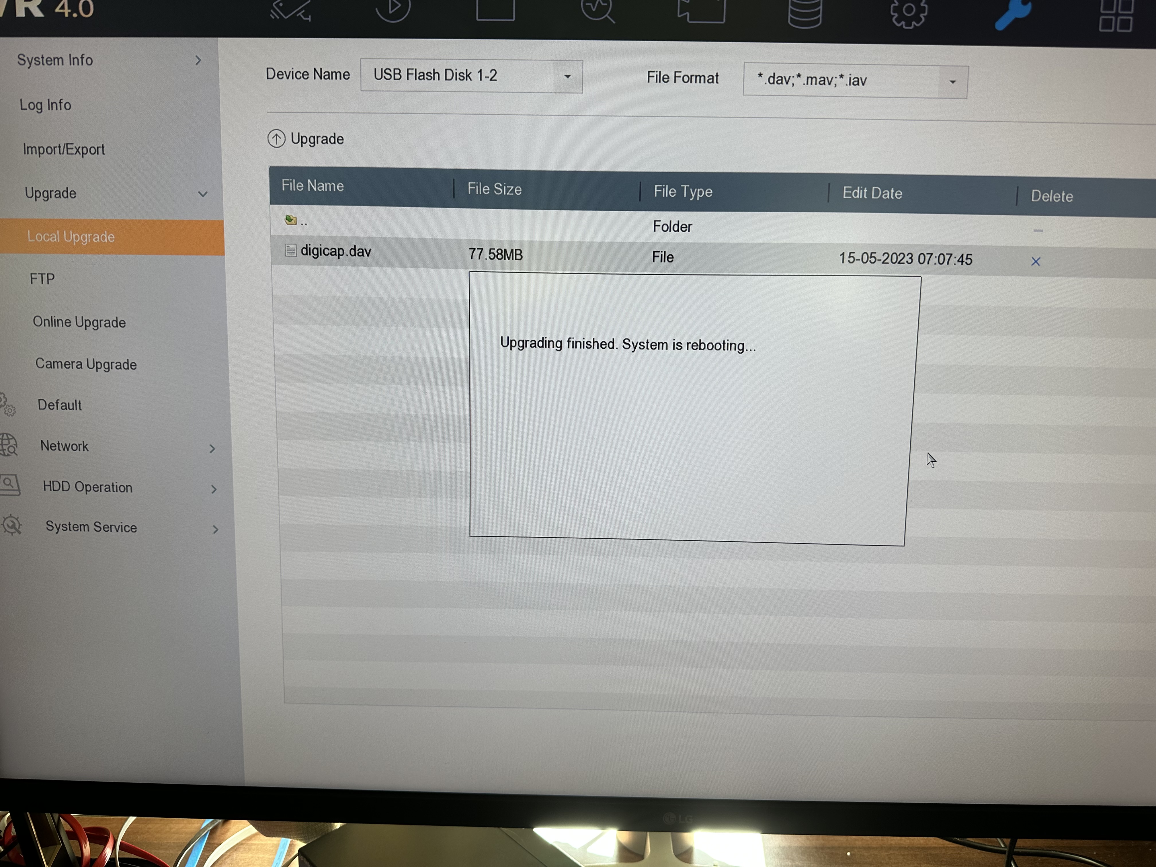

File is digicap.dav
Version DS-7616NI-M2/16P
Still refusing to pass 61% when uploading.
Any ideas anyone.??
I'd probably try a full Shutdown rather than reboot. From the local interface use the icon in the top right corner and 'Shutdown'. Wait for the message to power down then do that - power it down completely. Wait a couple of minutes then apply power again. Wait for the system to fully boot and all cameras to come back online before attempting the firmware update again.
Maybe something is being retained from your previous failed attempt at upgrade that'll get cleared with a full power down. Worth a try....
SUCCESS.!!!! :)
Thank you so much for that advise, I did try a "Re-Boot" but would still not work but a "Full Shutdown" did the trick.
Latest firmware installed and now getting the preview in areas that wasn't displayed before same as you guy's..
Again thanks very much. Great tip worth remembering. ;)

SUCCESS.!!!! :)
I'm guessing that the previous attempt where it didn't work possibly held that file in the memory and the power down dumped it leaving room to load the file again. Glad you got it sorted.
