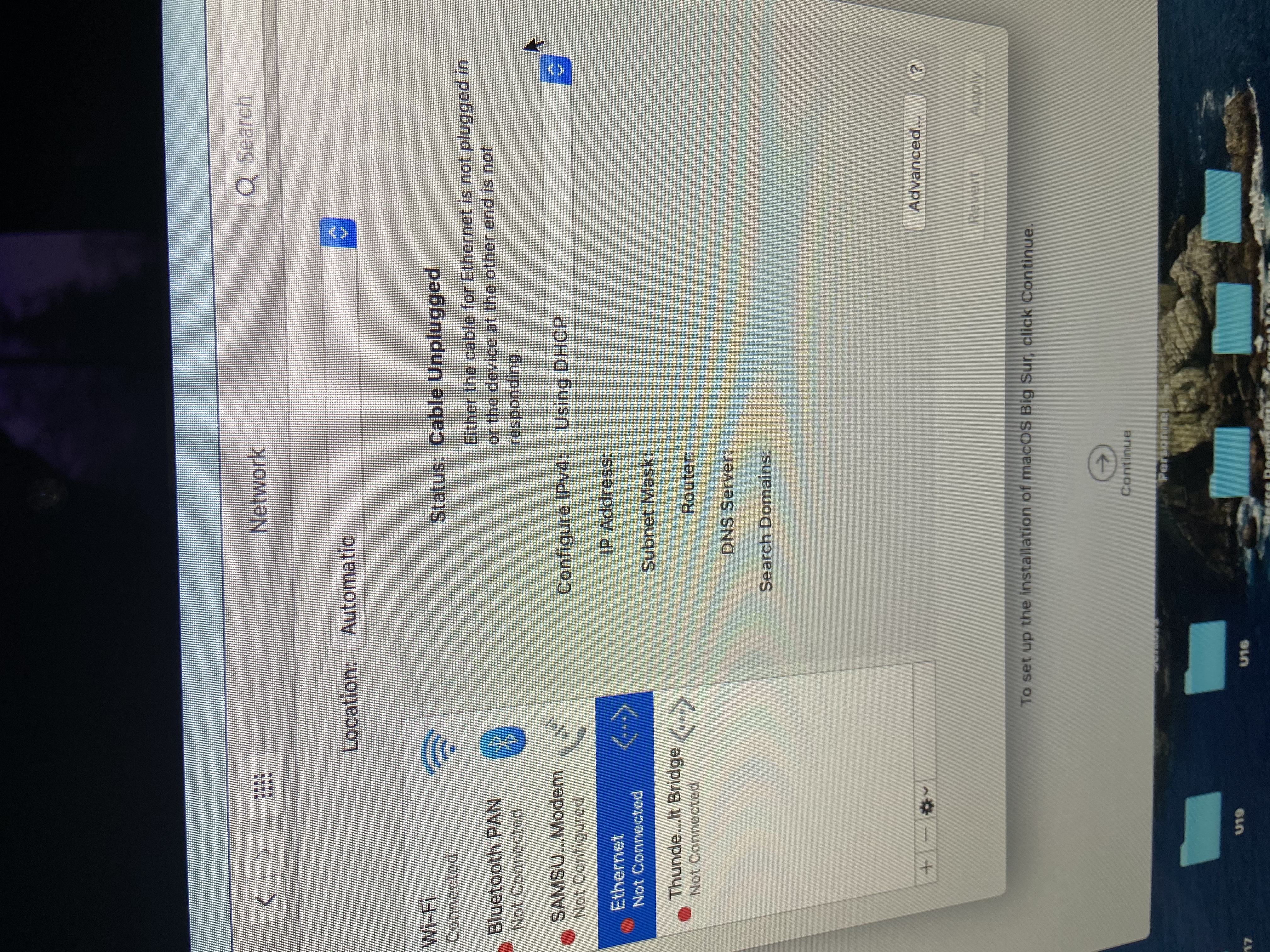

I managed to angle the Mac to the the cable and it’s not showing as connected
sorry the quality of the picture isn’t best ever, so it looks like the fault is with the Ethernet cable? My neighbour has a 10m Ethernet cable but I’m not sure I’ll need that now to test the line? I’m guessing I’ll need the installers back out to replace the cable!?

It doesn’t look like it’s connected. So I assume the fault is with the cable? When I plugged the cable into the iMac it showed as below
Is it now a case of replacement cable rather than trying the steps you suggested??
What i would do is use your neigbours cable to see when connected that your nvr comes back to live and that your issue is resolved. Then you can replace that cable that isn’t working. We know the cable isn’t good, but you want to know that the issue is not at your router. So if possible remove the cableconnector from the same routerport and with the neighbour cable connect it to same port and the nvr and see if the problem goes away
if all is fine afterwards then the old cable can be still used, if the connectors are being removed and renewed and tested.
