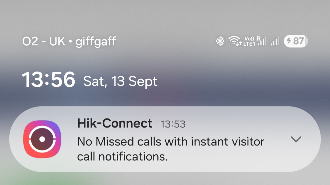

Thanks JB
This is disabled but notification appears just when opening app
