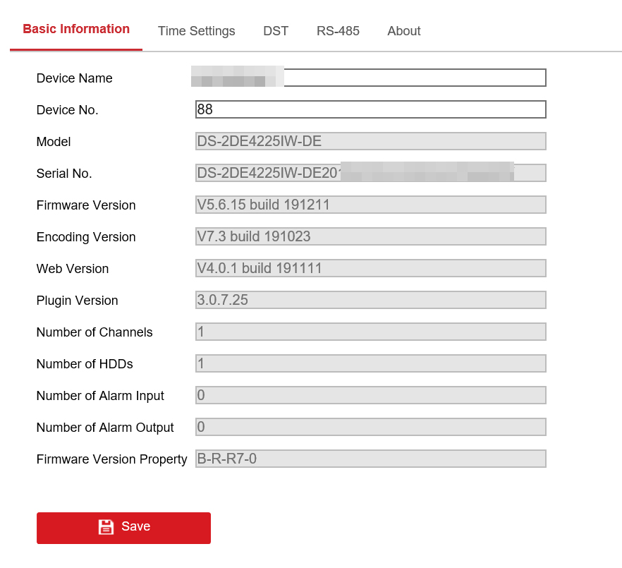

i updated the firmware of my ptz hikvision camera and the iexplorer's plugin too ( i never managed to make the ivms to work), but the stream is very slow, when i move the camera (from my pc connected to the same subnet and network) it goes very slowly. The same is happening if i try to move it through the hikvision nvr. Is like watching the main stream through a 2g connection. Is there any way to downgrade to the previous firmware? Thank you
Hi @epp289
What is the PTZ model you have?
What firmware version is it currently running?
Thanks @epp289
Do you know what firmware version you were on before updating to v5.6.15?
Ok, did you update to v5.6.11 before going to v5.6.15 or did you just upgrade to the latest in one jump?
If you went straight to v5.6.15 then I would recommend that you downgrade to v5.6.11 before then updating again to the latest version.
If you look in R7 Firmware Folder at the Hikvision download portal you will see a line of text at the bottom that says users with firmware before v5.6.11 must update to v5.6.11 before updating to any higher firmware, skipping this firmware may be why you are seeing performance problems from the camera.
i did upgraded to v5.6.11 first and then to the V5.6.15
You can see the stream from the camera is not so bad, but if you want to move it, it takes 3-4 seconds. Is like having 10+ computers watching simultaneously its main stream. The settings i see that they have remained the same
Is there any other way to fix it?
If you are now running older firmware and still the PTZ function is slow then all I can recommend is you try to adjust the PTZ speed slider from the control menu on the right of the screen and if that doesn't work then the only other things to try would be to reboot the camera and if no improvement then finally you can factory reset the camera and set it up from scratch.
