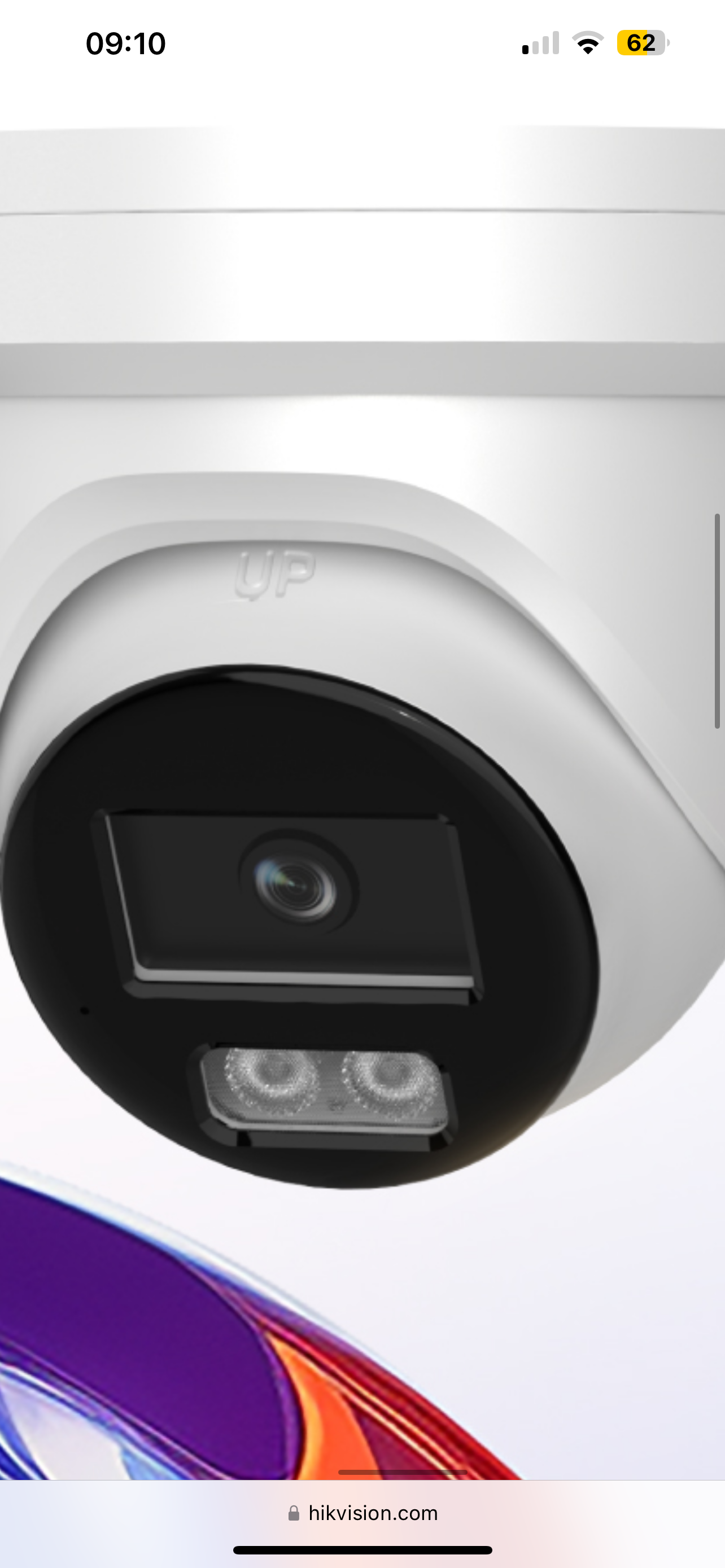

Interestingly the colorvu turret looks to have a tiny sensor. One of the first things I noticed when unboxing the hybrid was the lens looked really small. I assumed it was newer technology…
This may just be marketing material that’s inaccurate but I’m not so sure.
Obviously I don’t know if that’s a 4mp or 4k etc… but it’s not a good sign
I’m not sure what you are looking at? The sensor size is in the specs; it sits behind the lens so you cannot see it in a photo. Currently they use a 16mm lens sat over that 1/1.8” sensor.
I’d not seen the specs yet. Ok so it’s using the same sensor size as the hybrid cameras. That’s a shame
