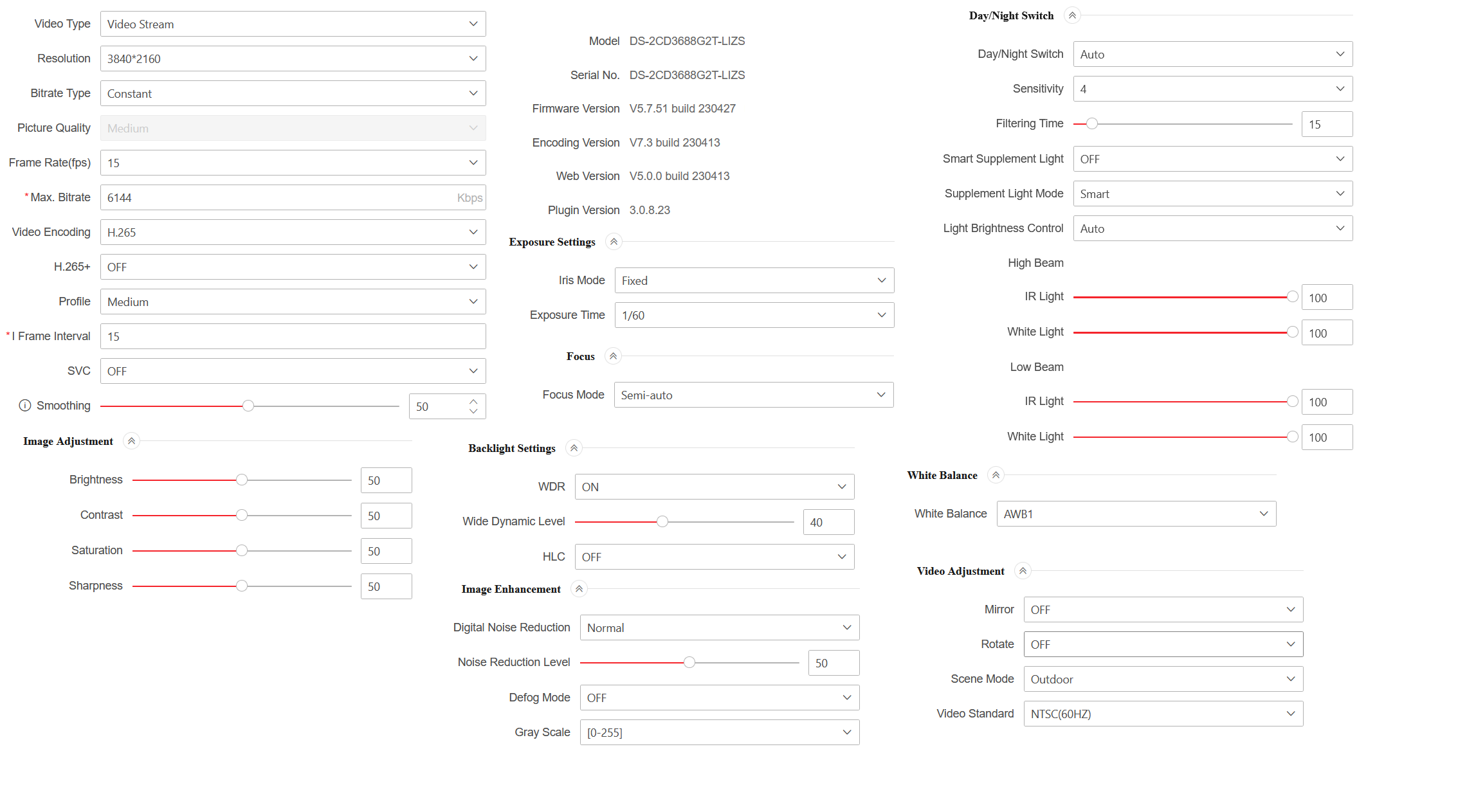

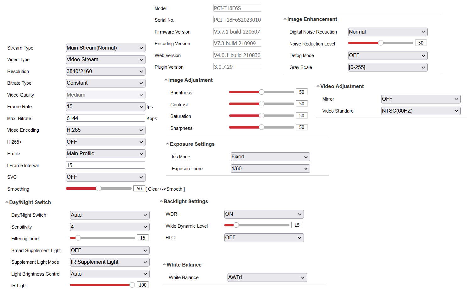

just posting a night video of PCI-T18F6S and DS-2CD3688G2T-LIZS (not sure what would be the equivalent around you)
first half is PCI-T18F6S
second half is DS-2CD3688G2T-LIZS
4k recording, 15 fps
keep in mind that to cut the video i did post processing and youtube did it own post processing, it's not the original video
there is two layer of video quality downgrade

if interested, here is the settings for both

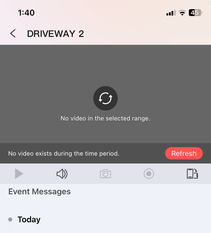

@JB1970, Sorry to ask question , i changed my line cross area in NVR, and when come to mobile app , it comes up video notification " no video in the selected range" not sure what`s going on? other areas setting remain unchanged.
thanks

Your photo is cropped so I can’t see where you are in the Hik-Connect app. The error means there is no matching event at that time. For instance in normal playback if I select a day then click ‘Vehicle’ I might see that (as I don’t use the Vehicle option in my setup). You may also see it if a video clip from an event has not yet been uploaded to Hik-Connect.

the photo is under notification then click the video clip, each time when click into it , it says "no video in the selected range " &" no video exists during the time period" regardless how i refresh. any idea where i can check and fix it . tnx

under the linkage action , i tick" notify surveillance center" " alarm output linkage" and specific camera.

I've not seen that before. Try the usual - log out of Hik-Connect in the app and fully close it before reopening it and logging in again. Disable and re-enable Hik-Connect on the NVR. Also ensure that your NVR and cameras times are synchronised.
