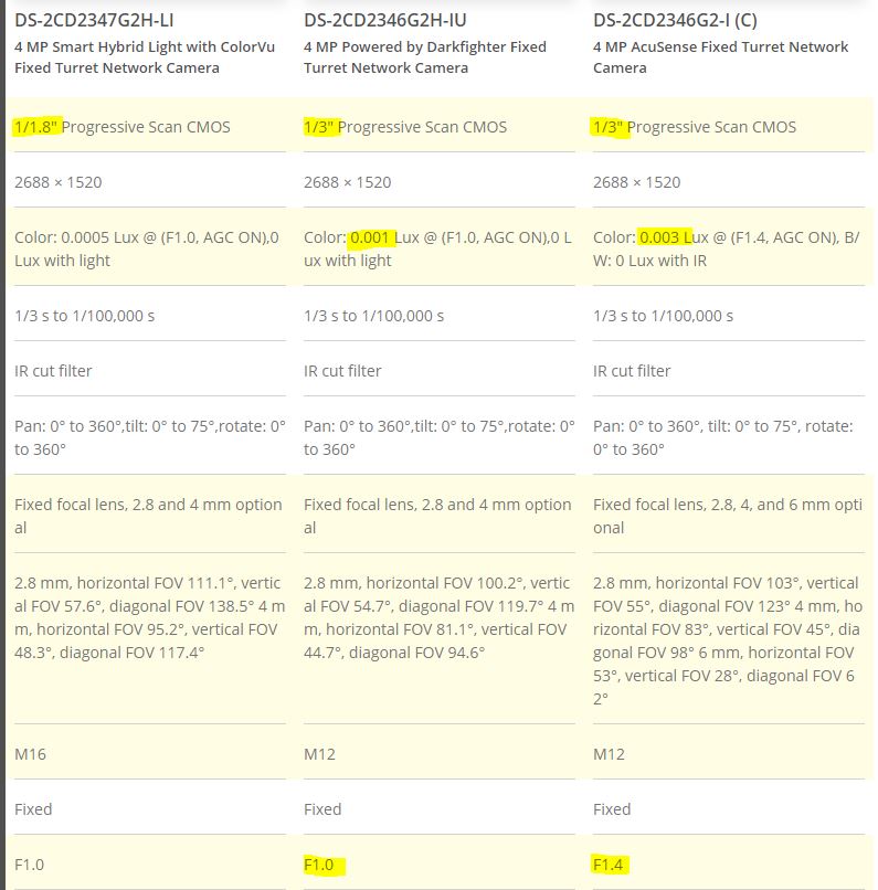

I think maybe all G2H cameras have hybrid light, just that the sensor would be different for ColorVu. Was looking at pics of G2H Darkfighter and the LED cover now looks same as ColorVu Smart Hybrid. So maybe they just haven't updated the website to reflect Smart Hybrid light yet, considering they just launched the product.
Maybe just incorrect images. The data sheets (and the last part of the model codes) indicate infra red only. Adding white LED to it (the DS-2CD2386G2H-IU) would effectively make it the same as the DS-2CD2387G2H-LIU that we already have in the UK....
Compared the specs and it looks like G2H Darkfighter is Improved version of Darkfighter G2 with better low-light performance, but not as good as ColorVu. You're right about Hybrid Light, its not going to be there, if it were then we'll see both L & I in model name e.g. LIU instead of just IU.
As per specs, its aperture is F1.0 vs F1.4 in current Darkfighter, so should have slightly better low-light performance.
Hi @LoinKing @JB1970
To bring this to a close, I asked Hikvision UK support to confirm what they know about these AcuSense G2H models and what the "H" refers to.
Their response was that in the UK/EU market, the H will only refer to Hybrid Light and that these 2xx6G2H models are on the Global site and will not be coming to the UK market.
Although they did not specifically state it, I think we can take from the above that the 2xx6G2H models are not Hybrid Light and it is just a case of the "H" being used to denote different features in different global regions.
