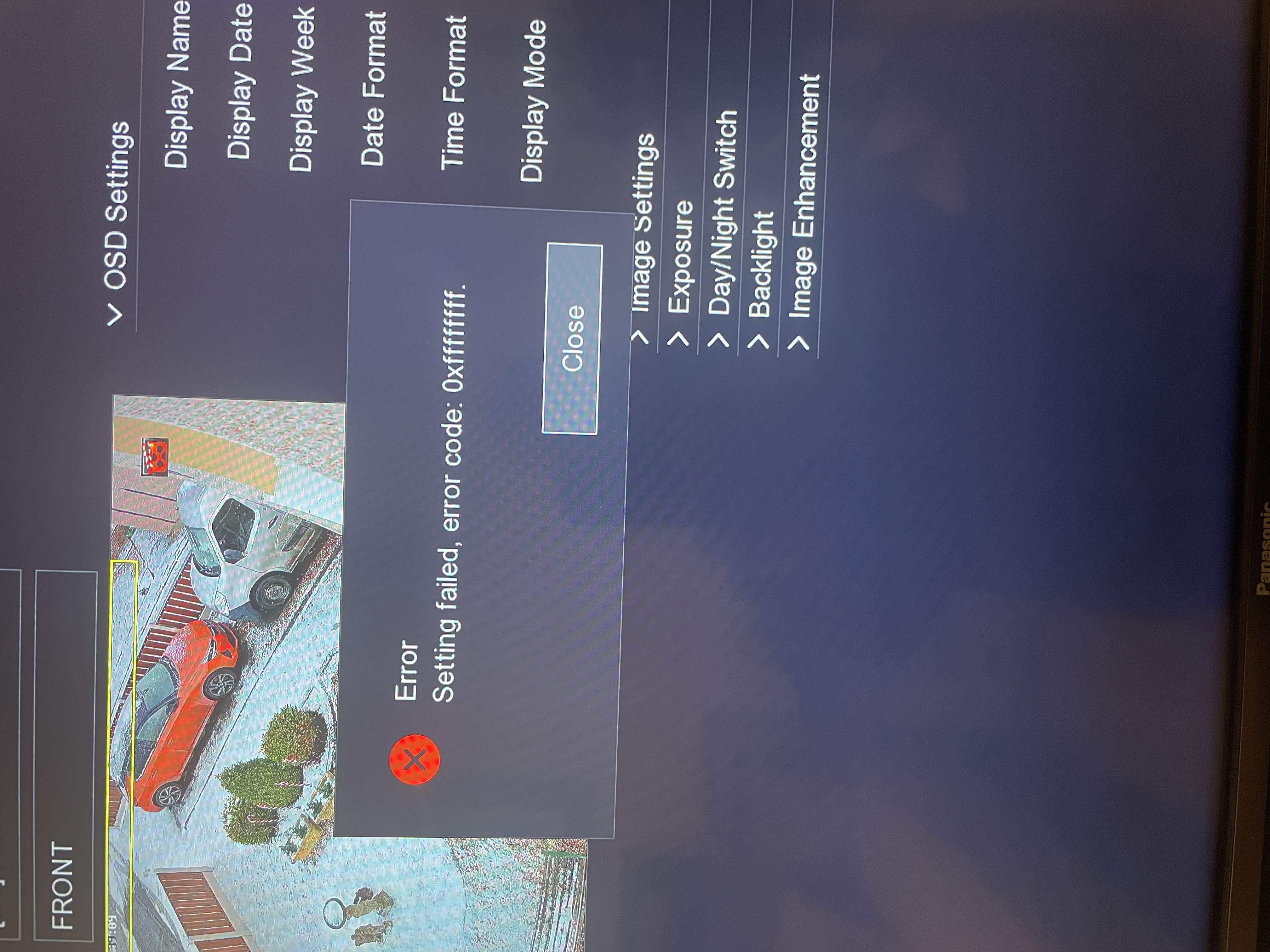

I am getting a setting failed error code on 2 of my camera 8mp after playing about trying to get the best settings.
One is a colourvue and one a dark fighter.
I now can’t alter any setting in display such as brightness or anything on that screen.
It’s a ds 7600 series nvr with latest firmware.
No issue with doing any other settings at all, only under ‘display’.
Cctv chap suggested I need to hard reset the cameras, any advice on another solution.
Error is ‘ setting failed error code oxfffffff
JimView attachment 8552
This may be late for Jim, though hopefully, anyone else getting this error will have it solved faster (the upgrades were a great shout). The trigger I found was in the WDR setting. Switching this on via the NVR would flag the error code 0xfffffff.
