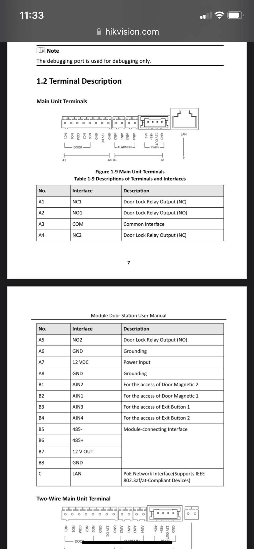

I have attached the hikvision terminals, I have been told by the gate manufacturer that it will open the gate using No&COM, however they say they are unsure if the hikvision intercom will close the gate (obviously auto close would close it after 60/90 sec)

Looking at that, the connections in the main unit - A1 to A3 and A4 to A6 are volt free changeover contacts IE A2 and A3 (NO1 and COM) are open circuit going close when activated (from the indoor unit). So A2 and A3 would connect to the open terminal and common ground terminal on the gate control board. If it's the Two-Wire main unit, the left side No1 and Com will perform the same way.
