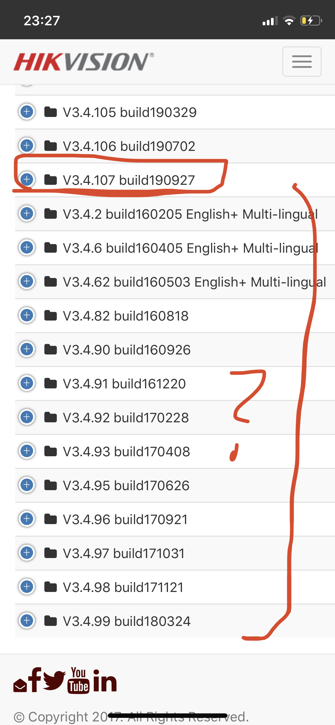

I’m on the same version on my 7608NI-K2 - did you not need to apply any interim updates as there seem to be lots on the HIK portal. Do you have a direct link to the firmware you installed? Thanks!
