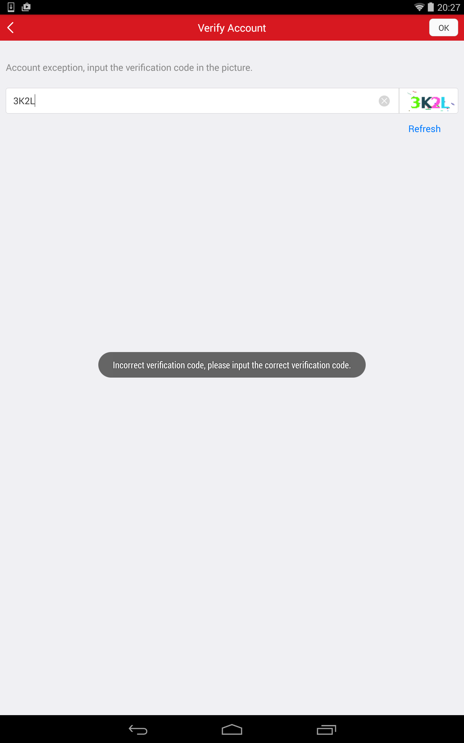

I've been using either app for long time no issues but yesterday on 2 android devices I'm now asked to enter an account verification code ( 4 figure code ) and it will not accept. You can refresh the picture to get a new code but keeps saying incorrect , I've tried upper and lower case to no avail ! ?????
Did you try to remove the two devices
Did you try to login on ezvizlife.com in Explorer and try it there? And just to be sure: you aren't mixing up verfication code of the camera with the code voor the EVIZ account itself? (Because via the app you can only type the first one....)
No I didnt try to remove them I hadn't made any changes . strangely trying 10-12 attempts at the 4 figure verification it finely accepted but again today after 6 hours of working its gone back to enter verification.!
Screen grab below and I'm accessing a NVR not camera directly

I face the same problem with leecavturbo. From android devices with ezviz application ask me for verification code and i type the code of the figure correctly but it doesn't accept it many times continuously and appears the message "incorrect verification code, please input the correct verification code". Have you any ideas? Is a problem of my account?
