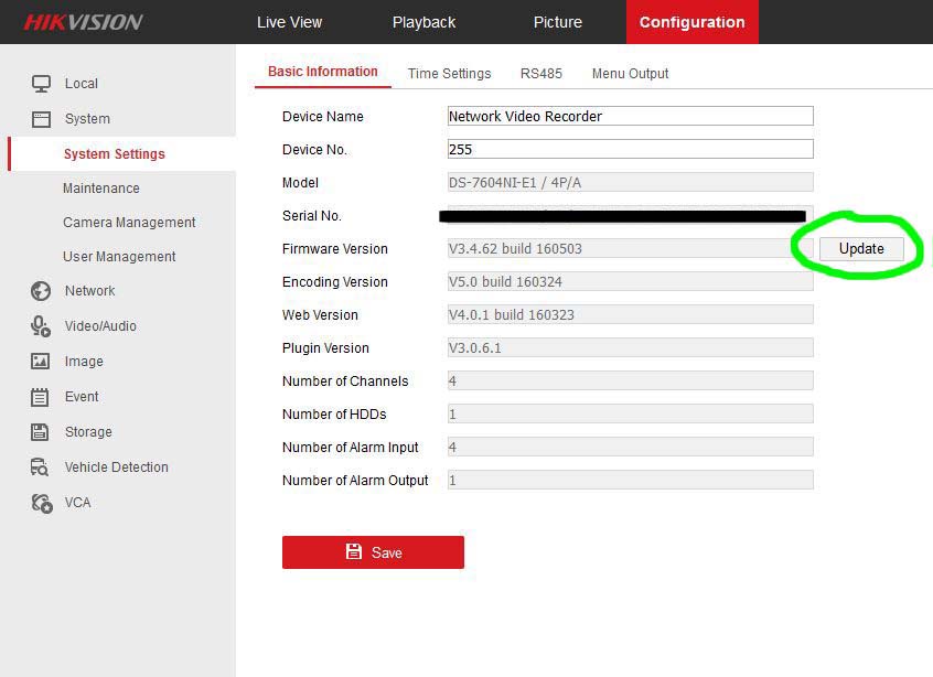

I am asking if anyone would be kind enough to help me update the firmware on my Hikvision CCTV system please ? I think I know how to do it but don't want to crash the system and so I thought I would ask that if I undertake the following procedures the update would be successful. I operate the system from my Windows 8.1 64bit desktop.
My Hikvision NVR is a DS-7604NI-E1-4P (or at least that is what is written on my purchase invoice dated 01/12/2016) When I look in Device Management>Server it is slightly different i.e. DS-7604NI-E1/4P/A On the same screen I am told that the Firmware Version is V3.4.62build 160503. It has never been updated since the purchase.
I have been advised by my supplier that the most recent firmware update is available here as a zip file :
HIKVISION UK PORTAL
Am I correct in thinking that I need to undertake the following procedures ?
1. For convenience create a brand new folder on my pc.
2. Download the zip file into that folder and unzip it.
3. Log into my NVR using the IP address.
4. Take the Configuration option as shown in the image below (Serial No. hidden in case there might be a security issue if it is shown)
5. And then take the "Update" option as outlined in green. I presume that if I do this then I will be asked where the unzipped firmware update is and proceed accordingly.
Thanks to anyone in advance if they can tell me if my planned procedure is the correct one.

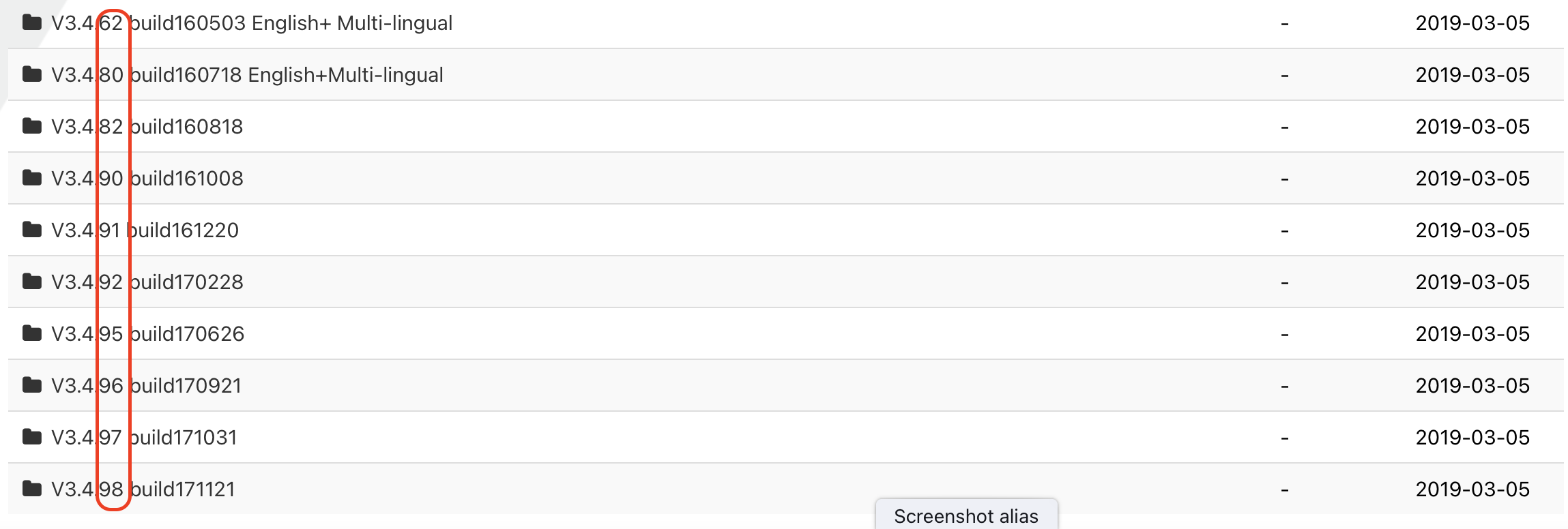

Thank you. When you say that there is a big difference between what I am using now and the current version what exactly do you mean ? Os it a difference in interface or just a lot more options ? i.e. Would there be a huge learning curve ? I think I will try and go to the next version up from mine initially just to see that I can do it.
I am talking about the last 2 digits in the firmware number (not the build date). You are going from .62 to .98 there should only be minor changes between each firmware update. Some of these updates could include security fixes which you must do. That is why you need each one.
I don't think there will be a big difference, or learning curve, to the user interface.
Do V3.4.80 first and see what its like.

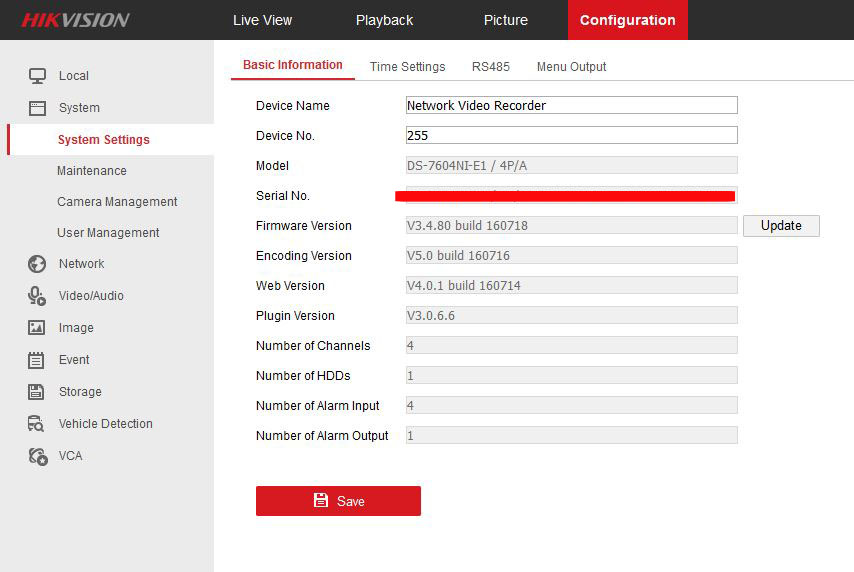

You will not believe this ! But due to your help, patience, and good nature I have successfully updated the firmware on my NVR. I did it with a Fat32 formatted memory stick that contained the digicap.dav file and nothing else and then inserted it into the rear of my NVR. I then went through your very clear and helpful instructions of getting into the Menu>Maintenance>Upgrade section on my standalone monitor and the NVR found the file and I went through the upgrade process. Heart skipped a few beats when the system was re-booting but we got there in the end.
Can't thank you enough and if you're ever in Warwickshire let me know and I'll buy you a drink or three.
Upvote 0

@scooby73466 Here are the last two NVR updates. Whilst I was checking the firmware for your NVR I realised mine was out of date so I updated it.
Are your cameras connected direct to your NVR?
Like the NVR firmware updates improve security and functionality, you can leave it for a later date.
So could you confirm for me please that I should update from V3.4.82 build 160818 (I have already updated to V3.4.80 as you know) from this link DOWNLOAD EU PORTAL and then when I have done that, one at a time, I should update the two that are contained in the link that you have sent me in your last post ? i.e. HIKVISION UK PORTAL and that when I have done that then my NVR firmware will be up to date ?
If that is correct then I will have a total of 10 NVR firmware updates to do because I am going to do them individually and not jump any as advised by you earlier. Apologies if I am being a bit nerdy but although I grew up at the DOS prompt 36 years ago I am now mid-70s and I have to make doubly sure that when I am going through anything technical these days that I check and double check.
