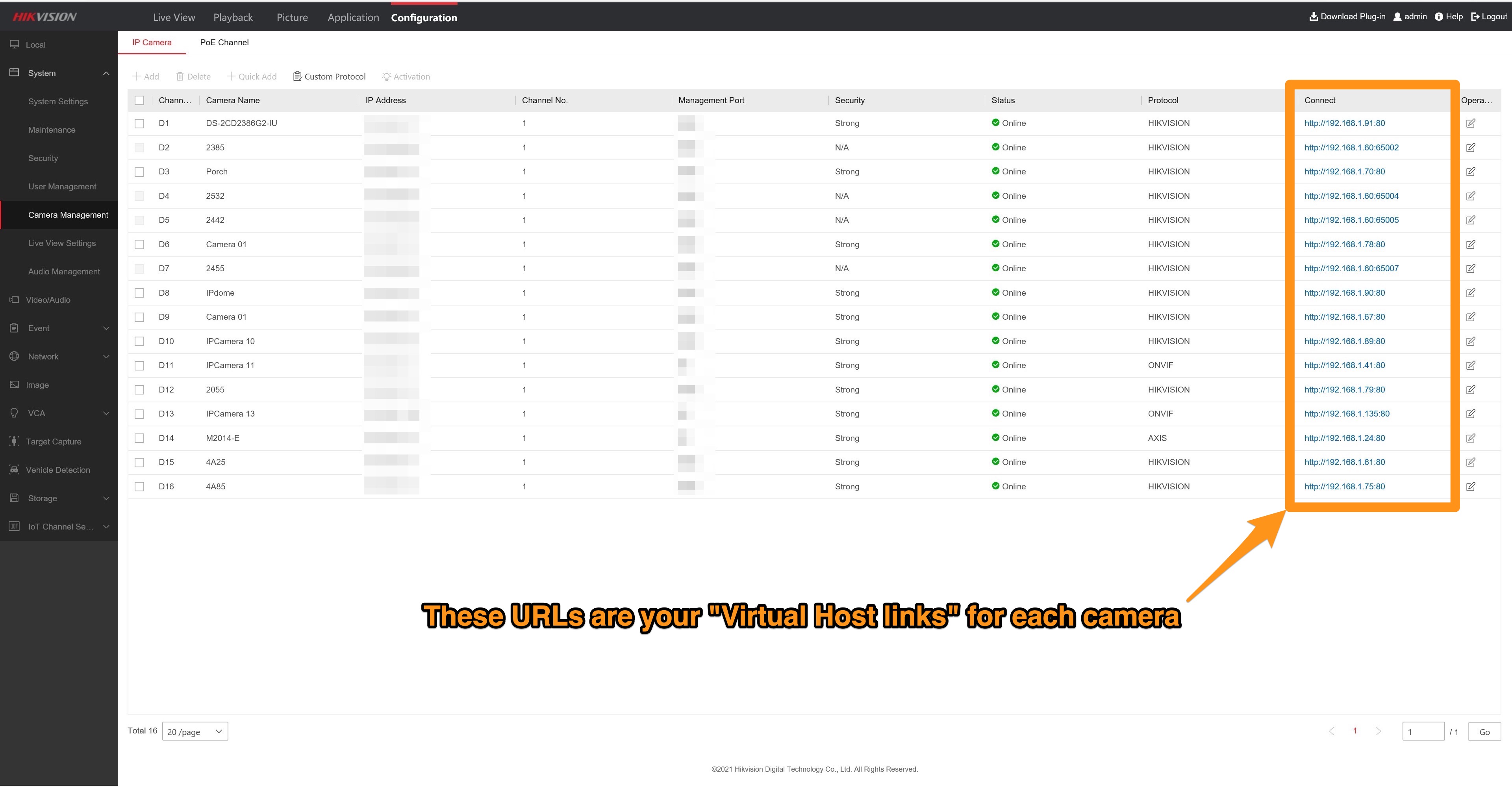

Configuration System Camera Management
This screen displays all the connected cameras on your NVR. Notice that the final column labelled "Connect" is currently empty. We'll be coming back here in a moment.

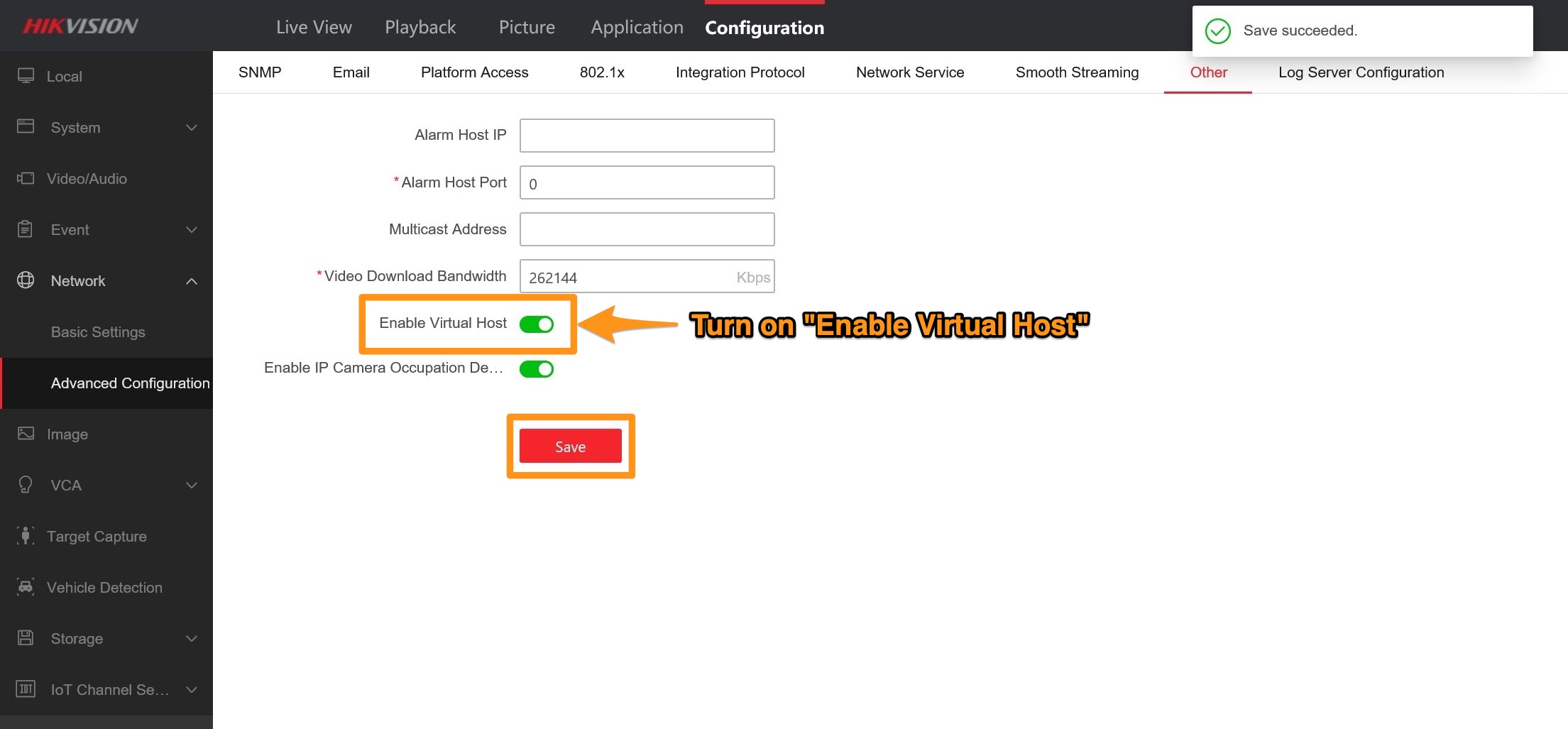

Network Advanced Settings Other
Turn on the Enable Virtual Host option.
Note - Your NVR will reboot when you click "Save".

Now, navigate back to the Camera Management window from earlier. You'll notice that the previously empty connect tab now features links for each camera currently connected to your NVR.​

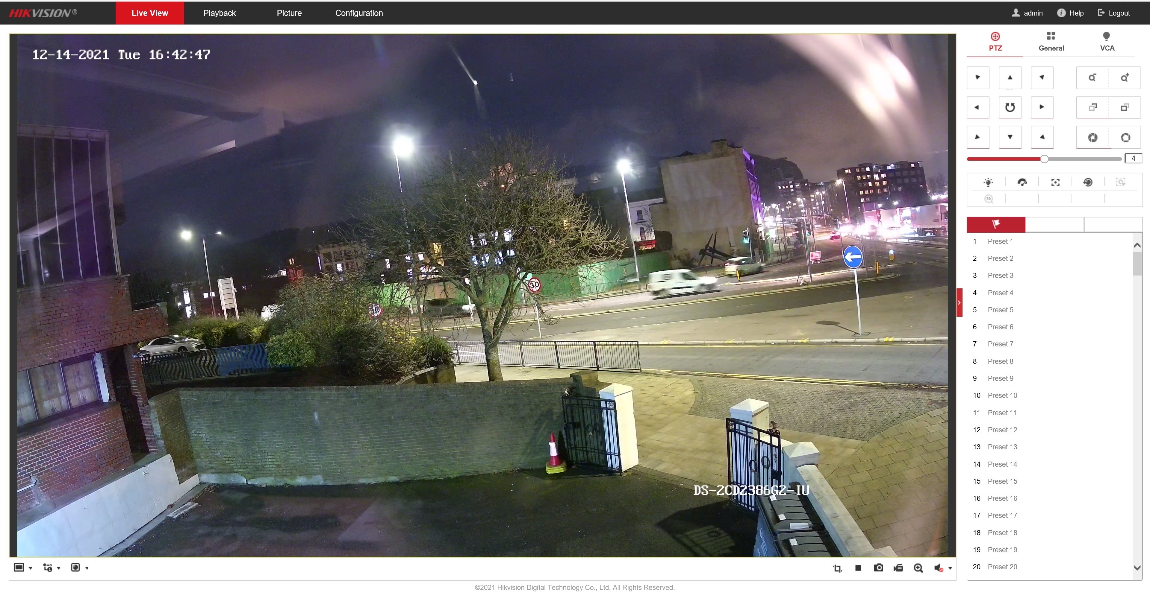

Click on any of these links to access the respective camera via your web browser:​
That's it, you're done!

Once you've logged in, navigate to Configuration --> System --> Camera Management
Now, navigate to Network --> Advanced Settings --> Other tab and make sure you tick the option "Enable Virtual Host"
NB - when you click 'Save' your NVR will reboot.
Simply click on any of these links to access the respective camera via your web browser.

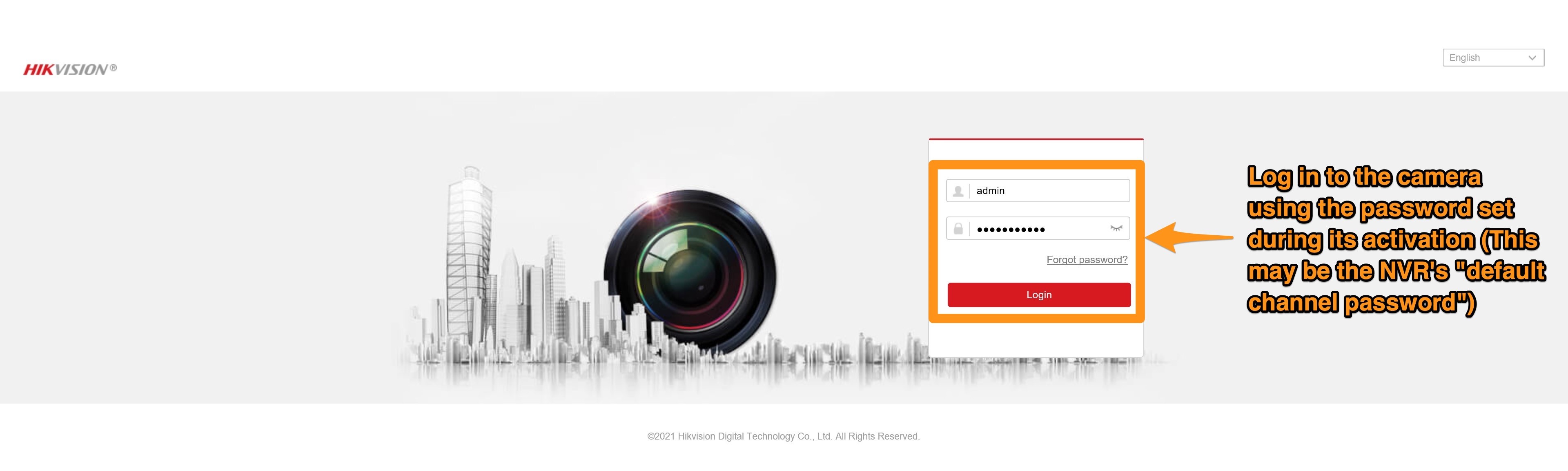

On my end all is fine, virtual hosts enabled and 650... ports working ok, however I'm unable to login into the cameras.
Cameras have been configured with plug and play on NVR, my assumption is that password would be the same as the NVR,
However I keep on getting the following error message: Incorrect user name or password. The device will be locked after X failed login attempts.
Could anyone please give me some pointers?
Thanks again :)
As standard, if your Hikvision cameras are direct-connected to the camera ports on your NVR, then the NVR will pass its user name and password to the cameras.

When I type in the IP address of my NVR, it takes me to the Hikvision site and I simply log in and then proceed to set up the 'Virtual Host' as per the instructions here and it all works perfectly. However, when I then click on the new IP Address of the camera, the system takes me to the log-in page again and it doesn't recognise the username/password. Can anyone explain this please?
Thank you
Did you set different user names and passwords for your cameras?
I have tried all of the passwords that I have used (only 2) in the process of setting everything up and none of them work. The strange thing is when I go into the Hikvision site the password works but after clicking on the 'Virtual' link it doesn't and neither does the other one.
