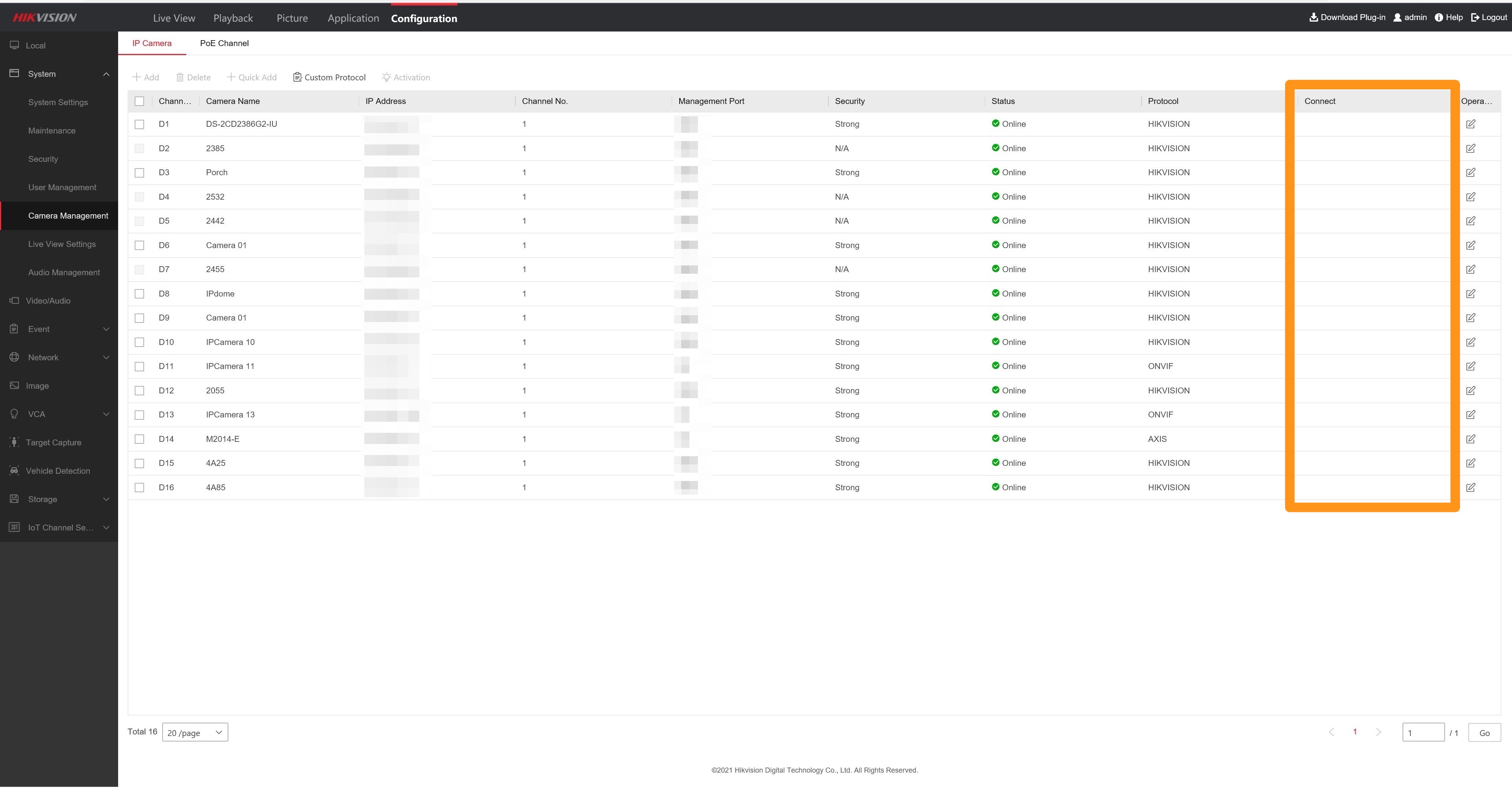

Configuration System Camera Management
This screen displays all the connected cameras on your NVR. Notice that the final column labelled "Connect" is currently empty. We'll be coming back here in a moment.

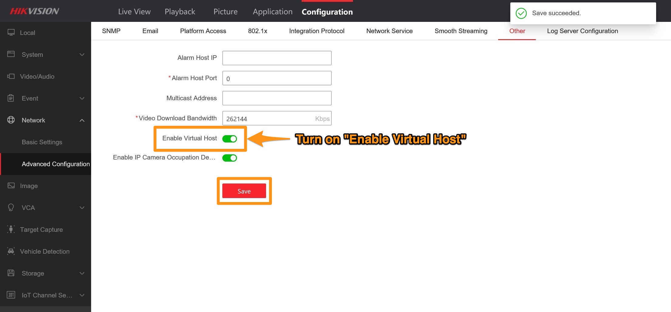

Now, navigate to:
Network Advanced Settings Other
Turn on the Enable Virtual Host option.
Note - Your NVR will reboot when you click "Save".
Step 4:
Now, navigate back to the Camera Management window from earlier. You'll notice that the previously empty connect tab now features links for each camera currently connected to your NVR.​

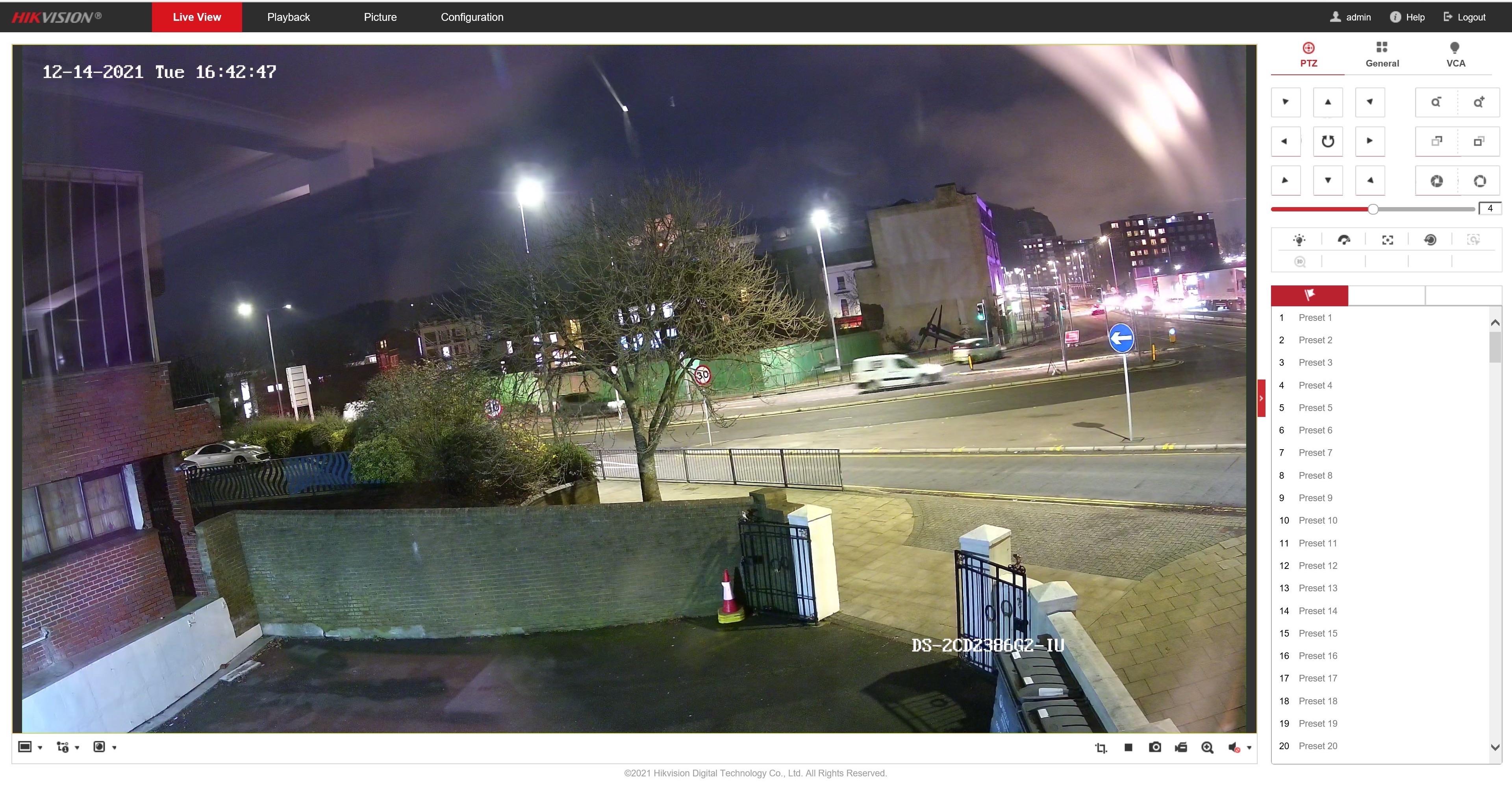

Step 5:​
Click on any of these links to access the respective camera via your web browser:​
That's it, you're done!

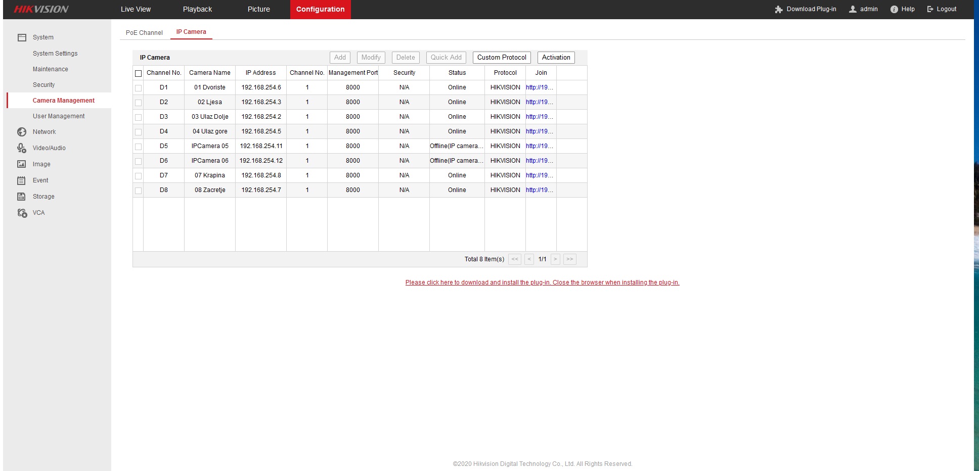

Can you share a screenshot of your NVR camera management page showing the Virtual Host links?
I have HIKVISION DS-7608NI-K1/8P (V4.30.010 build 200715)
Cameras that works are DS-2CD2327G1-L(U) (V5.6.5 build 200316)
Cameras that not works are DS-2CD1043G0 (V5.5.88 build 200317)
Ok, we have never sold/worked with the 1-series (1043G0) cameras, but seeing as these are the only ones not working and the fact that you are getting a 'not supported' error message I would think this probably means that those particular camera models do not support Virtual Host.
I am thinking the only way you will be able to login directly to these cameras will be to have them connected to a separate PoE switch and login to them with their individual IP addresses, unless someone else with more experience of these 1-series models can recommend another workaround.

Looking at the NVR internal IP allocation I suspect you may have some conflicts :
1. Ensure none of your cameras have "Enable HTTPS Browsing" if you're plugging them directly to NVR (I learned the hard way... e.g not realizing the Virtual Host is not forwarding HTTPS 443 port and there is nowhere mentioned that in the documentation - Hikvision should enable HTTPS protocol or not allow the user to enable such option while cameras are plugged to NVR directly. You will not be able to access cameras and you need to connect them to POE switch instead and use SADPTool if they are 192.168.254.x network to change them to your 192.168.1.X network then disable HTTPS browsing ) -
2. from your screenshot your internal NVR IPs start
D1 = 192.168.254.6
D2 = 192.168.254.3.....
They should be :
D1 = 192.168.254.2
I don't know if your cameras use DHCP or not, but I found it easier to use DHCP and let NVR to assign IPs directly.
I had this type of weird IPs last week as well and was scratching my head how to reset IP allocation to D1...D8 ports... I could also not able to access some cameras, since some used DHCP and some didn't. (i suspect using NVR direct access, NVR Web access and camera Web access not always work in same way.
Actually, Camera Web interface - Network > Basic Setting > TCP/IP - the DHCP checkbox is not remembered after the reboot - (I am using V5.5.160 ) - that seems to be a bug and likely. (allows me to mess up with DNS and IP after restart)
Still learning myself how to best configure it all. (not yet used iVMS4200))
Anyway to fix NVR IP allocation :
NVR > Config > Network > Basic Settings > TCP/IP > PoE Network Card Settings and change the internal network card from 192.168.254.1 to 192.168.253.1 save it and then revert back to 192.168.254.1
