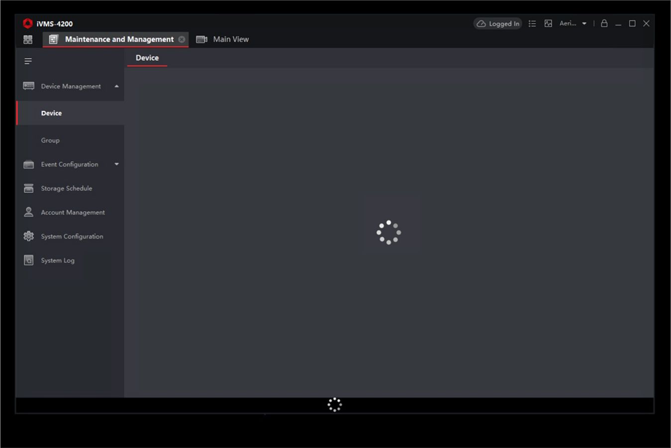

This has been ongoing for about 6 weeks now, ever since I purchased a new laptop with Windows 11 Home 64-bit Version installed.
I have another with Windows 10 Home 64-bit Version and there are no problems.
Like everybody I've scoured the internet for answers, and although some are experiencing the same problem, I haven't found an answer yet.
Once installed and I'm logged in, the program just hangs.

A small update from me.
I've been using IVMS Lite on my Windows 11 Home Laptop (IVMS 4200 hangs at trying to add a device) . but its rubbish. Even once it has actually bothered to start the lag is so severe that some cameras appear to frieze, they are fine on my desktop 11 Pro machine running IVMS 4200. The laptop is new and a good spec.
So, I decided to waste £120 on a Windows 11 upgrade from home to Pro - very quick and easy once I'd worked out how to buy the licence. Absolutely no change at all - yes I did try a restart and two older versions of IVMS 4200.
Its back to lite and looking for another CCTV system. Anyone have any suggestions I need 8 or 16 camera channels. I've emailed my supplier but I doubt they have any better ideas.

One suggestion I have is to try running iVMS 4200 in compatibility mode. Right-click on the program's shortcut, go to "Properties," and under the "Compatibility" tab, you can choose to run it in compatibility mode for Windows 10. This sometimes helps with compatibility problems.
Upvote 0
Hello VialeTordis
Thank you for your suggestion. I'm 99% sure that along the line somewhere I did try compatibility mode as well as running as administrator. No change.

With a bit of time on my hands this morning, I thought that I'd give iVMS4200 another go.
So I downloaded the latest version (v3.10.0.5) from the UK website, installed it, and bingo, it works.
I have been running 'Lite' for over a year.
Upvote 0
A slight potential warning on this topic for people in the UK - I mistakenly downloaded the latest iVMS version from the Hikvision Global site when "Global EN" was selected (V3.10.6_E). It installed (on Windows 11 Pro) but as soon as live view starts the DecodeProcess.exe used 100% of CPU and it pretty much kills the PC. I could not even start Task Manager to kill it, I had to just reboot. Tried a few times and always the same...
I had to completely uninstall and re-install the latest version from HikVision site when "UK&IE EN" is selected (V3.10.5_E)
Not sure why iVMS versions are so fussy and problematic.
Anyone else in UK running 3.10.0.6 successfully?
