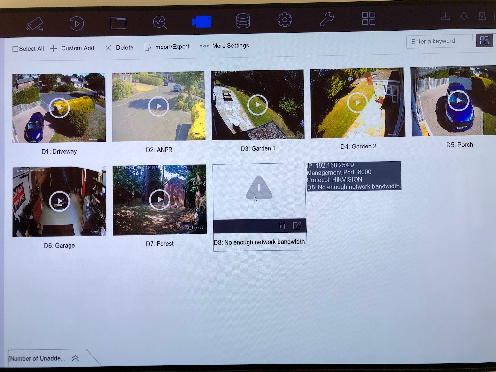

Upgraded to V4.40.015 build200616 firmware last week and all went without any hitches and has been working fine.

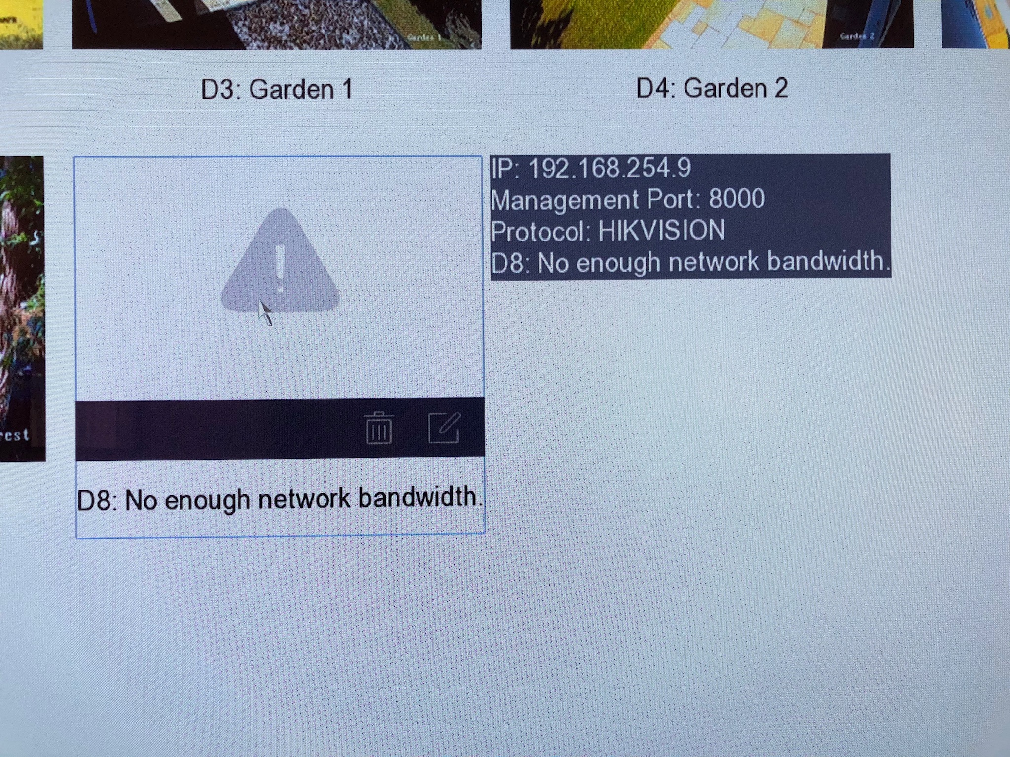

Yesterday I decided to do a manual restart via the NVR GUI and now I’m getting “Not Enough Network Bandwidth“ error message and lost one of my IP cameras :(
if I restart again the fault moves to another IP camera and I lose connection to the IP camera via local and remote viewing..
very odd considering my setup has been working fine for the past year...
can I roll back to a previous version ?
I had the same - i just plugged in 1 at a time, and reduced the quality. Once you have them all online, push up the quality again until you find the breaking point, I did this. My issue is badly terminated cabling.
Thanks for the tip but we should not have to do this for incremental updates... I rolled it back to the previous version in the end and lost all my account settings and had to reconfigure from a fresh install.
I thought Hikvision had sorted out the firmware updates, in future I'll let someone else take the risk and stay with V4.22.005 build 191208

Having the same issues here after the first time of ever updating the FW.
How do you roll back the FW?
Backup current settings - do the upgrade with a lower version firmware.
