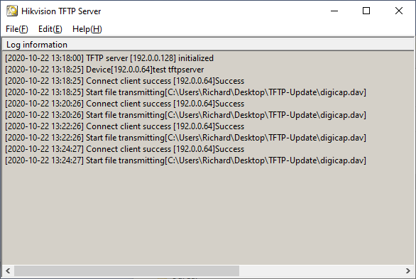

I appear to be stuck with this broken firmware now, as I can neither upgrade to NVR_K51_BL_ML_STD_V4.40.016_200803 nor downgrade (I've tried NVR_K51_BL_ML_STD_V4.22.005_200327).
Via the (otherwise working) web interface I get to about 33% and then get "Upgrading failed" every time, and trying the TFTP method the NVR just seems to get stuck in a reboot loop:
If I then shut down the TFTP server and power-cycle the NVR, it eventually comes back up unchanged - stuck on this crappy firmware but unable to ever get off it.
I had read that the Hikvision TFTP server cannot handle large firmware files so that might be your issue. You can't use a different TFTP server either as this is customised. So an option might be to downgrade to a much earlier version (ie smaller file) and then upgrade vis the Web interface to the version you want.
You mean like a really old V3 firmware? How small does it need to be?
Also, if I did go back to say V3.3.4 (NVR_Hi3536_BL_EN_STD_V3.3.4_150715.zip - 23.52MB), would I be able to upgrade directly back to a recent V4 firmware using the web interface, or would I need to go via an intermediate firmware?
I believe the Hikvision TFTP server requires the firmware to be under 30 MB, so likely yes you have to go back to a very early version via this mechanism (which will reset the NVR to default), and you can then upgrade again once you gain access.
Ok, well, yes, Using the newest version I could find under 30 MB did indeed work via the TFTP tool, so now I have NVR_Hi3536_BL_EN_STD_V3.3.9_151228 on there. The problem...
...now not a single firmware will upload via the web interface!
Is it possible to update via USB?!
UPDATE!!!: I've managed to upgrade to the latest firmware (4.40.016) using the Hikvision Batch Configuration tool! I'd forgotten this tool exists, and the most recent version is way more functional than I remember. It upgraded the firmware without batting an eyelid.
