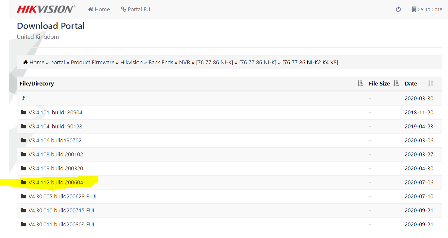

@Dan I have a DS-7616NI-K2 currently on V3.4.112 build 200604. The UK Portal has the latest version for this series as V4.30.011 build200803 EUI.
Do you reckon it is okay to directly upgrade to this version? Or should I do all the subsequent upgrades to get to the latest one - see below...
Hi @JT_Singh
To be safe, we would recommend upgrading to the first V4 firmware (V4.30.005) and then upgrade from there to the latest v4.30.011 as we have seen some issues when moving from V3 firmware to latest V4 firmware.

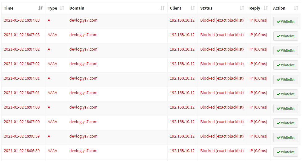

Has anyone else noticed their NVR trying to interact with devlog.ys7.com the those time? What's this about? I've blocked these queries on my Pi-hole for now.
