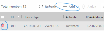

Select the doorbell checkbox and hit the add button:

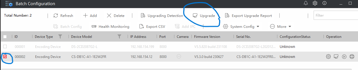

Enter username and password and the doorbell should show up as connected on the list at the top... then select the doorbell there and hit the upgrade button:

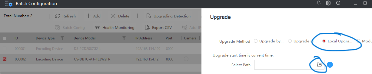

Then select local upgrade and chose the .dav firmware file you want to load...
