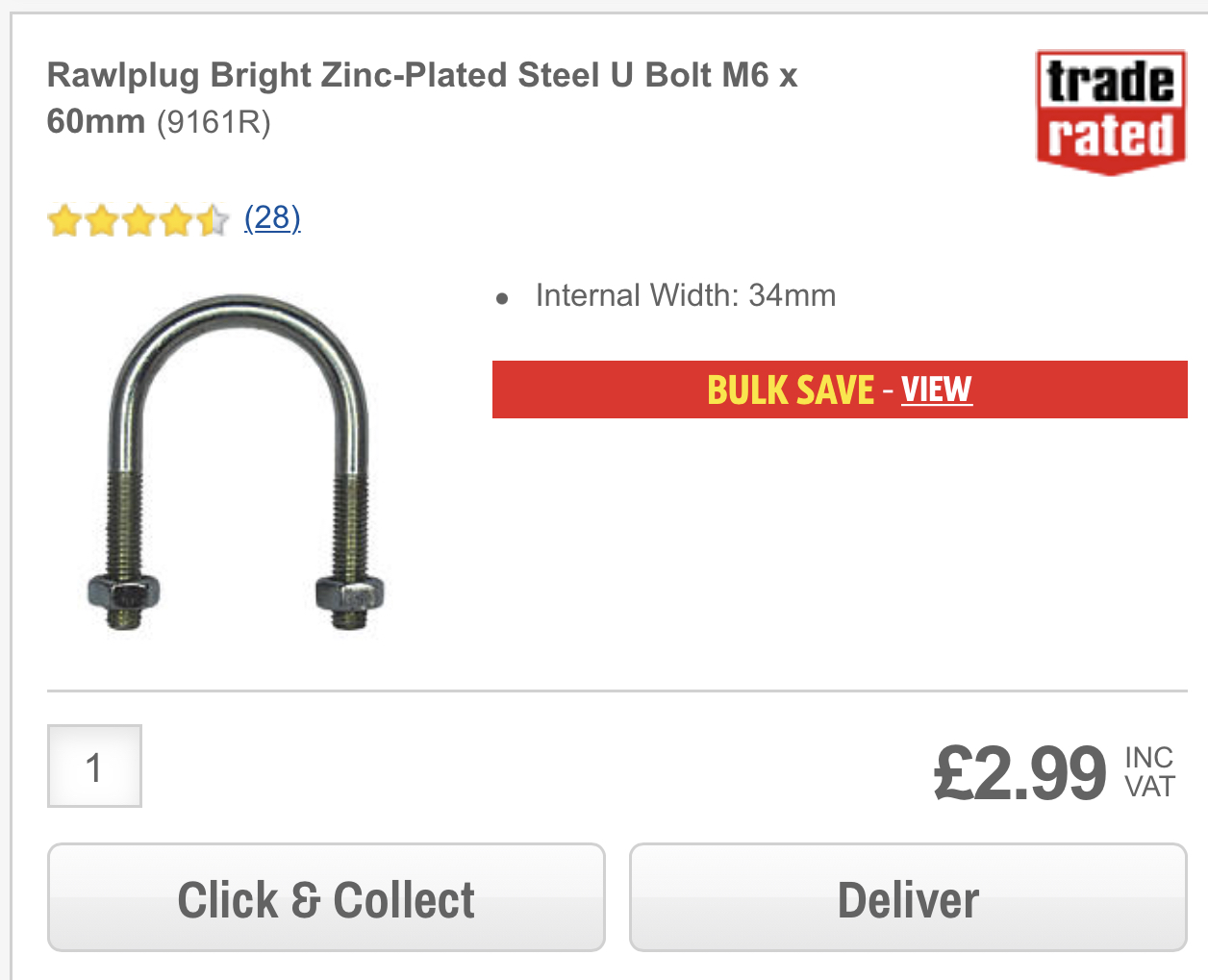

Ive found one matching closer to my internal width size but not sure about the length - 60mm? Will that not be too long if it’s coming through the junction box?
You'd have to have a look of them. You could chop them down a bit with a junior hacksaw. Just wind them nuts all the way on, chop a bit off the length to suit, then wind the nuts back off to clean the threads - easy enough.

I used a u-bolt. Drilled thru mounting box to accept legs from u-bolt, then cut them back a little to just a little more than size of nut. I sealed all holes at rear of box. Pole I have is 40mm dia. I found the HIK pole mount too cumbersome/heavy for my use. I have 2146 HIK mounted this way protruding from conifers. Pole is mounted to wall with 2 heavy duty brackets and approx 1.5m of pole above the 2m wall.

I’ve actually bought the U clamps and the Saddle Distance brackets so will see which is the best option for me when the installer comes and fits the camera next month.

Just an update - I've had my remaining colorvu cameras installed yesterday and ended up using the saddle clamps to mount the camera on the 25mm pole/pipe which worked really good and was secured.
