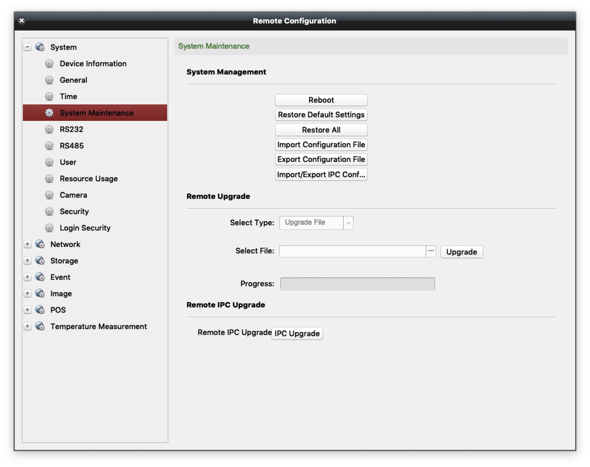

There is no plug-in for newer versions of MacOS, all of the browsers that Mac supports have now removed support for the plug-in that Hikvision cameras had previously used and so you will need to install iVMS-4200, add the NVR to the software under device management, select the device from the added list, click remote configuration, and then go to the menu shown below to update the firmware of the directly connected cameras without the plug-in.
Once the cameras are updated they should support the same plug-in free solution as the NVR and you should be able to access them with any modern browser (Chrome, Firefox, etc...).

Took me a few attempts to find the correct tab to access the individual cameras rather than the NVR but all good. The dome took a while to update but confirmed successful on its config page. As there are multiple updates for the IZS I’ve chickened out so am updating it chronologically which is slow going. Thanks for the help Dan, much appreciated.
