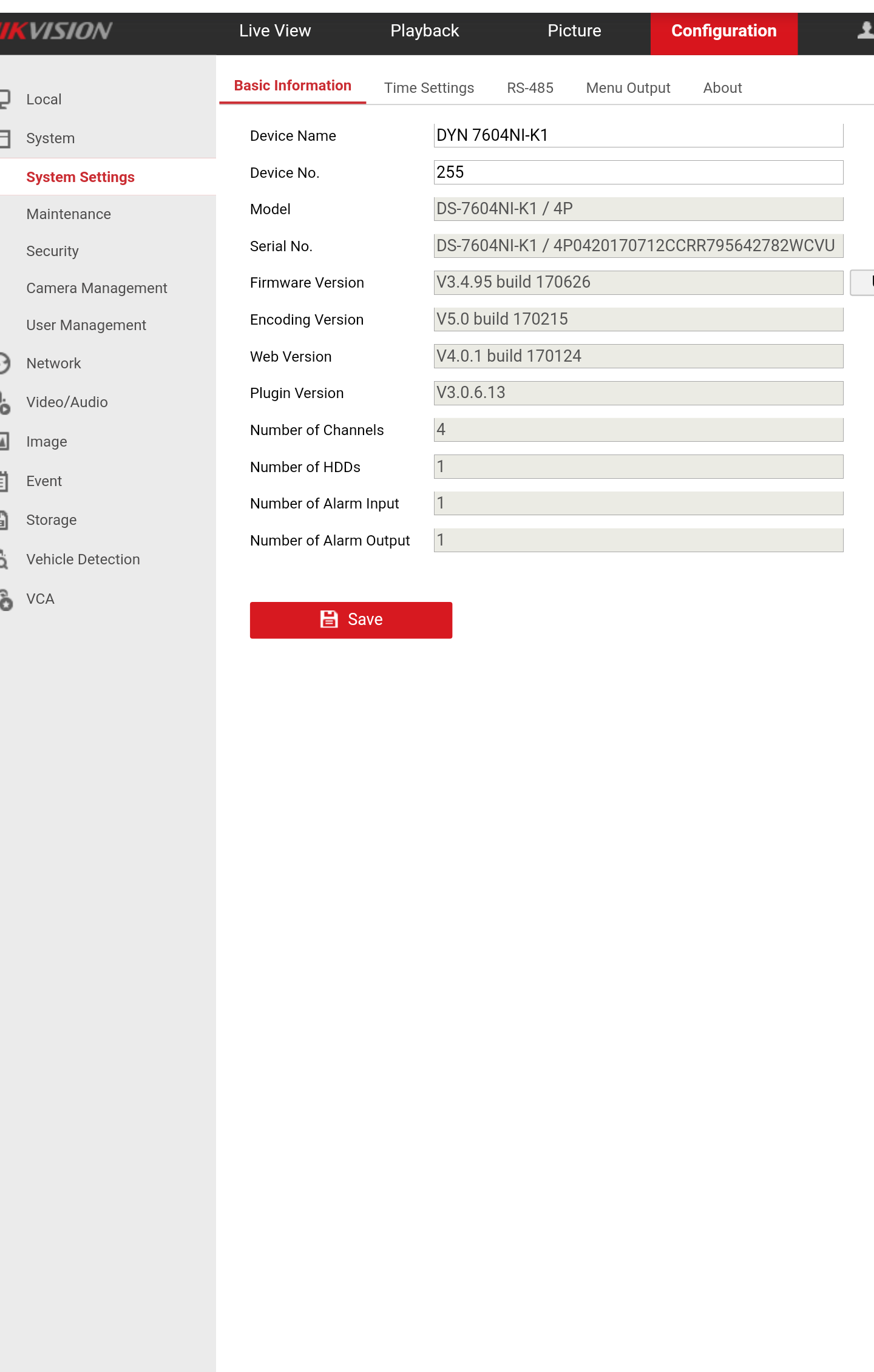

I don't think you have logged-in to Config on your camera.
That firmware version is too low to be the firmware release of a G1-series camera e.g. your 2555.
If you look at the Model field, third on the list, what does that show please?
Hey Phil, I've attached the screenshot of the setting. I hope this helps.
I am logging in 192.168.1.xxx
you could be correct. How do I login to the actual camera ?

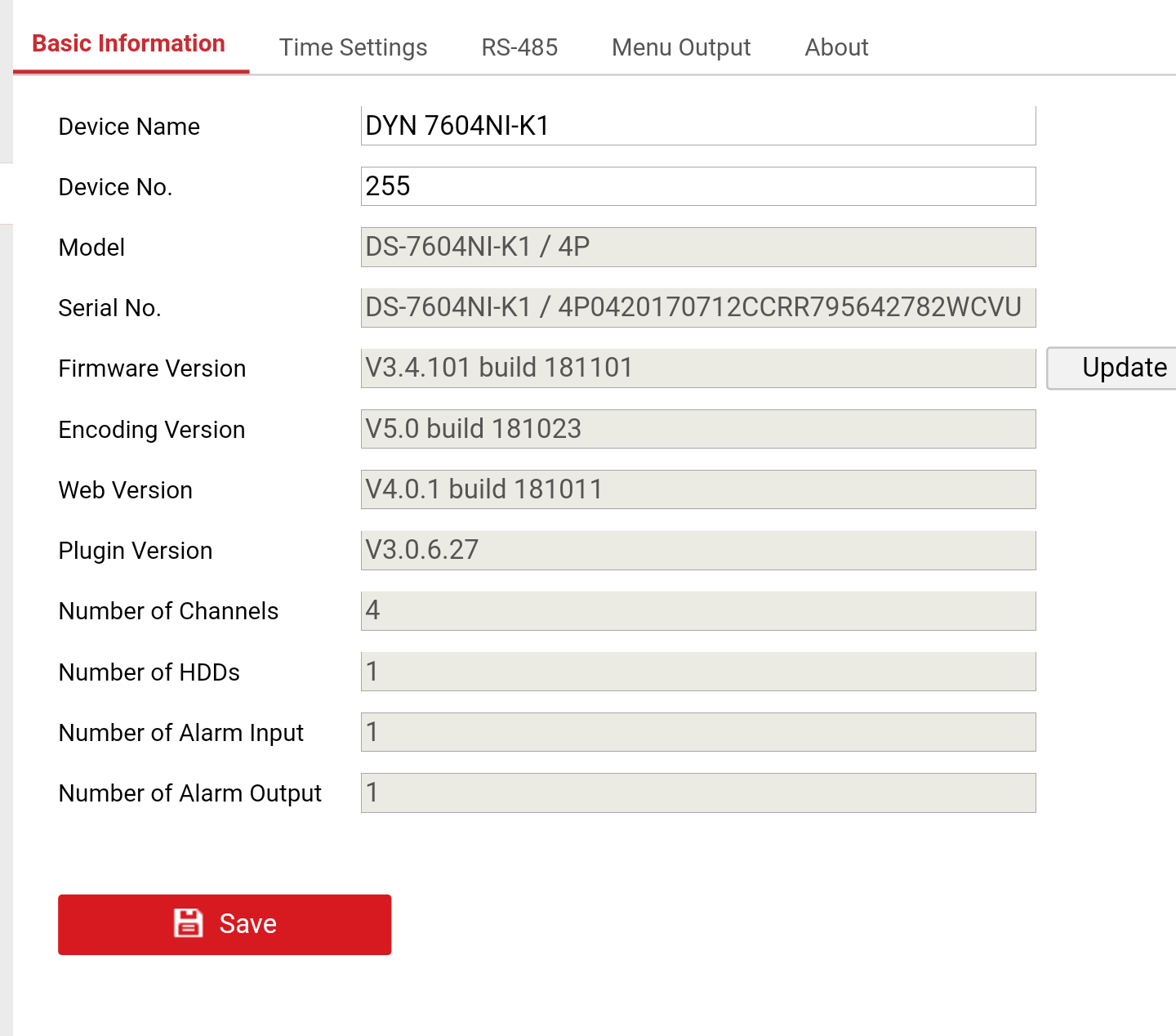

Hey
Thanks for the information.
I seem to have updated the firmware for the NVR, the live view also works too and when I play it in normal stream the sound too works.

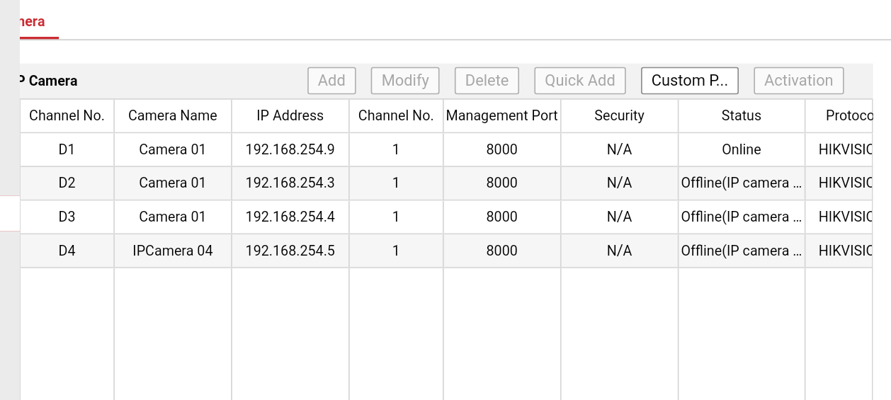

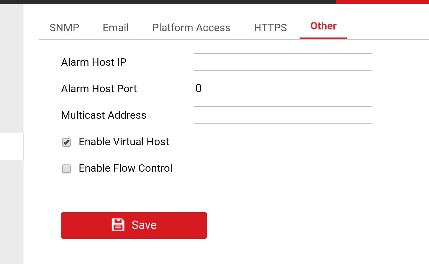

However when I enable the host I m unable to get the blue link on the camera management...
