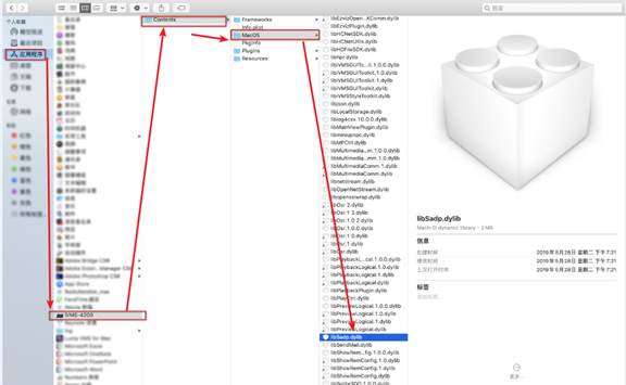

I have the fix for iVMS-4200 on MacOS Catalina :)
Unzip this file and replace the one in the apps bundle.
iVMS-4200 now works for me on MacOS 10.15.2

Sorry, I should have said. I was sent it by Hikvision. If you click `Get Help` on this support page Support then say `iVMS-4200 doesn't work on Mac Catalina` it tells you to email them and they'll send you the file to fix it.

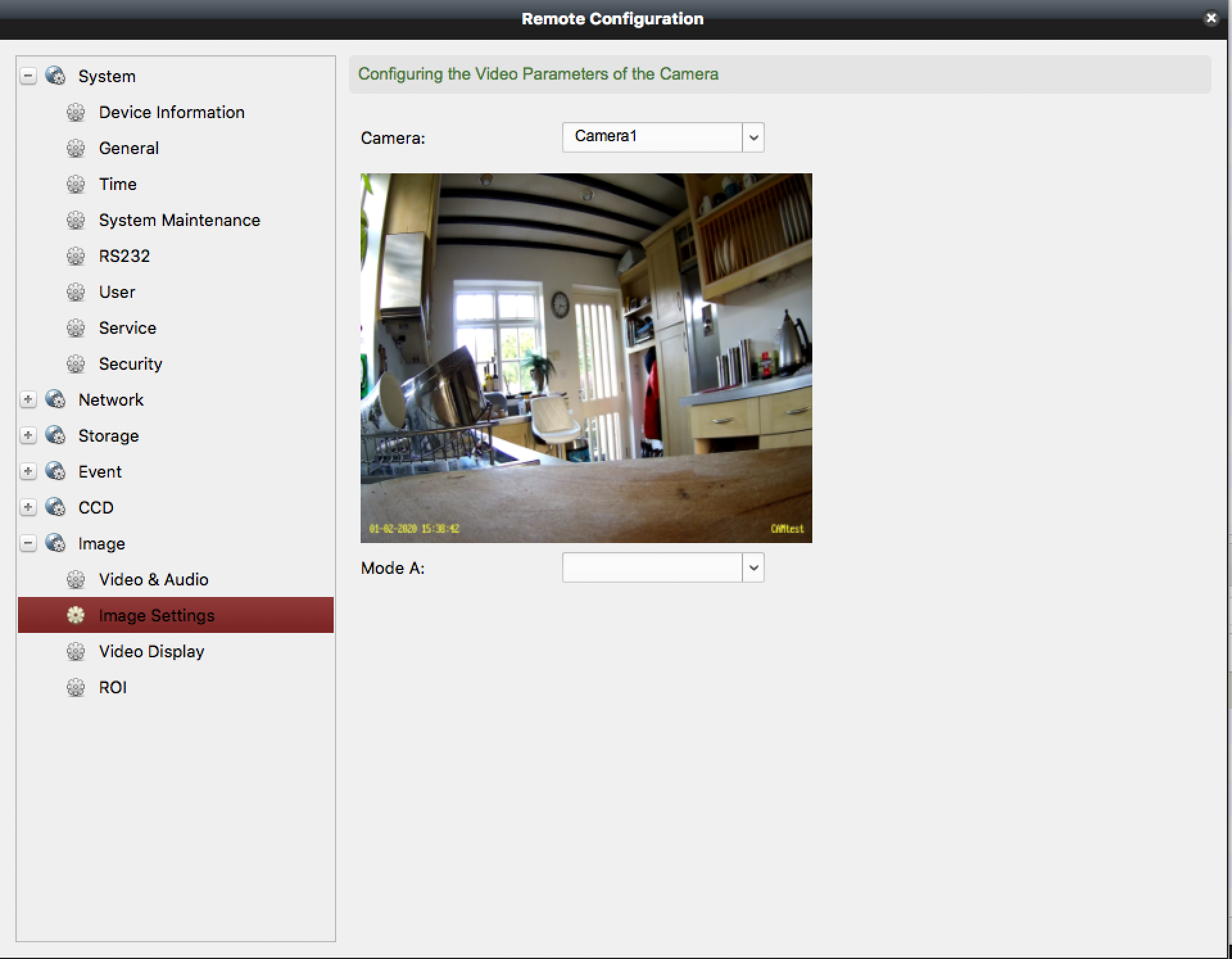

2.0.0.11 feels like a more solid performer, albeit slower to launch and quit for me and a tad slower to jump between config panels. It did take several attempts to get it to display Live View from a bench-test camera but it did find it eventually. I'm seeing mini Live View displays in all the right config screens; but for reasons unknown, I'm not being offered any settings to configure in the Image Settings window. Where'd they go? I can get them via my browser but it's a bore to have to switch - and of course my browser has the opposite problem in that it shows my Image Settings but not the live feed so I have to adjust brightness, WB etc in the dark.

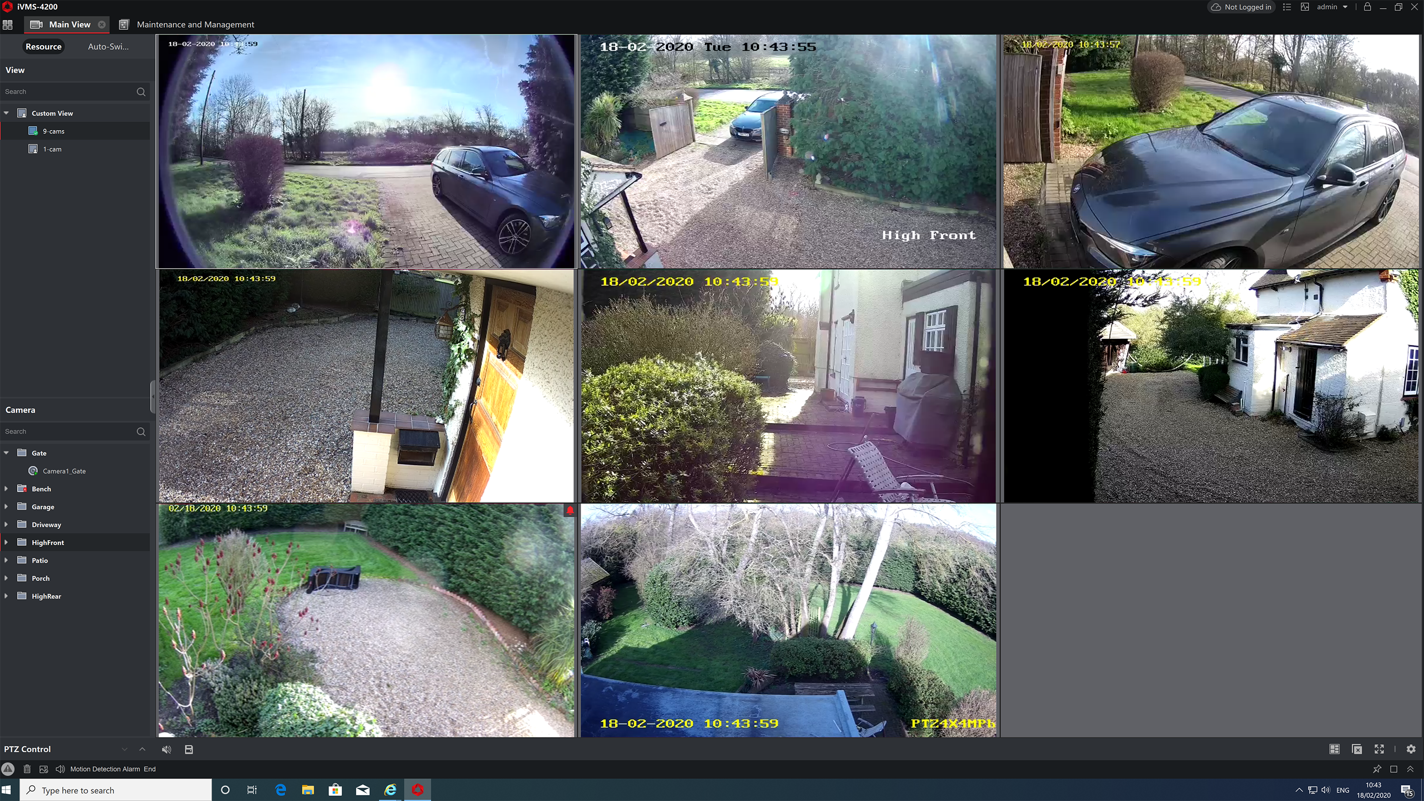

FWIW, the shortcomings of iVMS on MacOs led me to install Parallels so that I could run the Windows version of iVMS and especially Windows Explorer (not the pre-installed Edge browser) which does load web configs properly once the prompted web plugin has been downloaded. Switching to Parallels is as fast as switching to any other open Mac app so it's a pretty good workaround even if iVMS runs a bit slowly in Parallels. It's certainly usable for as long as you need to access the web configs and you can then switch instantly back to MacOS for day-to-day running - in iVMS or the much-faster and much-more-stable Security Spy (expensive for any number of cameras but really well-written exclusively for MacOs). For fun, here's a screenshot of my newly installed cameras from iVMS running under Parallels:
