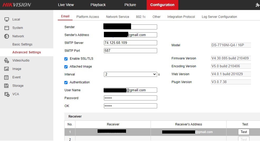

Yes gw, mask, dns all correct.
I had it working with the ip address manually entered and App password - smtp.gmail.com did not work with App password.
It was working for a day then stopped again last night.
Others on the ipcamtalk site also report it stopped working again last night.
I emailed Hikvision about the issue and they only offered the static ip/app password saying they will not be updating the firmware as the DVR is too old. Mine is 2 years old and plenty of sites are still selling this same model today.
I jumped to Hikvision from AVTech DVRs as I hoped the support would be better but to be honest the products might well perform better but the support is just as bad. Their attitude to only support whatever is in current production is diabolical. Imagine if Dell only released updates this way and each year a new model server, pc or printer comes out they drop support for last years model ?
"I had it working with the ip address manually entered and App password - smtp.gmail.com did not work with App password." --- same here and now mine is OK, Thanks...
